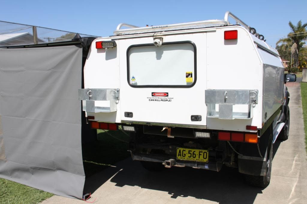

    A couple of serious gerry can holders, $50 each from EBay. Can not fit my spare tyres without a lot of reinforcing = work so non drinking water can go there on the extended trips.
    Taslucas' sticker looks the good there as well.

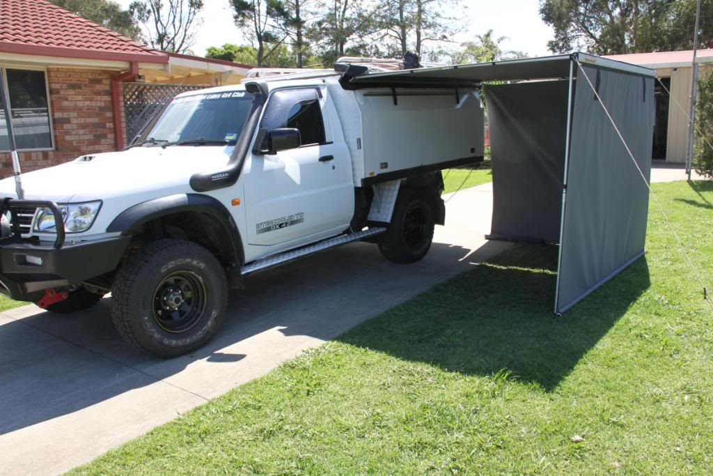

    New SupaPeg awning I'm real happy with. Well made right here in Australia by Australians who know what I'm going to do with it. It has real canvas and is easy as to use, came with side wall that is clever in the design.
    Allready had a 2x2mtr canvas tarp for a ground sheet if ever I have to get under the truck for repairs etc and it fits as the end wall.

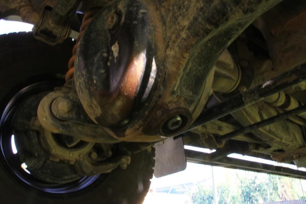

    Took the swing arms off to have some caster correction bushes fitted, when I took the drivers side off I thought the chasis nut came off easy or more accurately quickly.
    Had the bushes fitted and put it back togeather doing the passenger side 1st. When it was tightened up the thread on the chassis end came through the nut 15-20mm.
    Did the drivers side and when the nut was tight the thread was flush and the new rubber bushes were not compressed like the other side.
    It was a cow of a job to get back off as the thread had spalled as you can see, what a pita.
    I am taking the arm into Nissan in the morning to get the end replaced, I hope its not going to be a hassle.
    A mate said ages ago my 4B looked like it was crabbing, this would do that.
    The mechanic who had the arms out before is now off my "touch my truck" approved list!!!!
