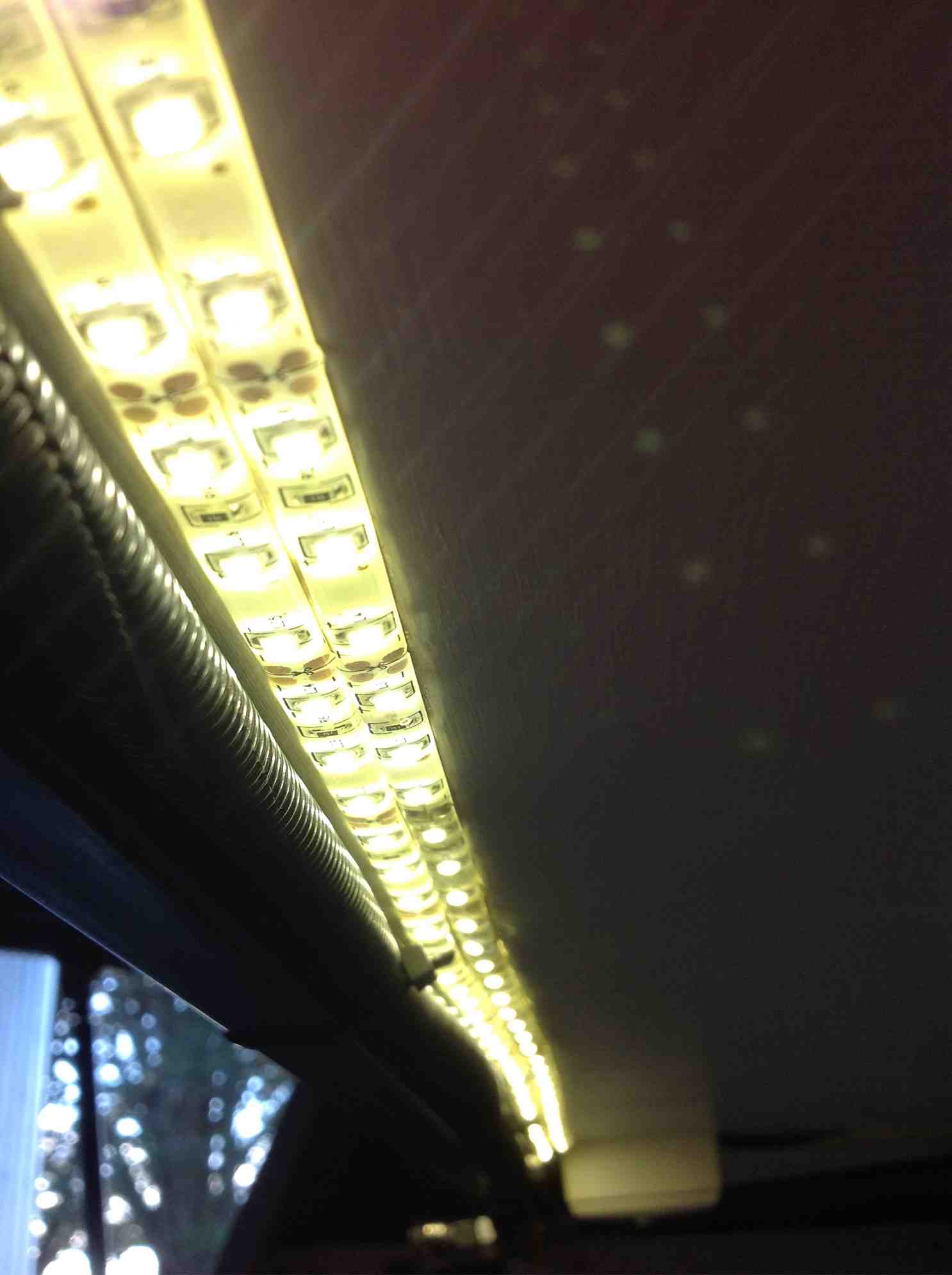

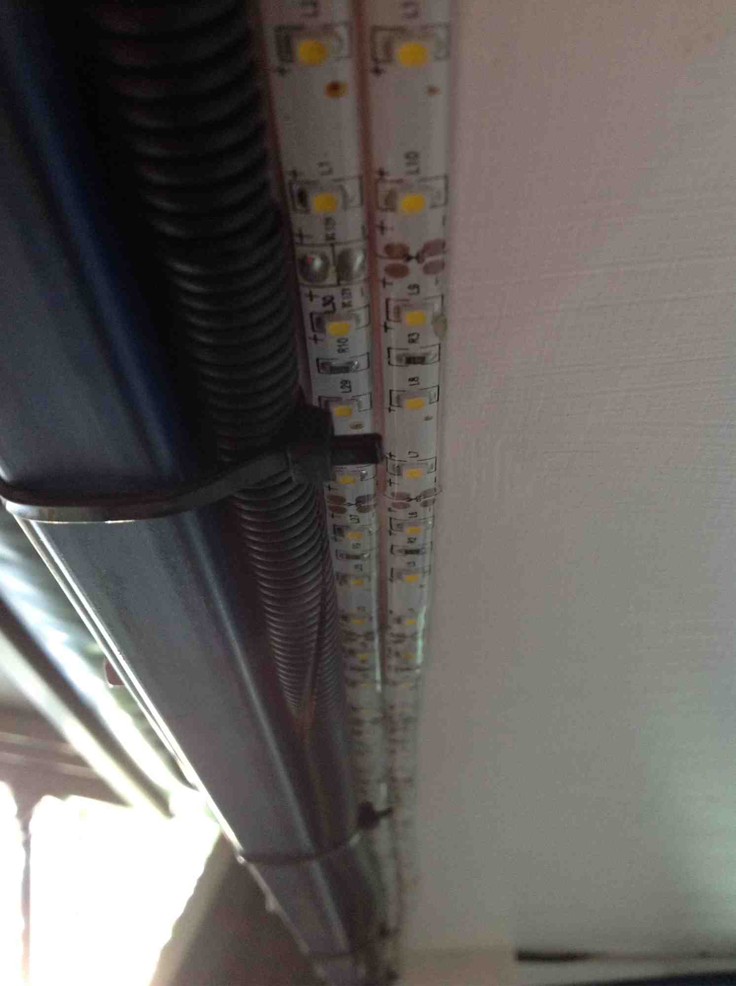

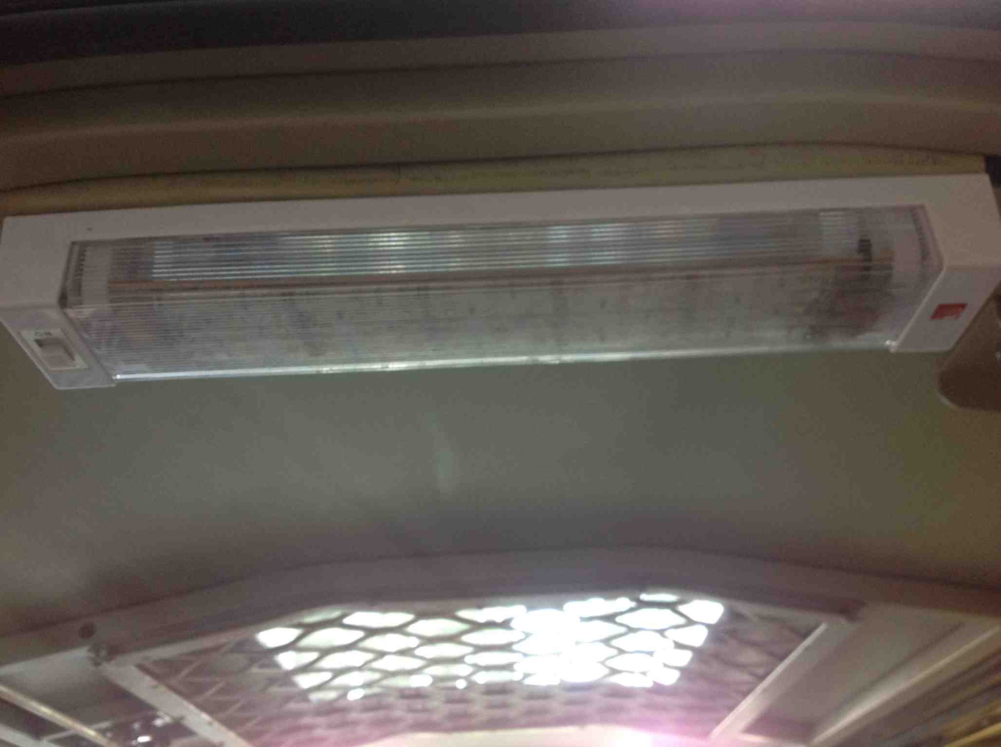

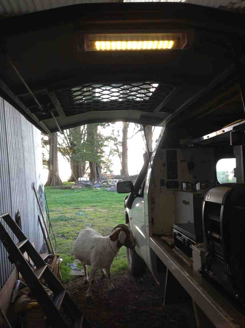

    I gave that idea some thought, but decided against it. My experience with LEDs is that they have a high 'dazzle factor' & are best mounted out of the line of sight or behind a diffuser if possible. Today I got the soldering iron out & cut the LEDs into shorter strips, soldering them back together in parallel strips which I stuck to a piece of 3 mm ply to replace the twin fluoro tubes in one of the ex Telstra light fittings. I re-located this to the rear of the passenger side canopy door, over where the sink will be (clip on).

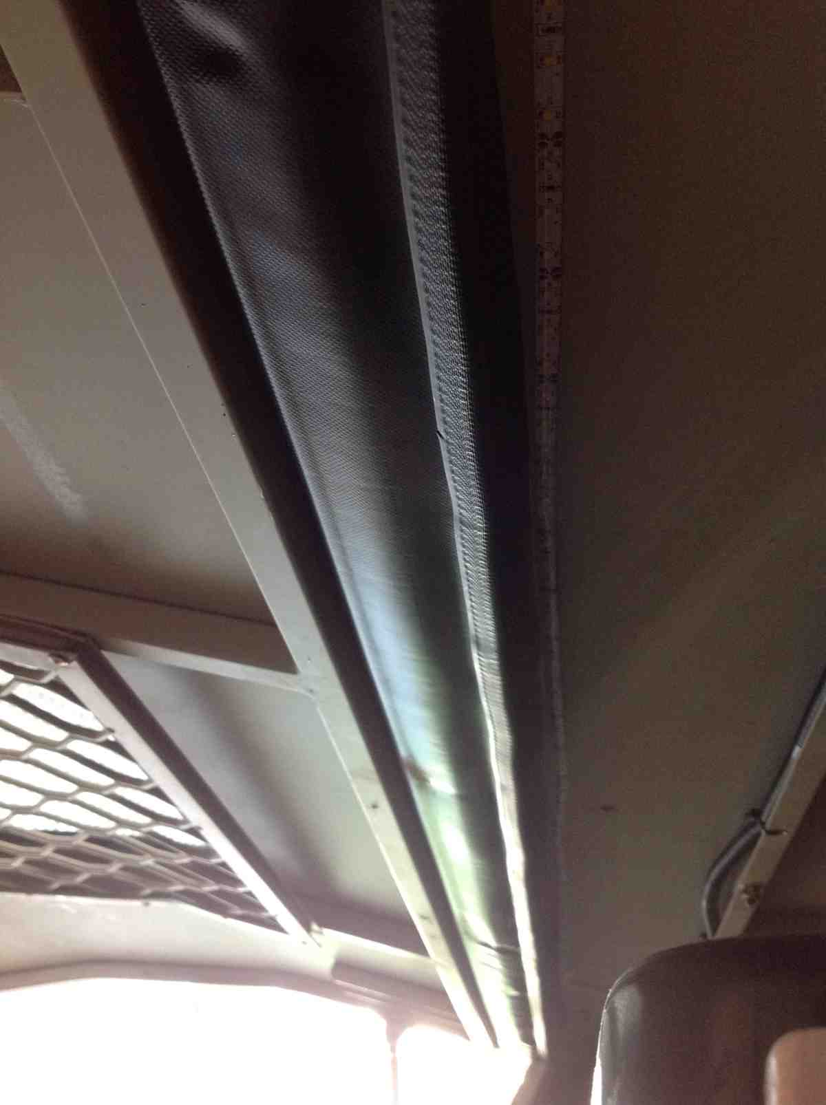

    I stuck a couple of 700mm strips onto the false ceiling over where the cooker will be, & another almost 2 metres long higher on the roof, both hidden from view by framework. I checked them out tonight once dark & am pleased with their effectiveness. I used 'warm white' rather than the brighter 'cool white' so they should not make my steaks look too 'washed out & insipid'.

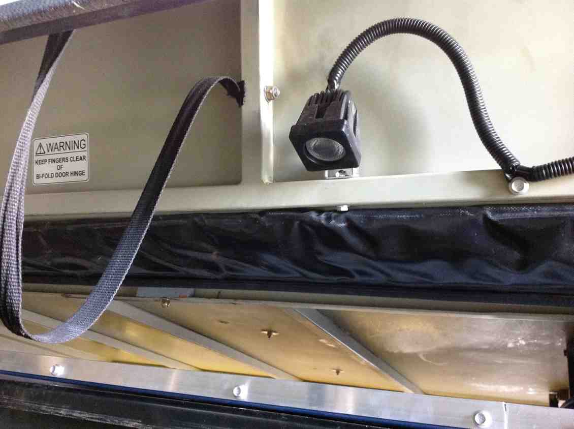

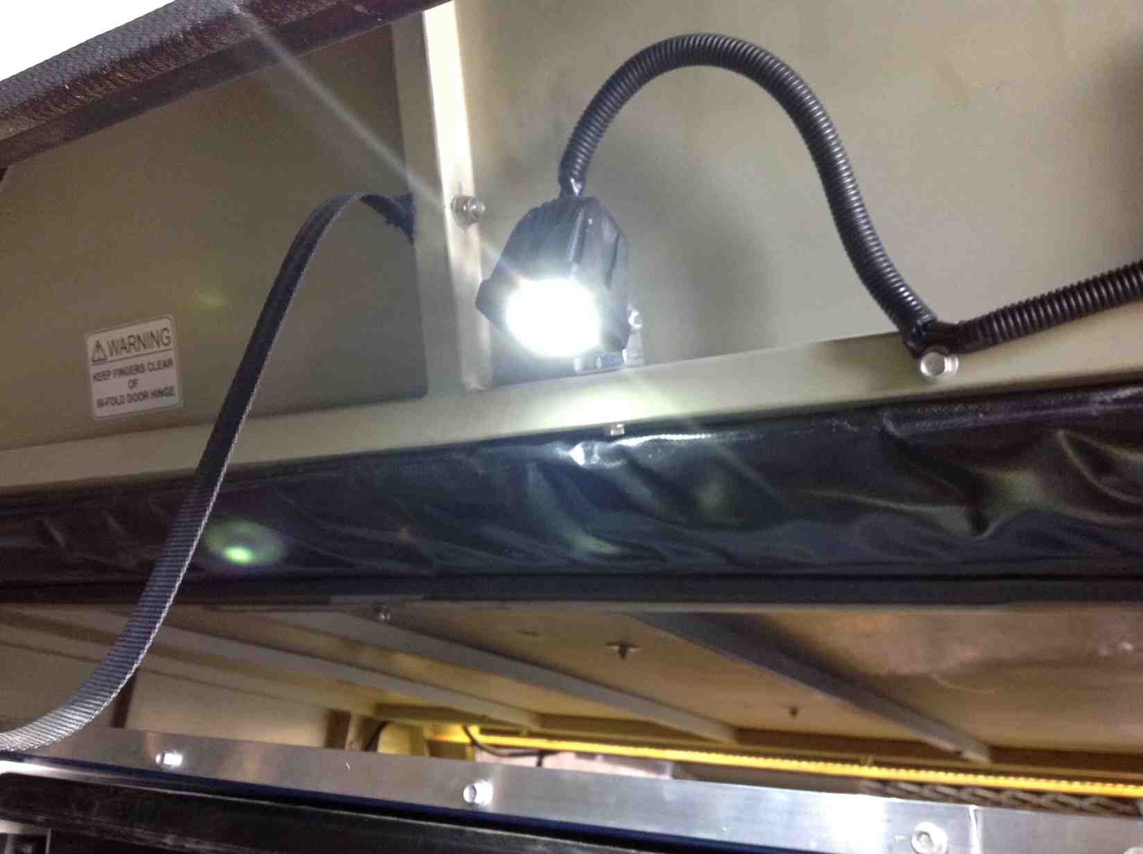

    On the other side of the canopy I removed the fluoro light & fitted a 10w Cree led wide angle spotlight, this is really bright & makes a great work light. The 4 area lights can all be switched on independent lay of each other (using normal household light switches - ok for such low currents). With all lights switched on the current draw totals a little over 2 amps.

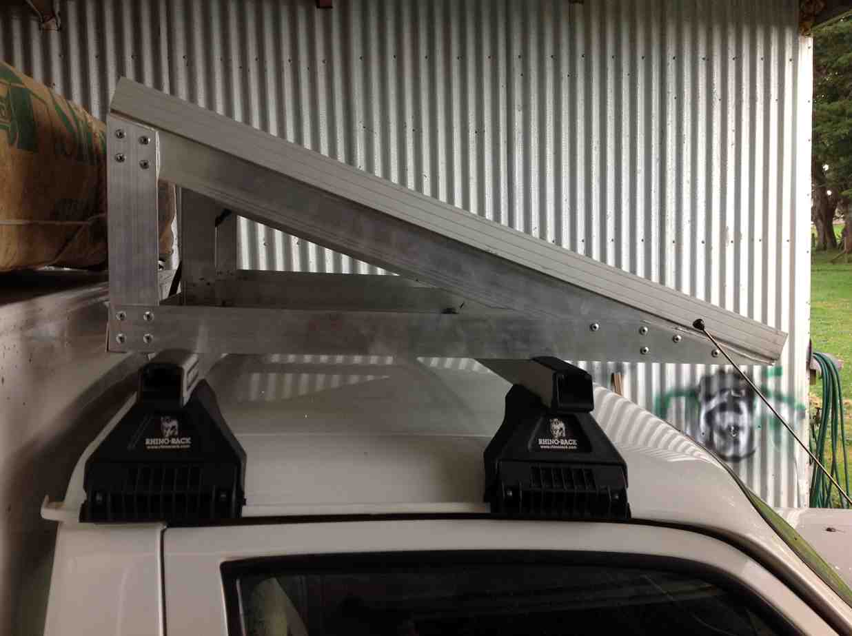

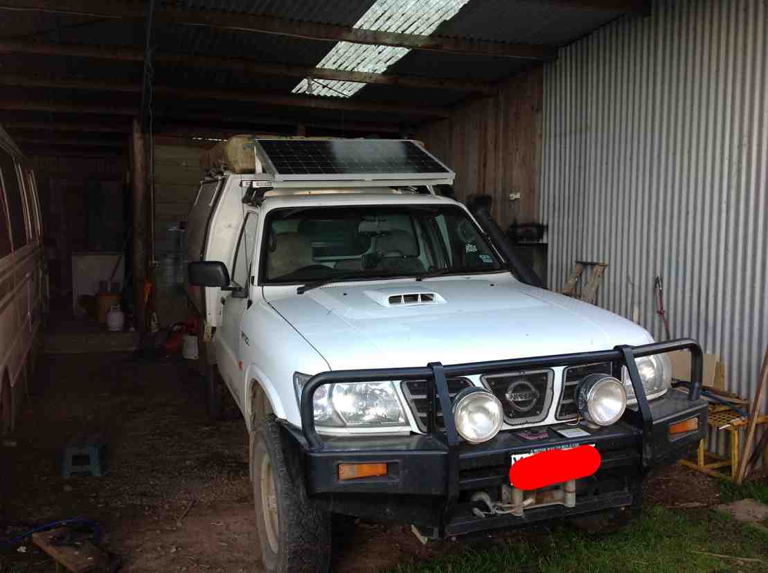

    125w solar panel is now fitted onto the cab roof. I made a framework for it out of aluminium angle (50mm x 50mm x 3mm.) Rivetted & Sikaflexed together. The panel is Rivetted to the frame, which in turn is bolted to a pair of Rhino roof bars. I had intended to attach to the lower side of the roof bars to keep the gap between the front of the panel (it's on an angle like a spoiler) & the cab roof as small as I could, but unfortunately the width of the panel was about 15mm wider than the distance between the roof bar supports, so I had to sit the frame on top of the bars. If it is too noisy I may have to consider some way of blocking the gap.

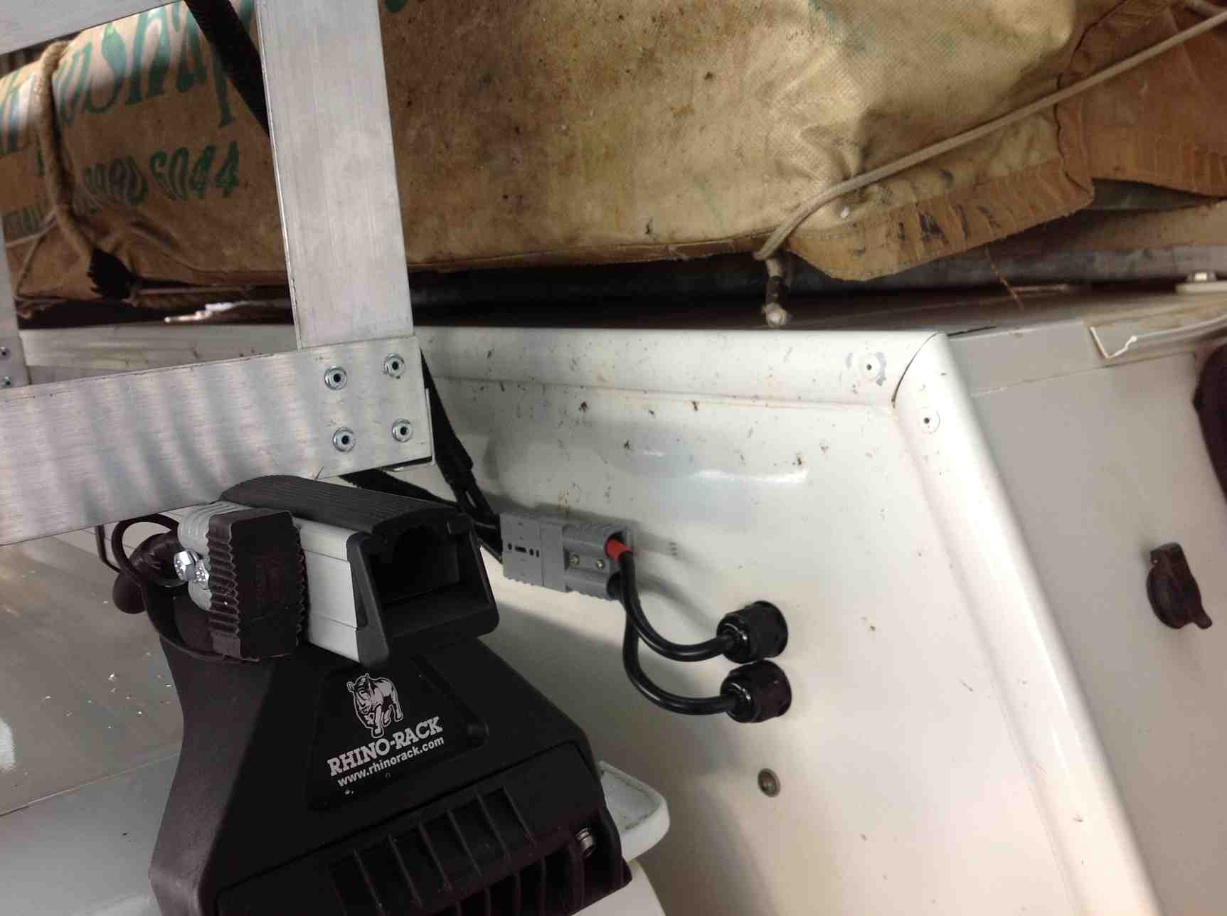

    Today I cut the connections off the panel & fitted an Anderson plug, together with extra cables from it's rear going to another Anderson plug. One connects to one I had previously fitted to the front of the canopy (going to the Redarc regulator) & the other mounted onto the frame, into which I will connect the portable panels.
    The redarc regulator (BCDC1240) charges the house batteries from either solar or from the alternator (dc to dc), not both at the same time. The way I wired it up using a changeover relay it should charge from solar whenever the sun shines, unless I start the motor, in which case 3 stage smart charging automatically kicks in about 30 seconds after the motor starts. Having connected up the roof panel today it was the first time to see if I had managed to wire things correctly. Result, when I saw the remote redarc led indicator light up, & a few solar amps charge showing on the battery monitor, was a big grin. :-). Fired up the motor & watched it switch over. Grin got bigger.
