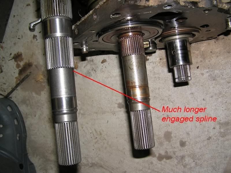

    The early GUs (pre 2004) had a problem with 5th gear. Later they lengthened the spline on the shaft and widened the gear
    here is a new spline next to the old:
    I haven't been through this personally as mine's an auto but there are aftermarket solutions for strengthening 5th gear (ie: spline/gear replacement)
    If the solutions that have been listed above don't sort the problem it might be worth looking after revising the gearbox, not very cheap I imagine

    Nomad.....I thought the GU 2.8's ran a different box to the 4.5's and the 4.2's in that year.

    my bad. After some reading it appears that yes, the 2.8 had a lighter gearbox, related to the box used in Skylines.
    In that case I guess it doesn't suffer from the other's manufacturing issue. The noise could just be lack of oil in the transmission?
