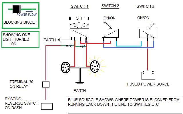

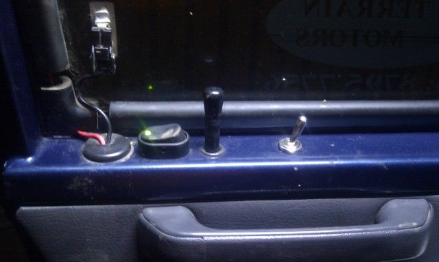

    This is what I did and have found it to be usefull on a few occasions .
    I can turn lights on from the back door then turn them off from switch on dash and vice versa.
    I can also choose to have one or two lights on or no lights ( good for back at camp when two lights are to much )
    They are also hooked to reverse lights which is on its own on/off switch too.
    Link to Post on here http://www.nissanpatrol.com.au/forum...31-Duel-switch
    This pic is for duel swithes only.
    This pic incorporates a switch for 1 or 2 or no lights

    Actually the battery feed should go to switch 2 not 3.
    Switch 3 is on small rear door.
