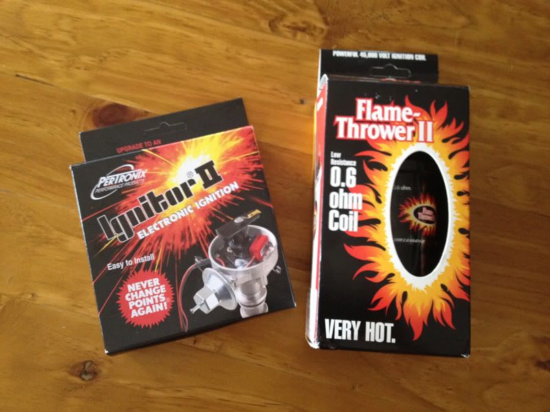

    Well the Ignitor II and Flamethrower II coil turned up this week so I thought I'd wack it in today.

    Even though I had just bought a new coil, it was just a stocker from Repco so I thought I'd retire it to a spare and give this flash new Flamethrower II Coil a go. 0.6 Ohm Resistance, sounds decent.. Man this thing weighs twice as much as the stock coil! I bypassed the resistor by just running both leads to one side of the resistor (the instructions say to splice the two wires together, but I want a quick and easy solution to rewire for points if needed so I went this way.
