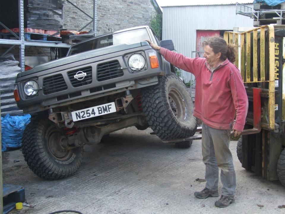

    Also binned the front ARB stuff too. Took it for a spin to settle things in and then stuck the fork lift under the old girl to see how high it would go
    About this high at the front before the wheels come off the ground
    Did the same at the back and got about 31" under the tyre

    Great flex from a 2" lift!!
