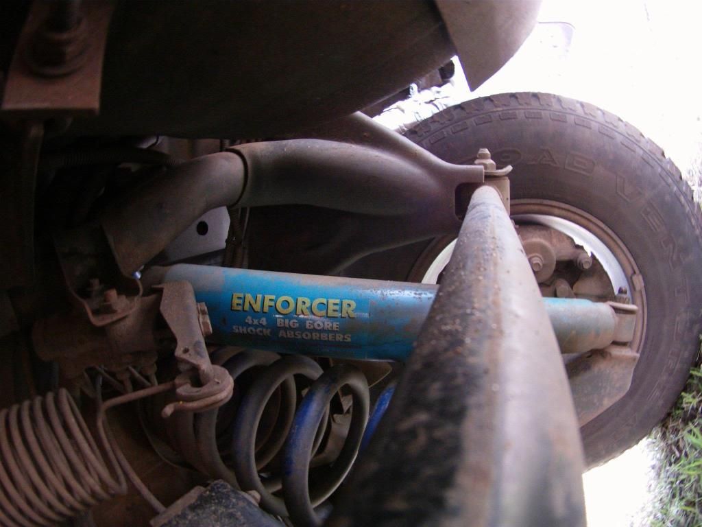

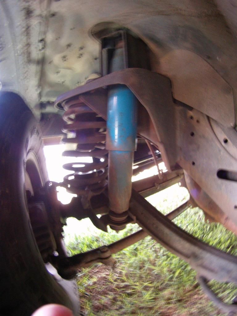

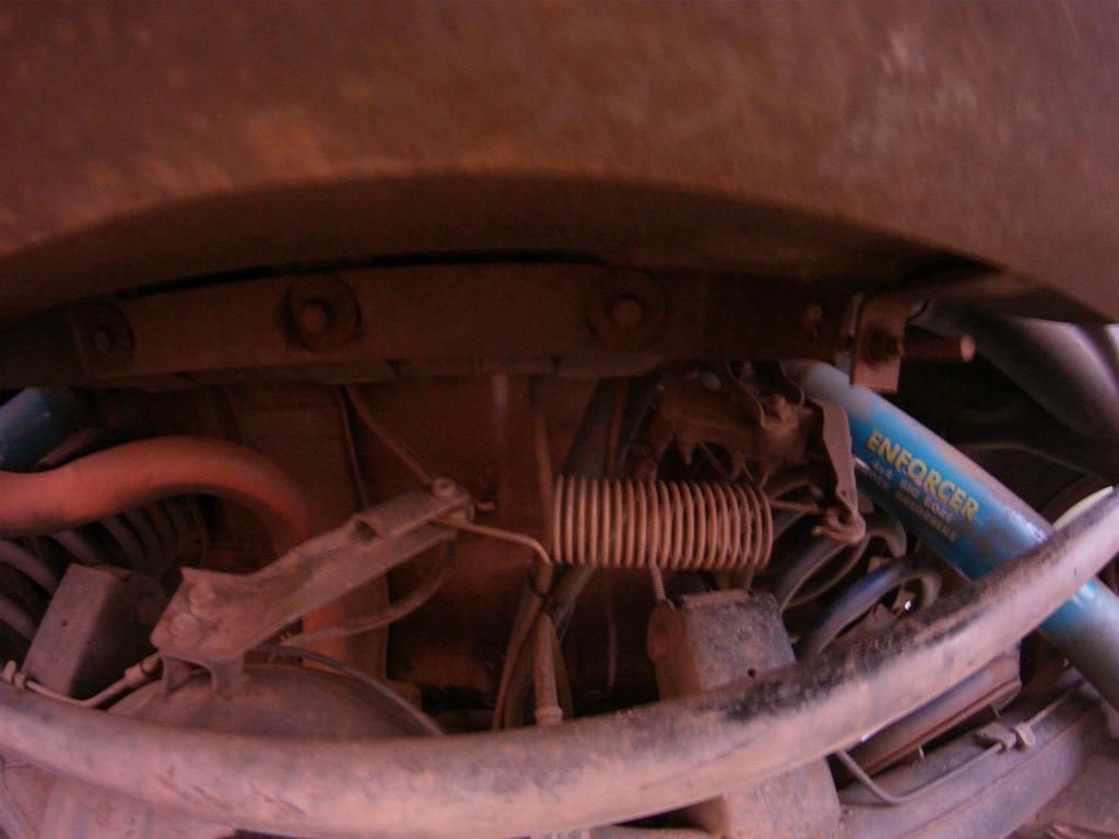

    [IMG][/IMG]
    [IMG][/IMG]
    what's that spring do that's attached to the diff and some sort of hydraulic leaver thing?????
    [IMG][/IMG]

    Quote Originally Posted by janek8me View Post
    [IMG][/IMG]
    [IMG][/IMG]
    [IMG][/IMG]
    I think that's the brake proportioning valve. Changes the amount of rear braking depending on the weight in the rear of the vehicle.....more weight = more breaking
