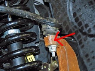

    -You actually should be hitting the part which the stud goes through, in your case you should hit the drag link & panhard rod. This pic isn't of a steering damper but should give you the idea:
    Hit where the arrow points to, you actually shock the stud loose rather than smashing it out like you've done.
    -Loosen the nuts off but dont remove them, that way the nut protects the thread.
    Do that with all similar studs, such as tie rod ends, ball joints, etc.

    Had time on the weekend to revisit the steering damper installation, I didn't do too much damage to the threads on the first attempt but gave up in disgust hence the request for information. I used your method this time and the shafts freed up easily. Thank you for your advice as my Old Man used to say "You learn something new every day" works a treat.
