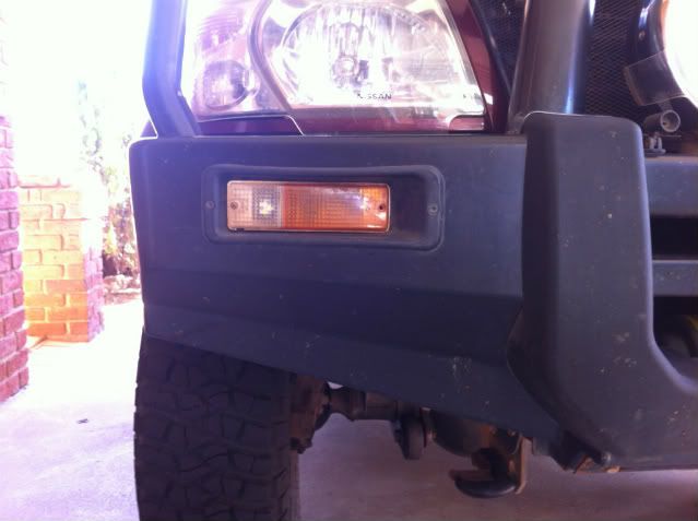

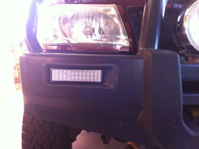

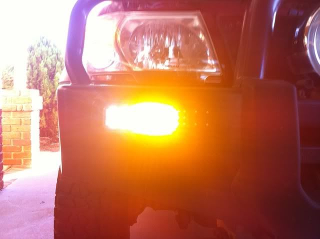

    Had enough of replacing globes in the bullbar combo lights, even the LED globes I bought started to play up with all the mud etc... getting into the hounsing. So i bit the bullet and replaced them with a set of LED park/indicator lamps from Russ@Tweaked Offroad. Model no. is 175AW.
    The standard Units.
    The new units.

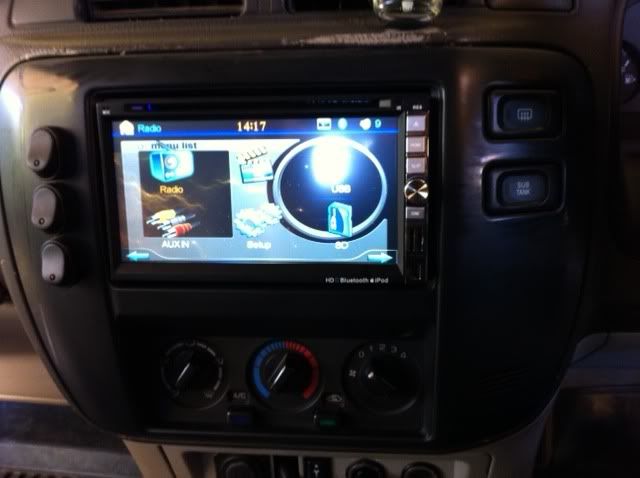

    New Head Unit from AutoTunez (Ebay). The clock has a mind of its own, but the rest seems to be functioning ok. Has all the usual stuff you'd expect GPS, Ipod connectivity, Bluetooth, DVD, reverse camera etc.., plus I've loaded up OziCE with a selection of maps. Was quite happy that it came with IGO8 Street Nav and not that gawd damn Route66.

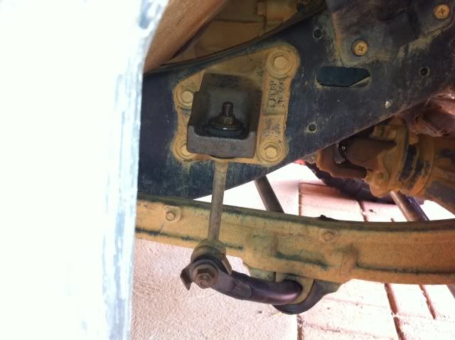

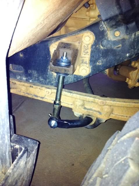

    The front swaybar links were a bit short, so I decided to get some greasable adjustable swaybar links.
    Originals
    New ones.

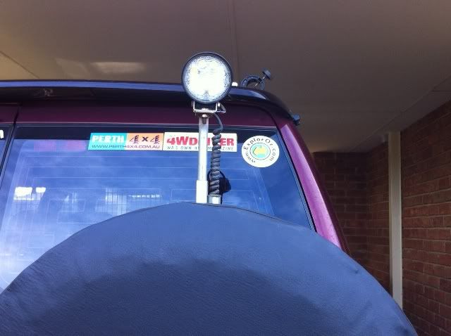

    Thumpa 21W LED worklamp to replace the 55w halogen Kaymar one.

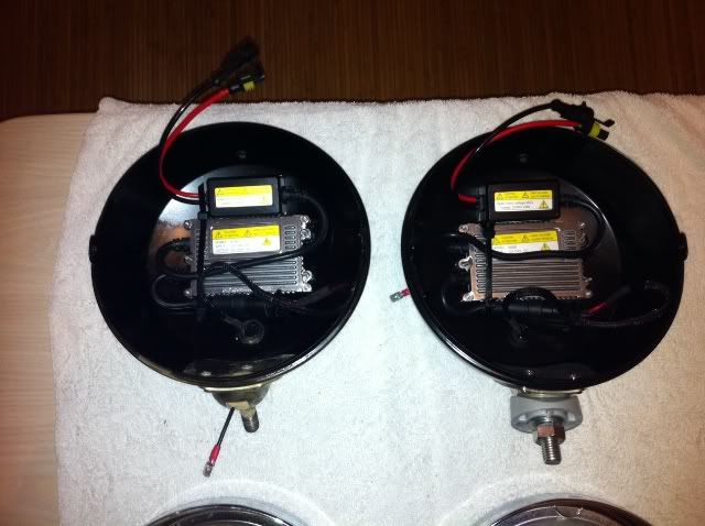

    Upgraded the 100W IPF Halogen driving lights with Thumpa 55W 4300K HID replacements. Fitted the ballasts inside the light housing.

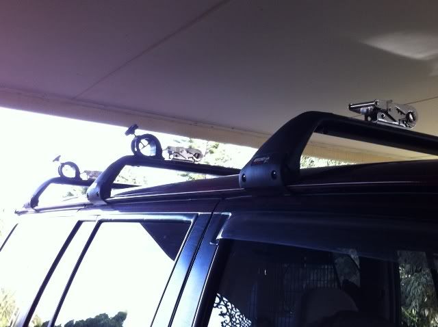

    The ROLA roof bars and tray were sold, as after our Kimberely trip I found that I was not really using it. So those have now taken up resdience on top of another WPC Patrol. I decided that 3 Rhino Sportz racks would do me nicely. These hold the awning, shovel holder and ratchet tiedowns etc...

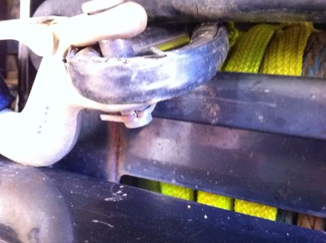

    A winch rope protector.

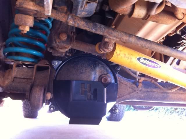

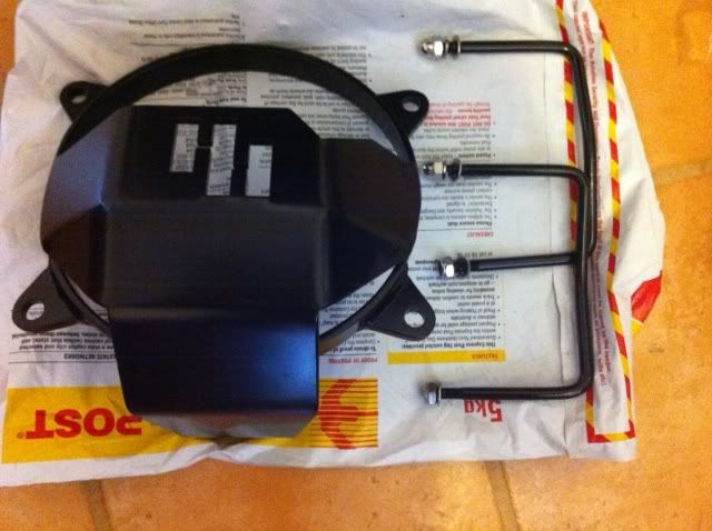

    I had been eyeing off these Harris Hardcase diff guards for a while and after seeing some of the punishment they'd taken on other peoples Patrols, I decided to grab one for Guzzle Guts. I did have one small issue though with the U-Bolt on the driver's side coming into contact with the brakeline. Robsons Brother's 4WD were kind enough to relocate the brakeline for me, so now the HH diff guard is now installed. Thanks Mal.

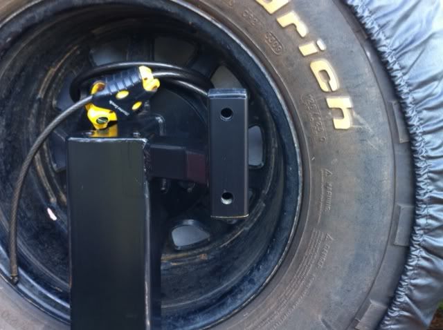

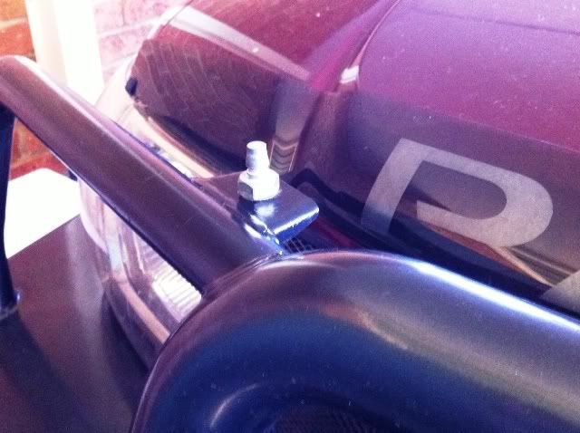

    I had Mike (XLR8) weld on a couple of extra bullbar tabs for me and he also fabbed up a hi-lift jack holder so that the hi-lift sits on the inside of one of the wheel carriers. Thanks Mike.
    Hi-lift jack holder (minus the jack)

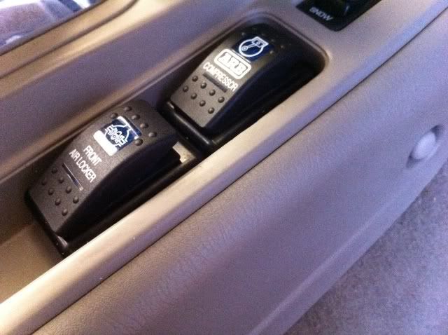

    The air locker and compressor switches were installed in the pen holder in the centre floor console, but I found that they kept popping out. The reason for this was that the wiring was hard up against the carpet underneath the console. Not good considering how hot the switches get.
    I found these in Clark rubber and used them to raise the switches up enough to get clearance for the wiring underneath.
    Cut out the centres so that the switches clicked in and with a bit of Rapid Fix, adhered them to the centre floor console.
