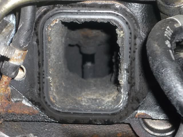

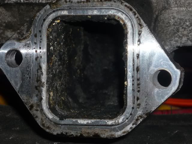

    It can only do your engine good to fit one. Especially for engines (ZD30 is one) that also have exhaust gas recirculation (EGR), the carbon from the recirculated exhaust gases combines with the PCV oil mist in the inlet manifold to form a sticky black tar like mess that builds up in the inlet manifold and intake ports. Blocking the EGR helps too.
    Photo's of the build up in my TD27T
    Tony

    Quote Originally Posted by YNOT View Post
    The sooner the better obviously but the problem has been there undetected for some time so a bit longer "shouldn't" hurt. I'll cover my arse here by saying that I can not guarantee it won't blow up tomorrow or next week, just that it's very unlikely.
    Tony
    PS, "as his friends just blew up and cost him a lot of money to re-build, it blew at 175000"........urban myth is it? (not you Steve, reference to a post a week or two back - Rod knows which post I mean.)
    Right on the money Tony, Myth indeed. Not just ZD30's ,I saw a pic on a 200 series, wow.
    I'll see if I can find it. lol
    Prado inlet manifold with open EGR lol, now you can understand why the EGR needs to be blocked, you can't see this from under the bonnet!!

    So thats what all that junk in the inlet manafold was when i looked in the hole where the valve goes, i thought the engine was stuffed........
    my 2.8 has 205 ks on it and iv only just blocked the EGR.......so catch can next and then so how much longer it runs for !!!
