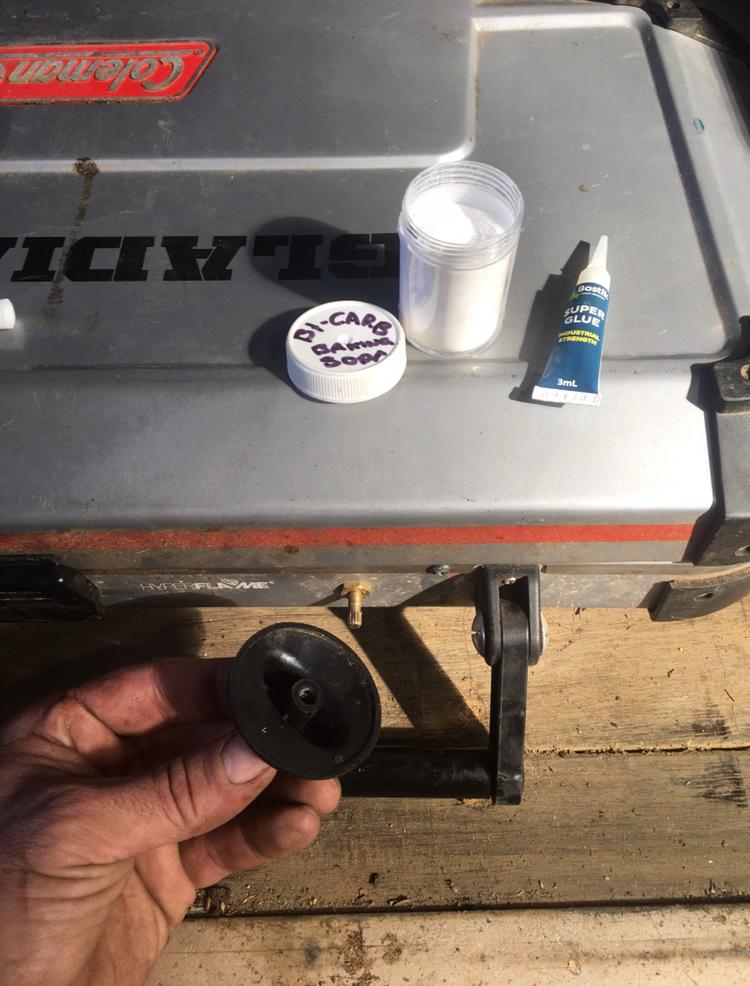

    FWIW: I now carry this small 2 part concoction found on Youtubey only a little while ago:
    Have a Youtubey search yourselves at how reactive the two are together with an incredible bond especially on plastics.
    Language warning: Aussie’s call the white powdery stuff ‘Bi-Carb Soda’ whereas Yank’s call it ‘Baking Soda’
