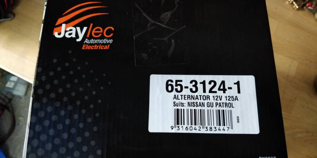

    I got the alternator replaced last week.
    Apparently the one that was in the car was the factory unit, which had lasted almost 300,000kms!
    The regulator had failed and the bearings were loose, so thought it best to replace it.
    The factory one was 110A (2004 TD42ti GU III) and I had it replaced with a Jaylec 125A alternator (part number 65-3124-1).
    Next I'll be following up the folding solar panel options as an additional piece of mind for camping.
