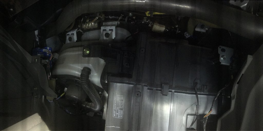

    Ok I had no time last week but finally managed to get 10 minutes to rip the glove box out. Had a good look under there and I can't see anything that resembles a box with a grey plug.
    Looks like I'll be fitting some after market kit. It's probably been asked before but since I've got the thread open and your attention, any recommendations on brand?
    After immobiliser and remote locking.
