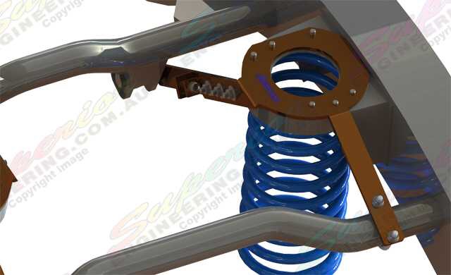

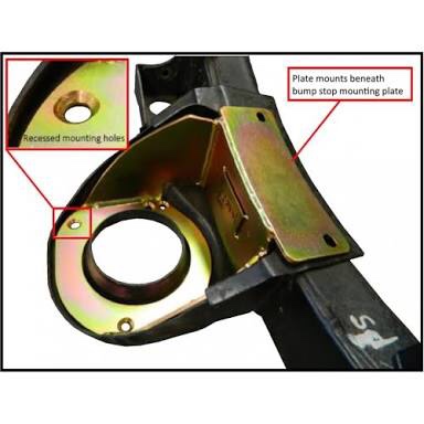

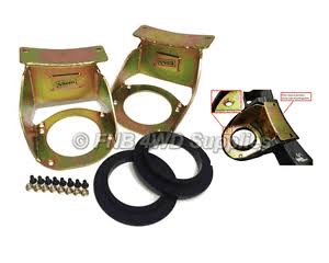

    Definitely brace the shock towers. A couple of options. A bolt in cup which is pretty cool I think or the Superior brace kit. Sorry no links but plenty of info about on both options.
    If you go the brave kit then a real option would be poly airbags in the back and a slightly softer spring for daily driving. Inflate the bags when towing.

    Now bracing is a good insurance..
    I personally never did but it was always on my mind when doing big trips and the old Q looking like something from National Lampoon Vacation..........
    As darren has pointed out there are 2 main options both with pros and cons..
    The Boss kit (first shown) is a great simple easy kit to fit but imo isn't as good as the superior kit.
    My reason is simple.
    The Boss kit still applies 100% of the load to the one area.
    Where as the superior kit spreads the load over a few square feet area of chassis either side..
    It braces to both chassis cross members either side..
    But as darren said have a read, there is heaps of info and quite a few members running each setup here..
