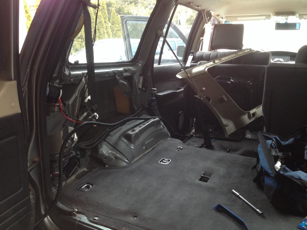

    I've already ran some 6B&S power and earth cable along the inside of the vehicle from the engine bay to the rear, and will be installing a fuse box in the front and rear of the vehicle.
