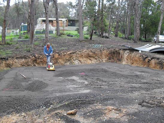

    Base preperation on hard clay ground, no fill.

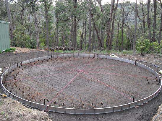

    Base frame up, all wacked and string line measured out for framework placement.

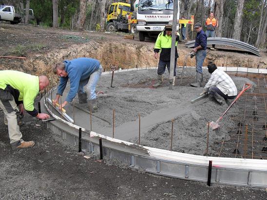

    Pouring concrete, everyones busy now...lol

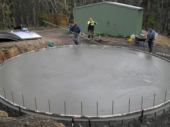

    Screening to have a smooth finish for the walls to sit on.

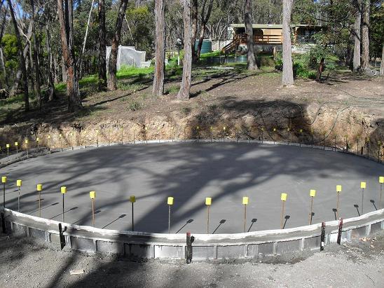

    Stage 1 complete, base all done and ready for the walls.

    The guy in the photo above who was pouring the concrete lost his home and to this day his family is still living in his mates shed because the government have not allowed him to build yet.
    Their still deciding on what category his property falls into for what type of home needs to be built. It's been 18 months already, just work it out so all these people can bloody start building.
