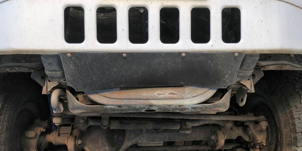

Do you guys have this air dam fitted still? mine is broken along the bottom where the three bolts are but stays in place.
Also the foam along the top of the radiator? again mine is partially in place but coming away on the left had side of the photo.
Both those elements assist moving the air though the radiator.
