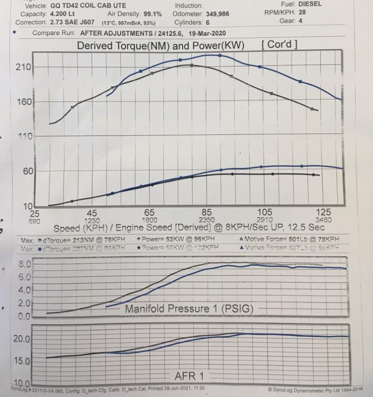

    Dyno results below for Old Grandpa Spec Ute:
    Blue Line was early 2020 when we finally requested Andrew (Dieseltec) kindly turn it down for us as it was properly sooting black cop bait from the original owner.
    Black Line was Friday just gone showing reduced power from previously 65rwkw on 33” High Friction Roller-Muddies down to a now 53rwkw on 33” All Terrains. Torque drop from 227NM - 213NM on what nuffy appears to me to be a much differing early rpm curve line?
    Quick advice so far is to look towards a future rebuild with fresh injector pump, turbo and added intercooler.
