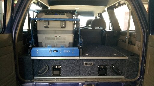

    Has anyone else installed a MSA DS40 drop down fridge slide on top of the Titan draws in a Gq ? How did you manage to keep it on the left side to utilise the draw slide ? because it hits the latch if you centre it and when you drop it down did it clear everything with out using the Titan slide ?

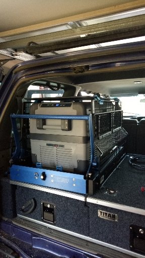

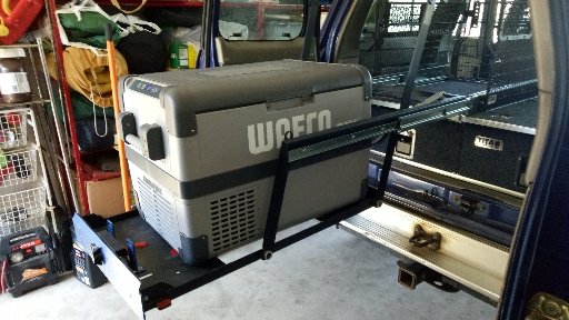

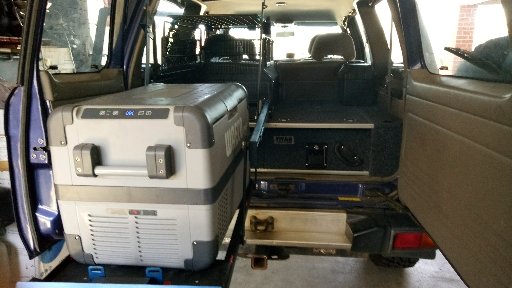

    I've got mine in a GU series 1(don't know if it's different to a GQ) on a slight angle, so when it's out and coming down it just misses the little barn door. You do need to hold it away from the door or it will scrap the top of the door. With it fully down I can open the right side draw with no problem.
    I'll see if I can get some more pictures. Is there any shots you want
    Thanks for that and yeah there is a difference on the Gu the body is wider and I think my be the roof is a bit higher so that puts the centre catch over for you plus I also realised that my fridge is thinner and teller where other are wider and shorter which would have them passing under the centre catch, so the only fix for me is to lose the extra slide length and move it to the right side but thanks for the pictures at least is shows me that the slide will come out and clear the bumper off the draws.
