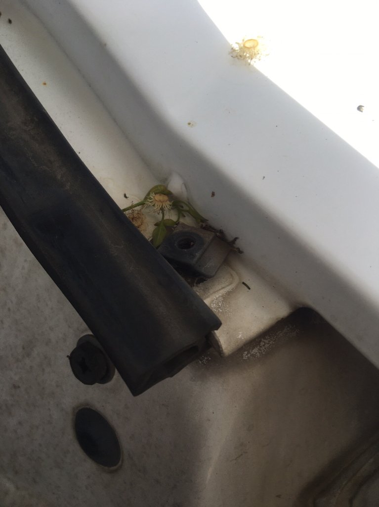

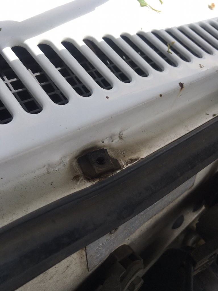

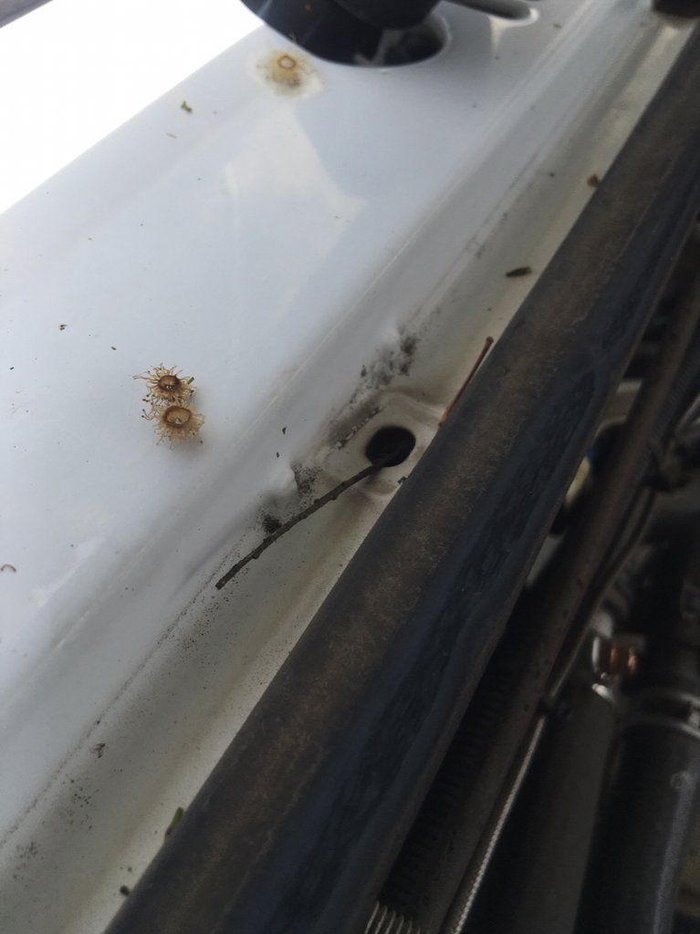

    Not sure how we/he missed this, appears out of seven scrivets in total, one is completely missing and two are missing the center pins.
    Should be a much easier than first thought fix, we can’t thank you enough ET!
