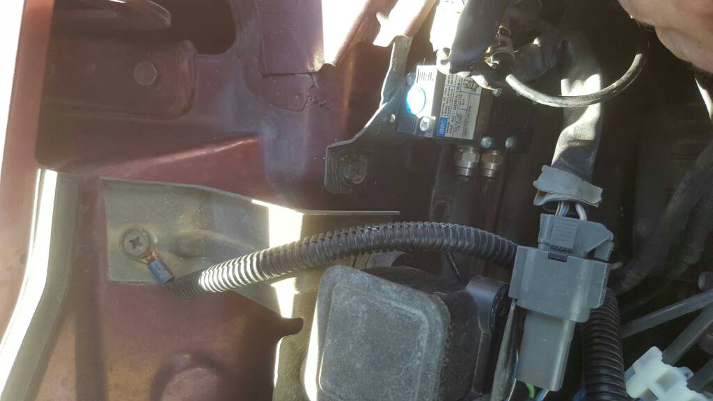

    Is this the solenoid?
    It has Hitachi AESE 128-18A 3719 written on it. I googled that but couldn't find anything.
    I hopped under the rear and removed the vacuum hoses, one at a time, with the diff lock switched on & then off. I had a tiny amount of vacuum out of one hose with the diff lock switch on & off and none out of the other. The hose with vacuum is shown below.

    Yep thats the solenoid. Technically its actually 2 there. One holds disengages and the other engages. The one that engages u
    If your getting air out of one line and not the other i would say the vac solenoid is stuffed.
    This is what i replaced it with.
    Model 45A-AC1-DDBA-1BA
    You can even use the old bracket after bashing it a bit flat with a hammer.
