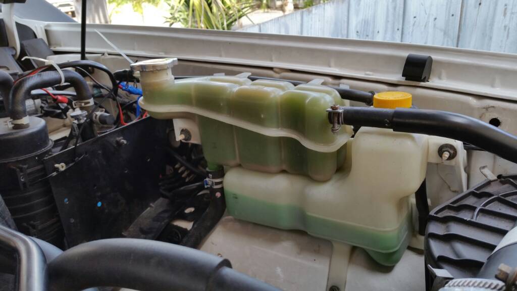

    I think it's finally settled and burped it's self entirely. Header tank full to brim no bubbles. Good result.
