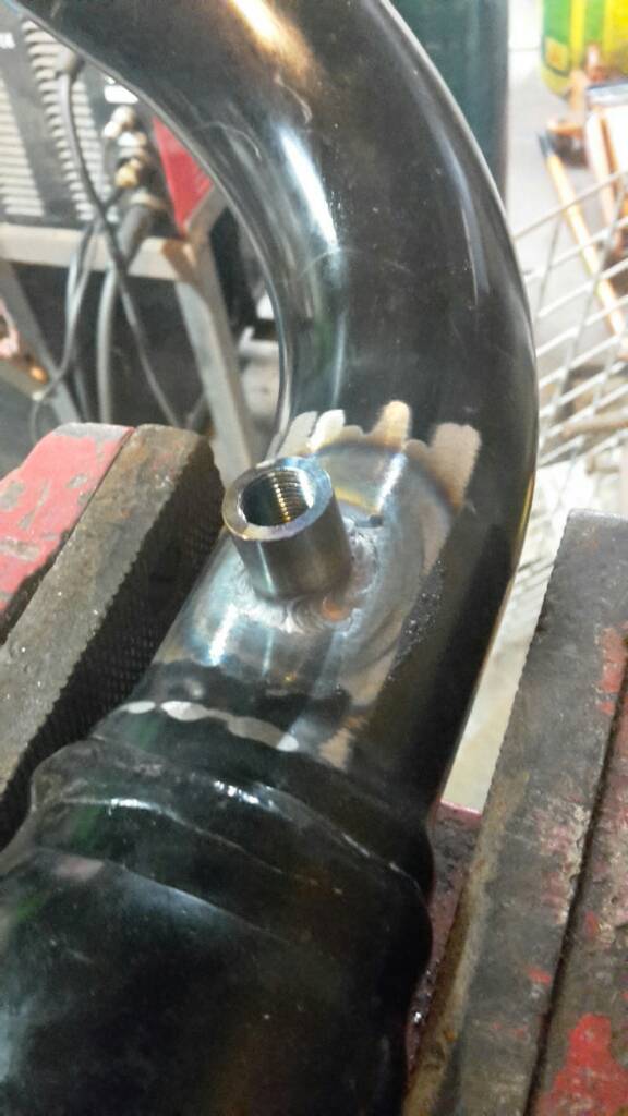

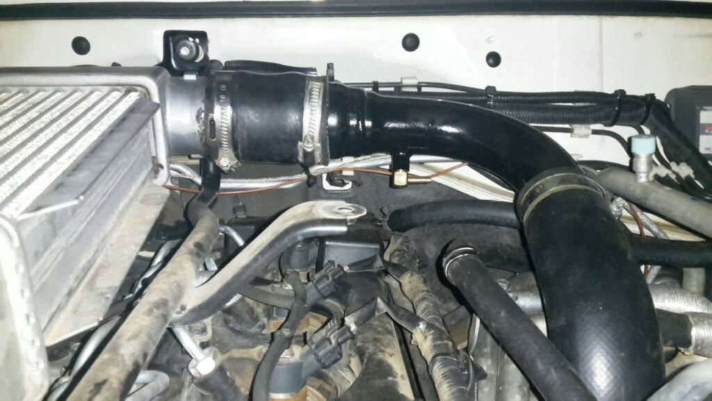

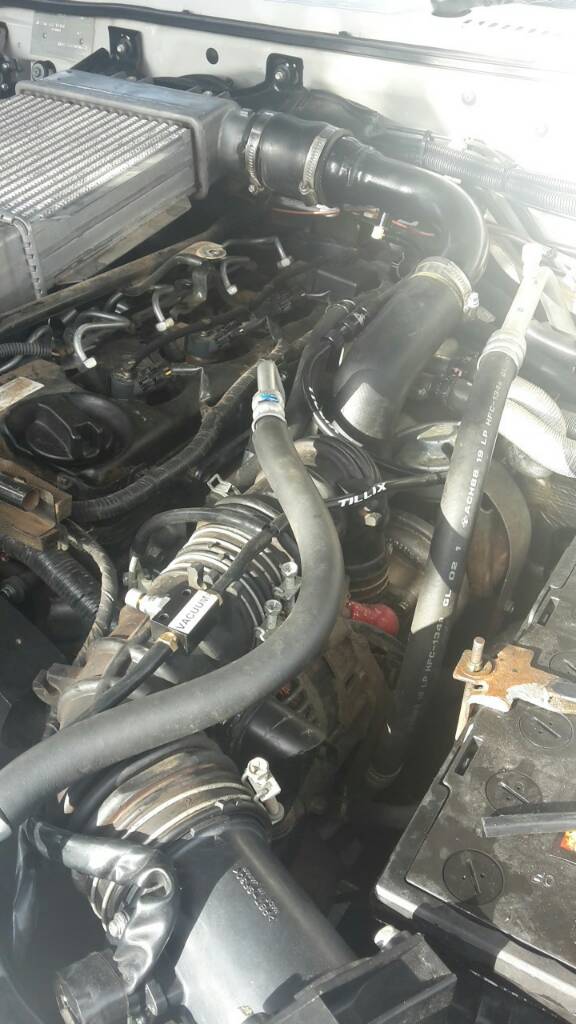

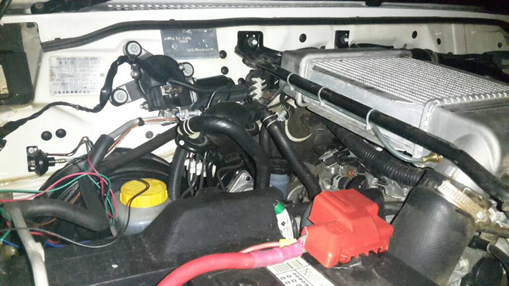

    Ok so tillix is in..
    Sooooooooooo easy..
    Crazy easy..
    Still some micro tuning to do but very happy..
    19-20 max boost and 16 @ 110.
    That 16 @ 110 is what I want to reduce a smidgen so will fiddle a little more with needle valve. @mudski your spot on about the needle valve..
    1/8 turn goes from what I have atm to 15psi max, laggy as hell and egt's sky rocket..
    But overall for the money it's a top kit..

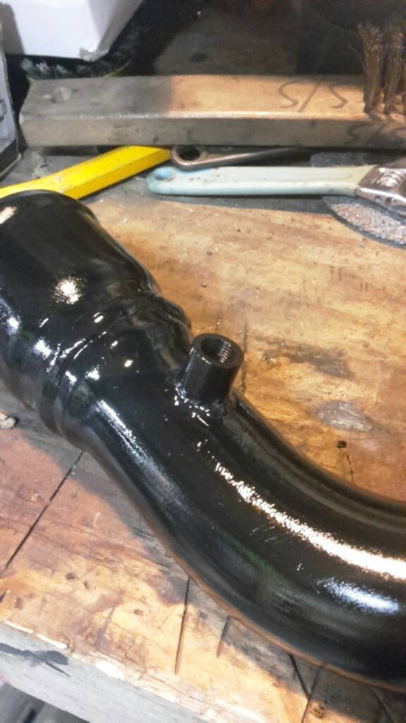

    I tig welded the socket onto the intake pipe, and tapped a threaded barb into the intercooler for boost gauge..

    For some reason I thought you had a direct injection motor. But yeah. Theres no point at all just putting in the Dawes or Tillix. The needle valve is where you get the performance.

    I used this hose for the boost line, note it has clamps for each connection,
    If I ran out of clamps I had blue cable ties on hand to achieve the same thing
