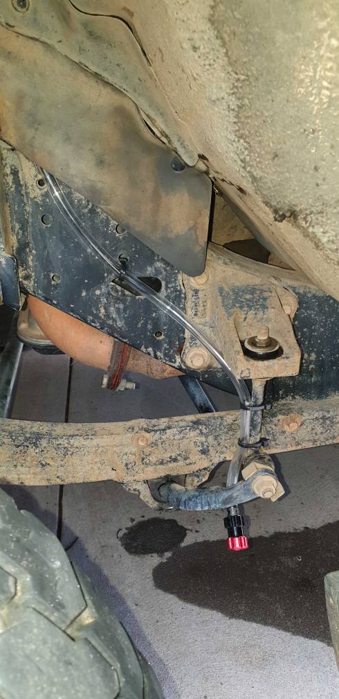

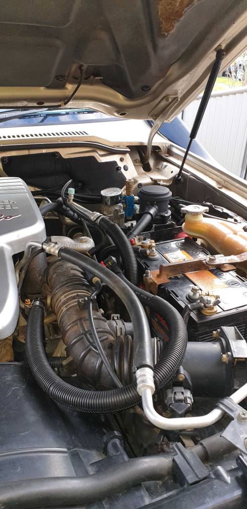

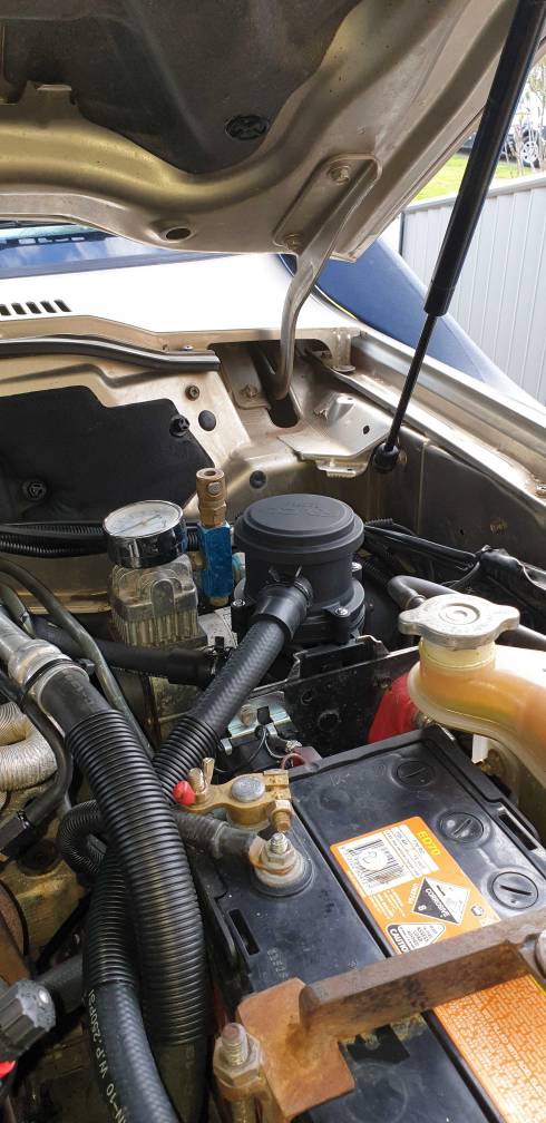

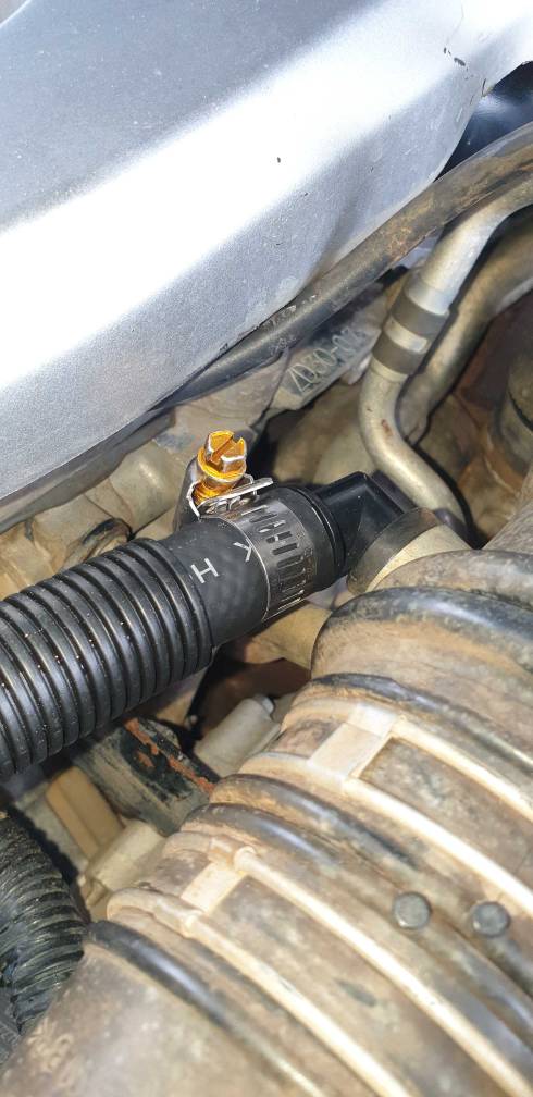

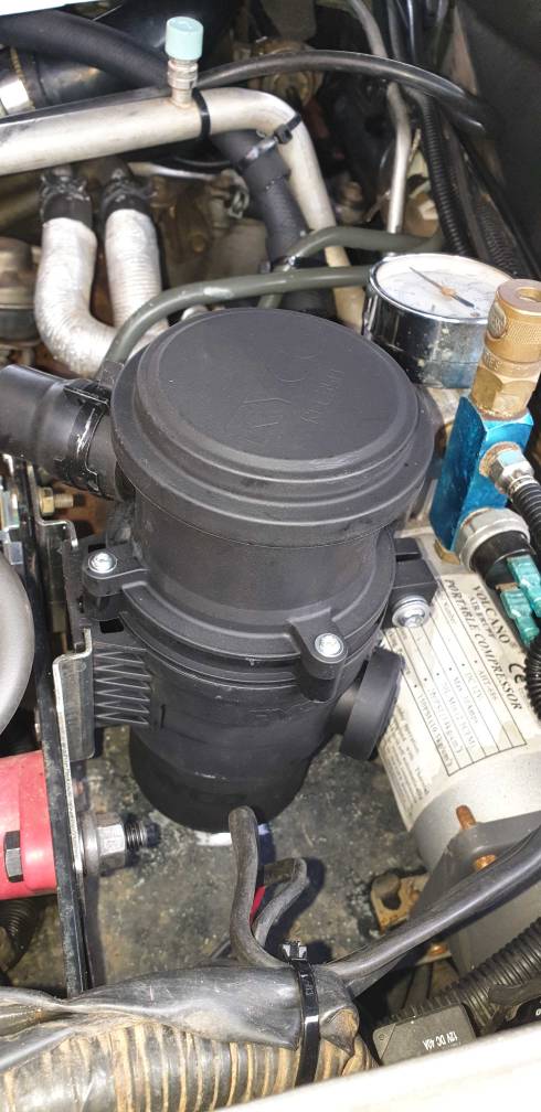

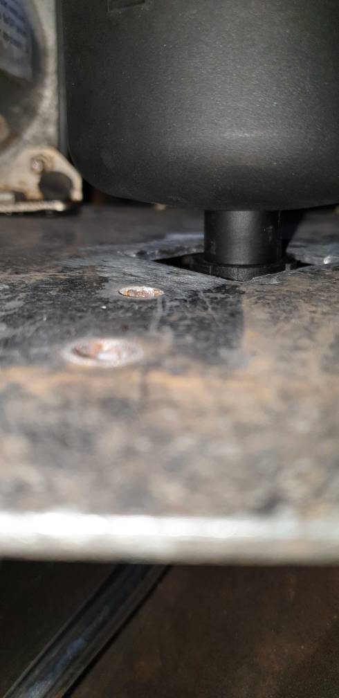

    Installed Ryco Catch Can today to 04 DX with DI ZD30. As you can see from the pics, there ain't much room under the bonnet. I was considering moving the compressor but after much procrastination I decided to modify the mounting plate that the compressor sits on and success! Turned out pretty well I think and I'm happy with the result.
