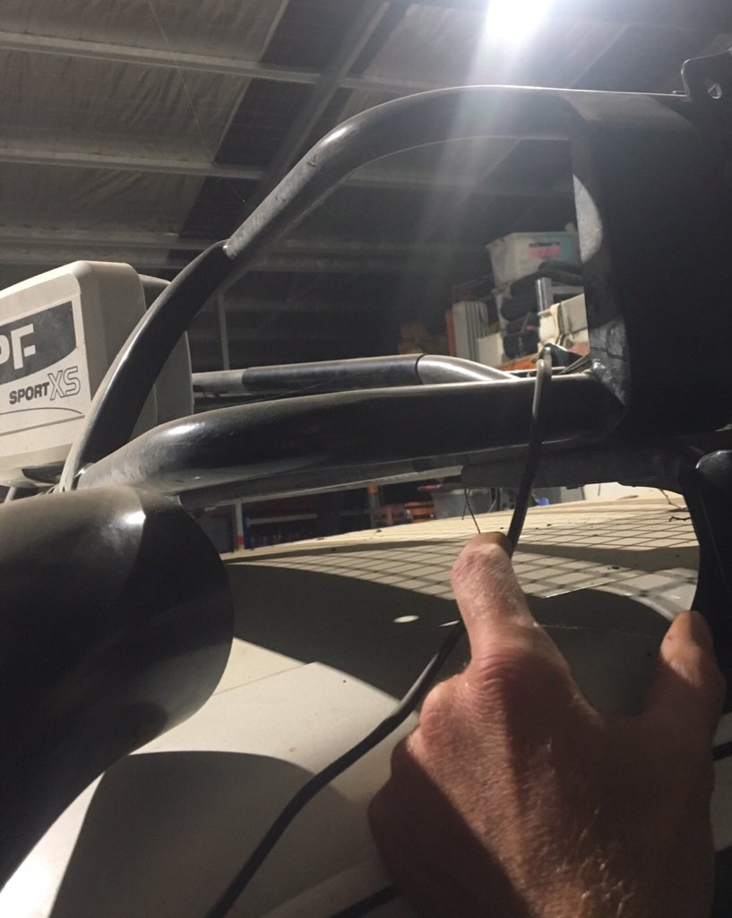

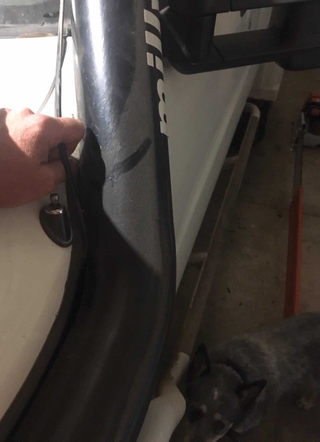

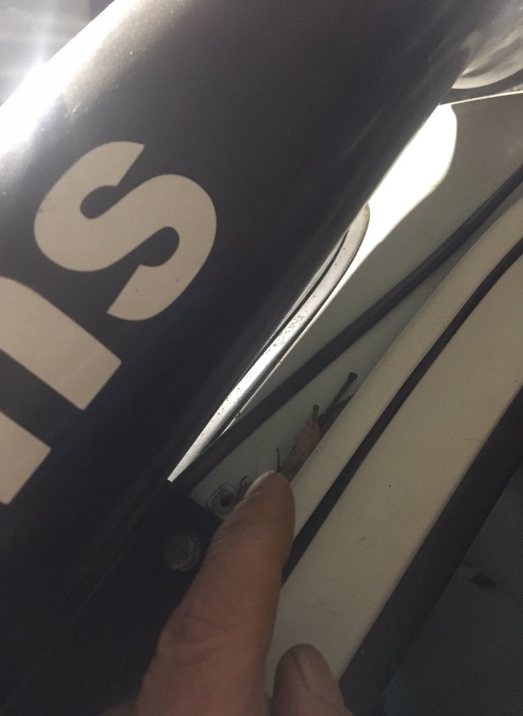

    Not suggesting to do this as I don’t run roof lights but have seen people run them down inside snorkel and into bonnet or run down snorkel under side hidden to avoid cutting into roof of body.

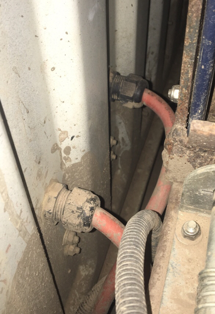

    Tis a bit Agricultural Rixter mate and should seriously have more McZippy’s used but does keep the voltage length closer to the sauces :-)
    My GUIV is the same as this
