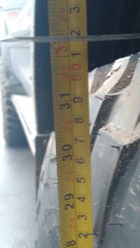

I want to see how these tyres wear so I measured the tread, starting point is 15mm.
Also I measured the overall height and was a bit surprised.
http://www.nissanpatrol.com.au/forum...016/07/122.jpg
32 1/4".
Sent from my XT1068 using Tapatalk
Can anyone explain why this is.
I remember reading somewhere that comp tyres are bigger than what is stamped on, but these are smaller.
Would it have something to do with tyre inflation/ psi ?
I thought of that, but the actual size is 32.8, that's 1/2" difference. They're at 40psi ATM. Would they really change that much?
I honestly have no idea John. It was just a first thing I thought of and a wild brainstorming guess. I mean, physically, if you deflate a tire, give it a larger footprint, then the vertical diameter decreases , edge to edge does it not ?
Even if it is 1/2". Maybe not in your case.
Cheers Eric.
No biggie really, just curious. Might go stick some more air in and see what the difference is.
Would this maybe have something to do with them being measured from factory in an unmounted state?
Once mounted, inflated and then with weight on them i would imagine the base of the tire to conform to the ground (flat)
Would these factors create the roughly 1/2" missing from the overall height?
Who knows mate. I know that my work we have a 2% variance plus or minus it's always minus
