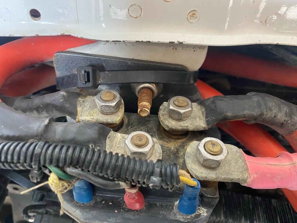

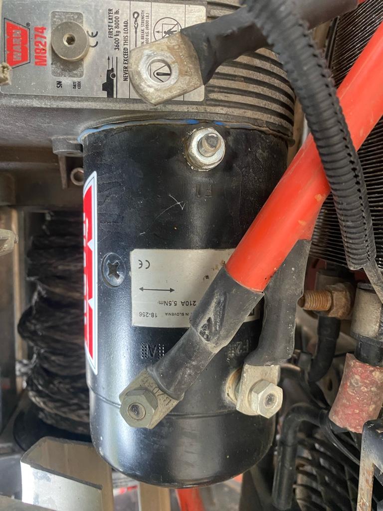

So what’s the best thing to protect the cable lugs to the winch solenoid and winch motor from corrosion? Both end on my hi mount were pretty bad. All cleaned up now though.
http://www.nissanpatrol.com.au/forum.../2023/03/2.jpg
http://www.nissanpatrol.com.au/forum.../2023/03/3.jpg
I was thinking to use dielectric grease. Went to Jaycar yesterday and they didn’t know what it was. Lol.

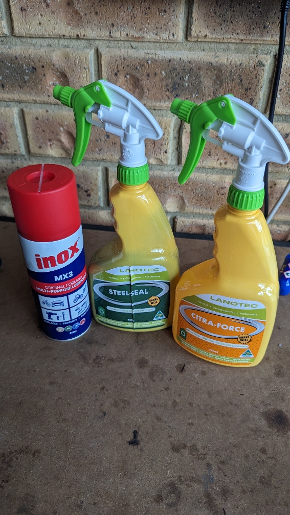

I use a combo of the following Mark.
Lanotec and Inox MX3. Swear by it.
Not just elecy stuff that's weather prone , but everything in general. I've thrown CRC and wd40 in the bin years ago when I discovered this.

Hey Mark had a read through your journey the trol has taken, well done mate! Did you sort the buzzing relay out? I had one do the same recently and it was as simple as cleaning the neg terminal earths to the body and engine. Your winch wires can be sealed after cleaning and re connecting wire liquid electrical tape like they do with marine wiring. There’s probably other products on the market but boat electronics in salt water corrodes fast so look at what they use to help with that situation.

Next time I see you I'll give you a tube of electrical corrosion inhibitior we use on tower lines... Ugly smelly heavy duty shit..We literally call it dog shit. Smeared some on my winch connections for years. No issues !

Got a tube of the good stuff for you next time I see you. Perfect for exposed winch connections.
Been using it on my forever not a spec of rust or any corrosion! We use this on every connection on the lines.

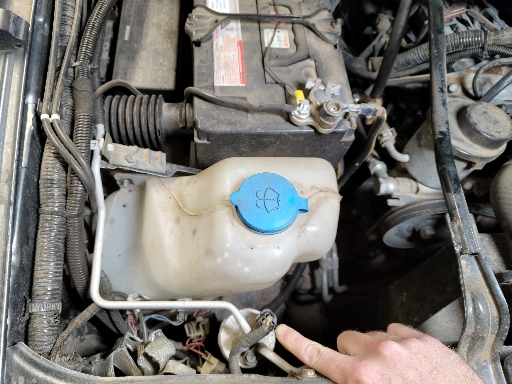

I had to troubleshoot my aircon not turning on too. A mechanic mate of mine helped me and we resolved it in less than 10mins.
First, take this little cap off and press the valve in *briefly* to check there is gas in the system.
**It's marked with an L for low, DO NOT press in the side near the radiator marked with an H, that is high pressure**
If there is gas in the system, it's either a problem with the compressor, electrics or control module.

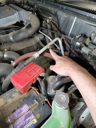

My problem ended up being a dirty contact in this terminal preventing the receiver/dryer from switching the system on.
http://www.nissanpatrol.com.au/forum...2023/04/75.jpg
I cleaned the contacts in this plug with some electrical contact cleaner and it worked perfectly again!
