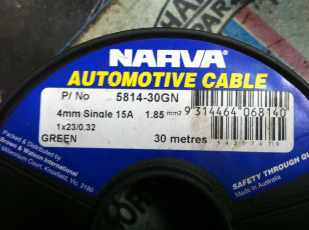

George (or anyone), are you able to get your hands on some cheap 12V wire (4mm)?

Chris wire is wire, cars use 10amp mainly and 15 amp wire generally but i'm not sure if 12v is different to 240v but i do know that the wire used in the house walls is rated 10 amp but is 15 amp wire if that makes sense?? Even tho most power points are 10 amp they under rate. When i go to work on monday i'll look at a spool and post a pic of its specs.

Sorry George wire is not wire. Automotive cables will be required. Housing wire has much thicker stranding and will not be up to the punisment of corrugated roads and will break.

Wire! Someone mention wire. I can get 4mm Narva wire in just about any colour cheap through my second work place. Tip. if you need multiple colours, get 7 pin trailer wire and strip the colours out you need. As that is sold by the metre is can work out better that way. Plus 4mm is ample for nearly anything in a 4by.

Can you get 10m 7 pin wire please mate?? Its over kill but better to have too much then not enough.
