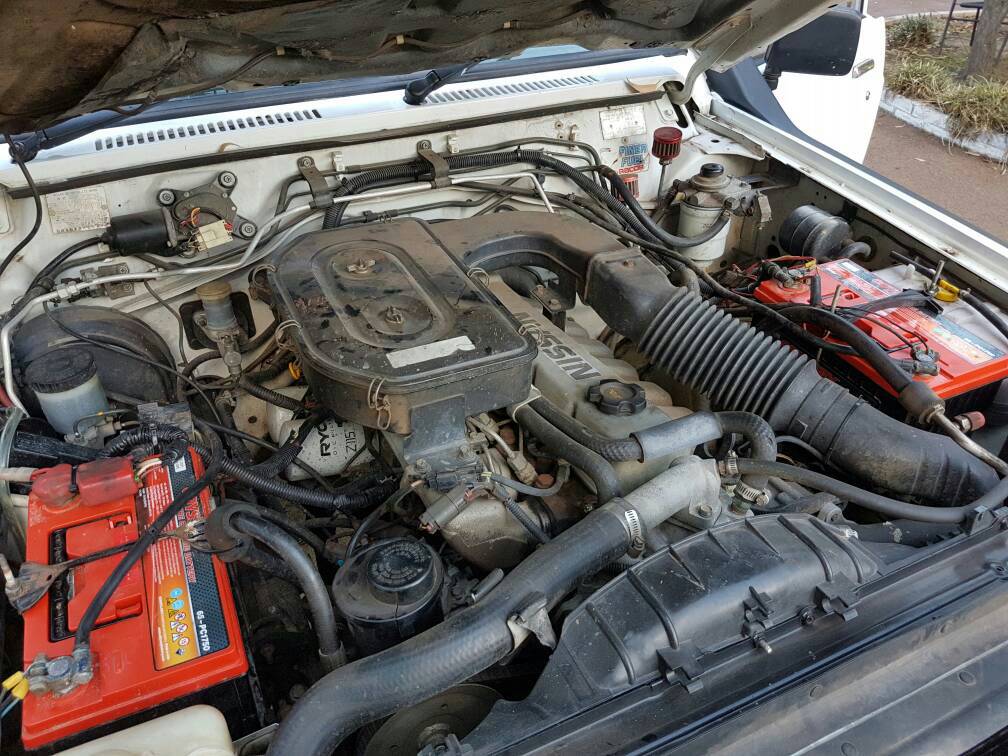

    Why did our Yanky ‘Odyssey’ friends move out? Plate vertical batteries with sealed epoxy say tops and bottoms for vibrations, too expensive?
    Ive got 2 odyssey's under the bonnet in my patrol, cant fault them at all. And the best bit...they were free!!

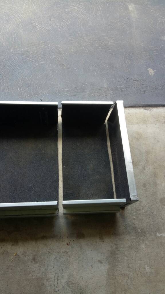

    177 Post(s)
    It was suggested to me Eric from someone that if I wanted to have the battery in the rear with draws there also, that I should look at shortening one of the drawers enough so that the battery can sit behind the draws. I was also thinking of some how tucking it in the side above the wheel arch where that pocket is. I let would be half hanging out of course so some fabrication work would have to be done to secure and hide the battery.
    Sent from my crapPhone using Tapatalk
    Markie. You're a mind reader !!!!!
    I spent a bit of time this arvo looking at just that and measuring up and getting come bracketry ideas. And I think I've come up with something.
    Will lose around 18cm of the draw, which is bugger all. The end of the draw is easy to grind the welds , cut the to size and weld or rivet the end back on. Drill some new holes for the rubber stops and voila!!! Battery hidden away and still easily accesible when you slide the draw slide open.
    I got the idea of someone else who has done it on the other patrol forum. Also , there are a few people with shorty GQ's who have shortened them draws to suit the back of the shorty!
    Watch this space!

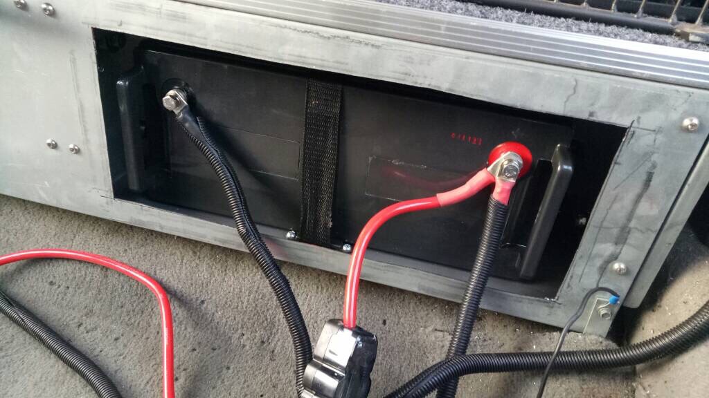

    @Hodge mate, @jaysee mate did a great mod like that and kindly posted on here a while ago. Squeezed a whopping 140AH behind his shortened drawers he modified himself too.
    In his build thread: ‘Jay see 1997 GU build up’ (apologies, don’t know how to hyperlinky to it on Tapatalk)
