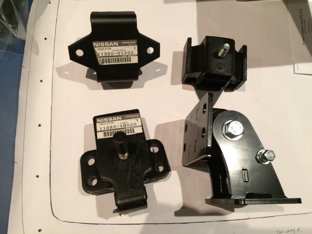

I should have gone genuine for the drivers side. Quite a lot of vibration with both superior mounts.
I was 50/50 on going genuine on the passenger side too, as Patrolapart has them on special for just over $100, and you can't get 1 cent discount with Superior (well at leastI can't). I'm hoping with just the 1 mount the vibration won't be too bad. Lots of reports saying both yes and no, so who knows. Time will tell I guess. I just hope it fixes my driveline vibration under load.

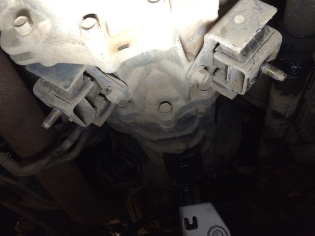

Started doing the gearbox mounts tonight and all was going well. Cross member out ready to undo the mounts.
http://www.nissanpatrol.com.au/forum...015/12/133.jpg

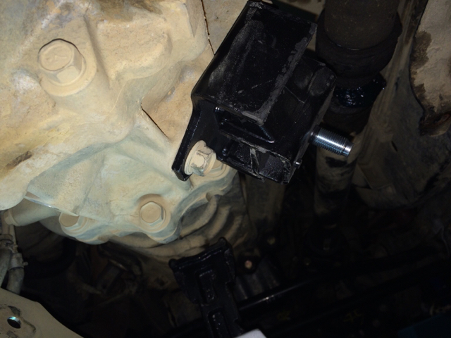

Drivers side out and in, easy
http://www.nissanpatrol.com.au/forum...015/12/134.jpg

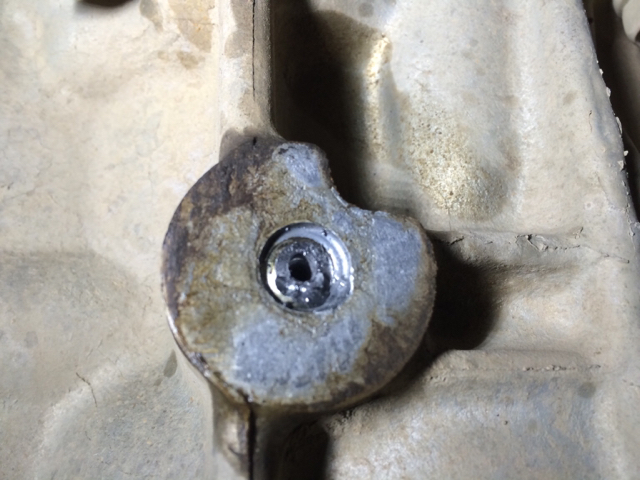

Then the passenger side, 1 bolt out and then this happens, not happy Jan!!!
http://www.nissanpatrol.com.au/forum...015/12/135.jpg
Err thats a bummer. Hope you got some good drill bits and enough room to drill into it.
Your telling me. Theres no reason for it to be that tight, all the others once cracked were pretty much finger tight to get out, I don't get it. I'll try an hit it with a punch and see what happens, if not then start drilling and head up the shop in the morning for some Easy-Outs.

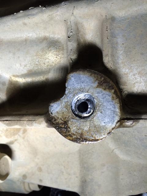

That might do for tonight, have to go up the shop later and get some tools and another bolt.
http://www.nissanpatrol.com.au/forum...015/12/137.jpg
http://www.nissanpatrol.com.au/forum...015/12/138.jpg
What a bastard, at least it's not in a awkward spot.
Not a welcome site broken bolts, good luck.
some freeze spray up the center of hole may help to shrink it a little to help loosen it.

Bit of mixed success tonight. I ran the drill through it a couple more times, give it a couple of big whacks and applied some heat, attacked it with an easy out and no love. Was probably a bit timid with it as I sure as hell didn't want to snap the easy out off in there. So I gave up on that and just kept on dilling, eventually as the drill was biting through it would grab and then start to screw it in further. No no. I got my little punch out and wrestled with it but it wouldn't come out, Although I was able to fold it up a bit with the punch and then drill those bit out. In the end I folded it all up towards the top of the hole then shoved the drill in there and it all came out. Unconventional maybe, but hey it's out.
http://i1083.photobucket.com/albums/...psbcjpr27k.jpg
In doing this I also kinda drilled away some of the existing thread, so time for an upsize, ran a bigger drill through it and cleaned it up.

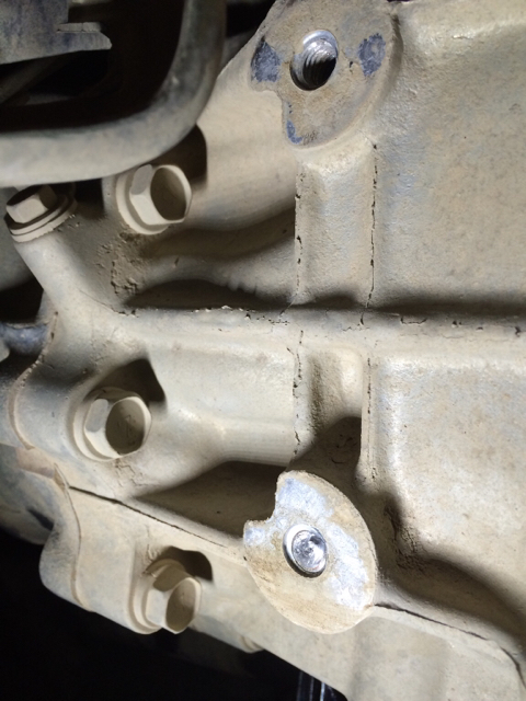

Then ran a 12mm tap through it.
http://i1083.photobucket.com/albums/...psnv6t4pkb.jpg
http://i1083.photobucket.com/albums/...psmiwt0bbk.jpg
Mounted the passengers side mount, remembering to put the exhaust bracket in, then on with the cross member and job done!!
