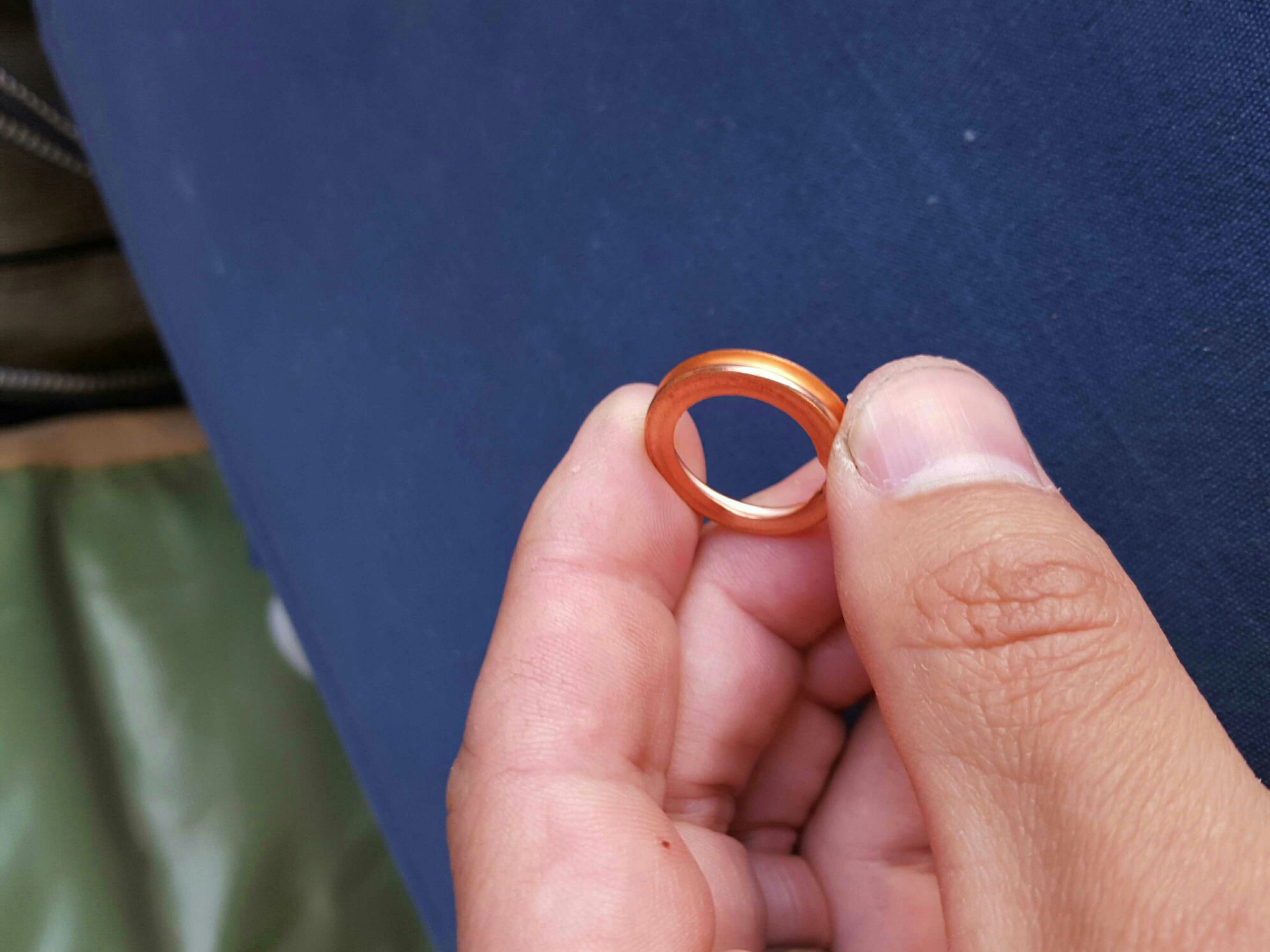

Which way does the washer go. Plug through the flat side first or the flat side up against the sump ??
Have a look here. Is that what you've got?
That's it mate. You legend. Flat side against the sump.
Cheers.

Oil, filters and fuel filter change finally done. Massive thanks to Bloodyaussie for coming around and observing the amateur. haha
And for driving off to grab a proper sump washer, after I realized they had given me the wrong one, after I squashed it and realized i the end it was too big. Big cheers mate !!!
