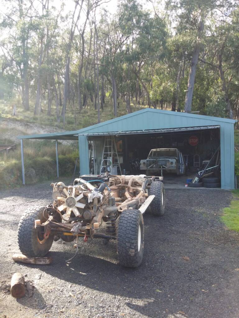

Just dropped the cab off @ the panel shed, should be nice & silver by then end of next week if all goes to plan. Just need to prep the doors & bonnet and get them in there too. .

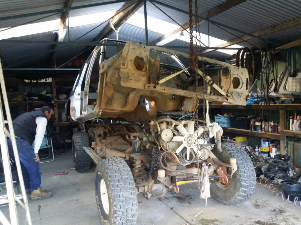

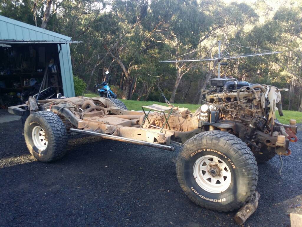

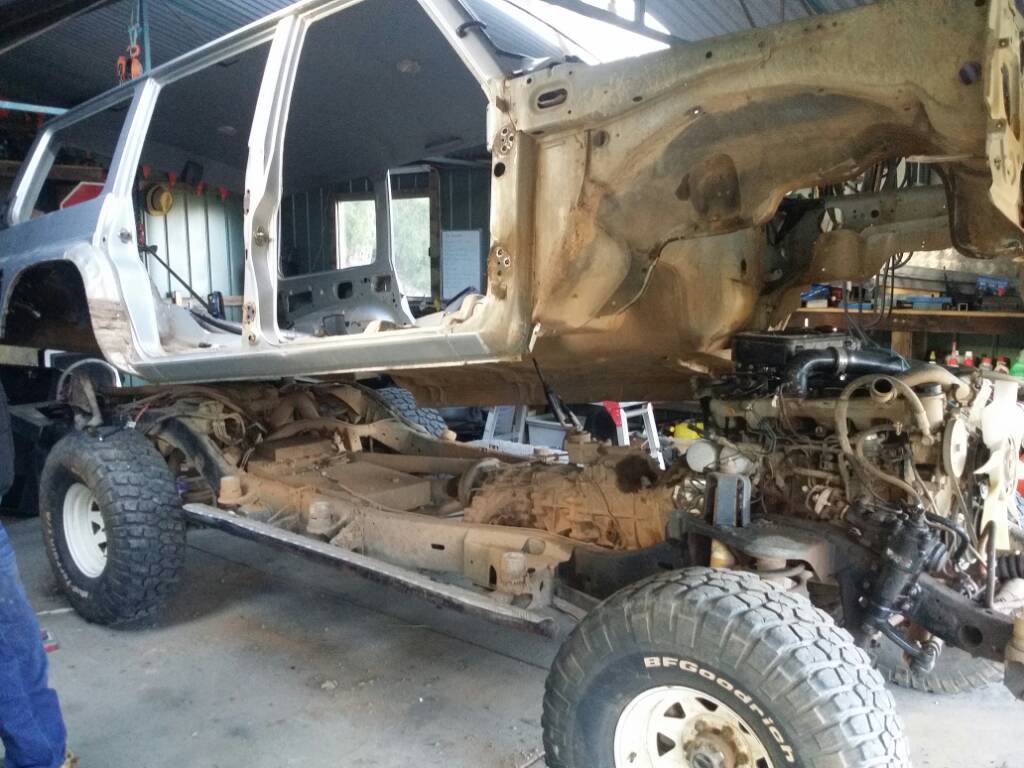

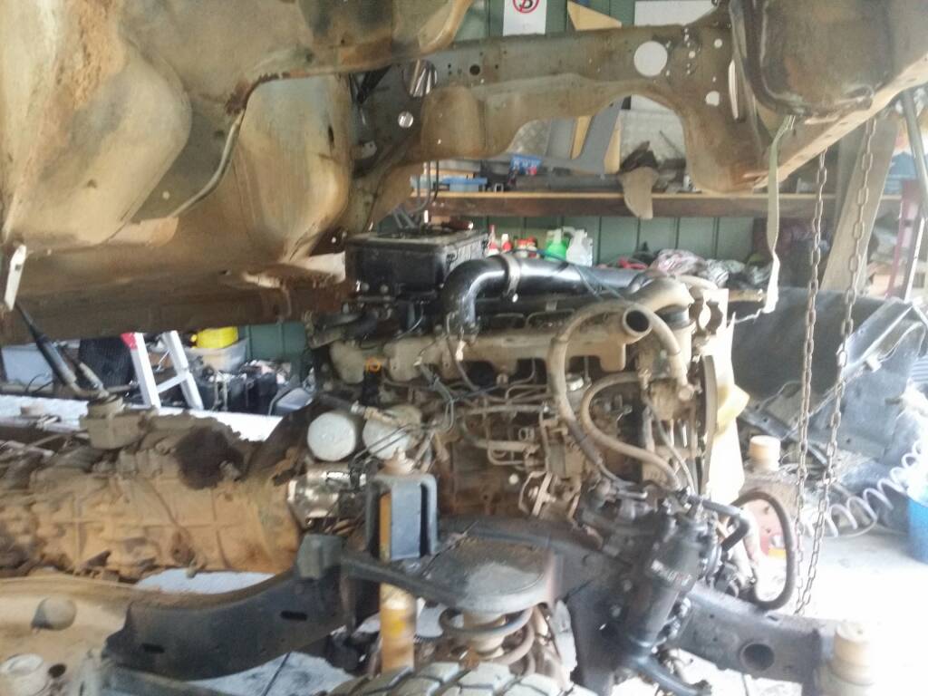

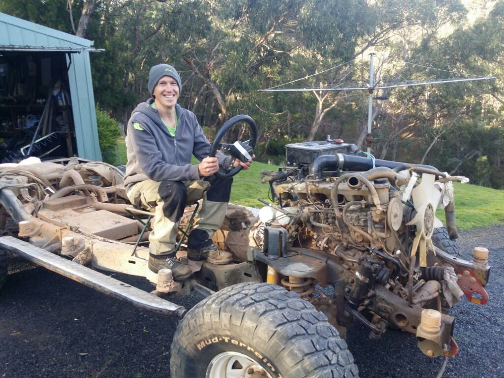

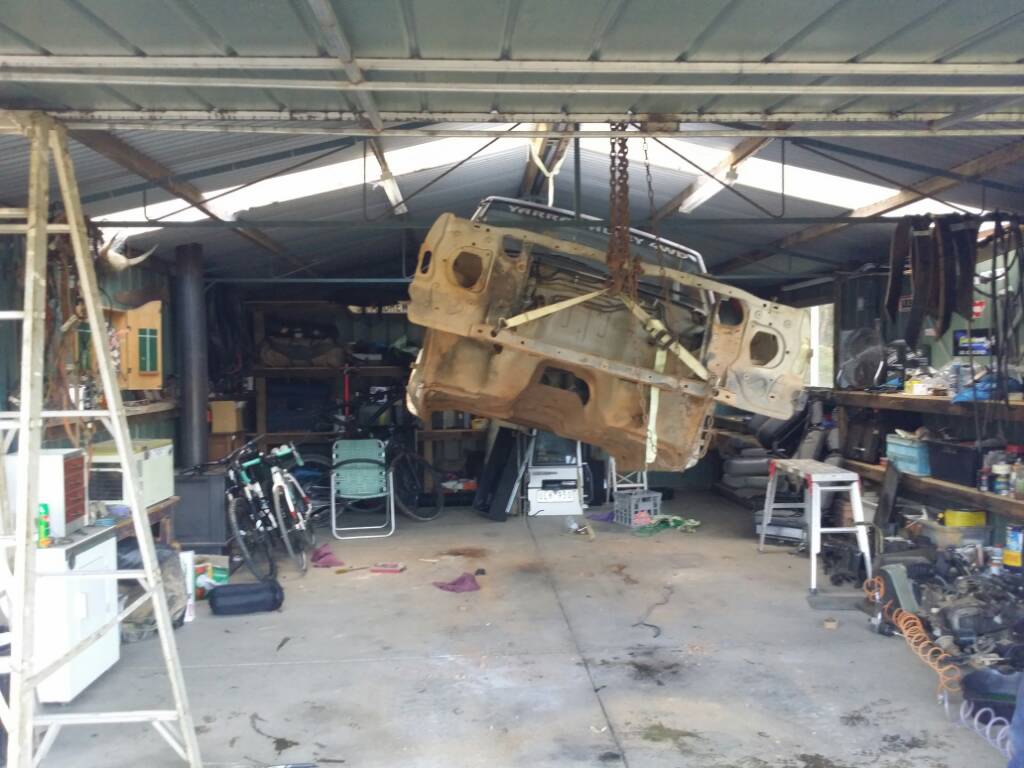

Well the body is off. . .

She's a bit dirty under there. . Time for some cleaning. . .
Good time to pull that pump off ;).
I done my clutch when I had body off too and took me about 20mins to do haha
Yeah me & AB were looking at everything seeing how easy it world be to do. . . Crazy ! !

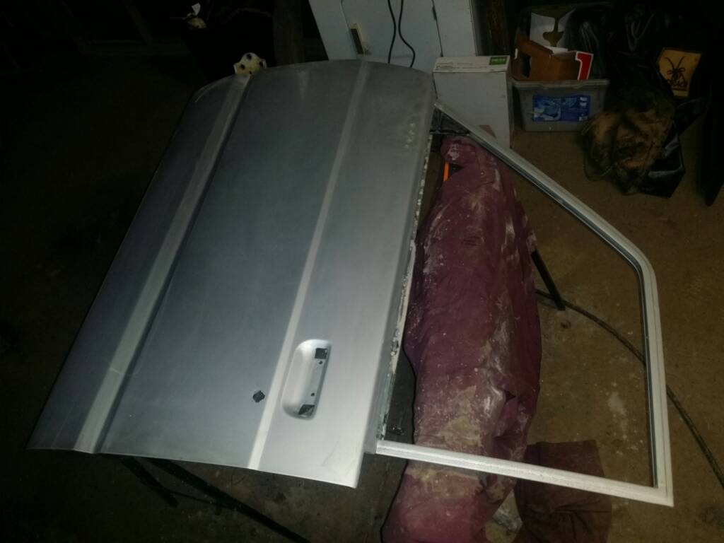

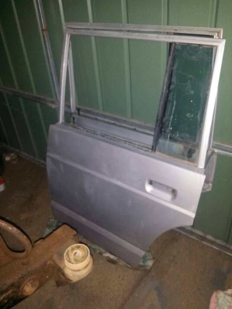

Well the cab has been painted, can't wait to see how it looks, came up alright aparently. I'll grab it Friday, have been busy striping & preping doors this week. Had to repair cracks in both the rear ones at the base of the window frames.

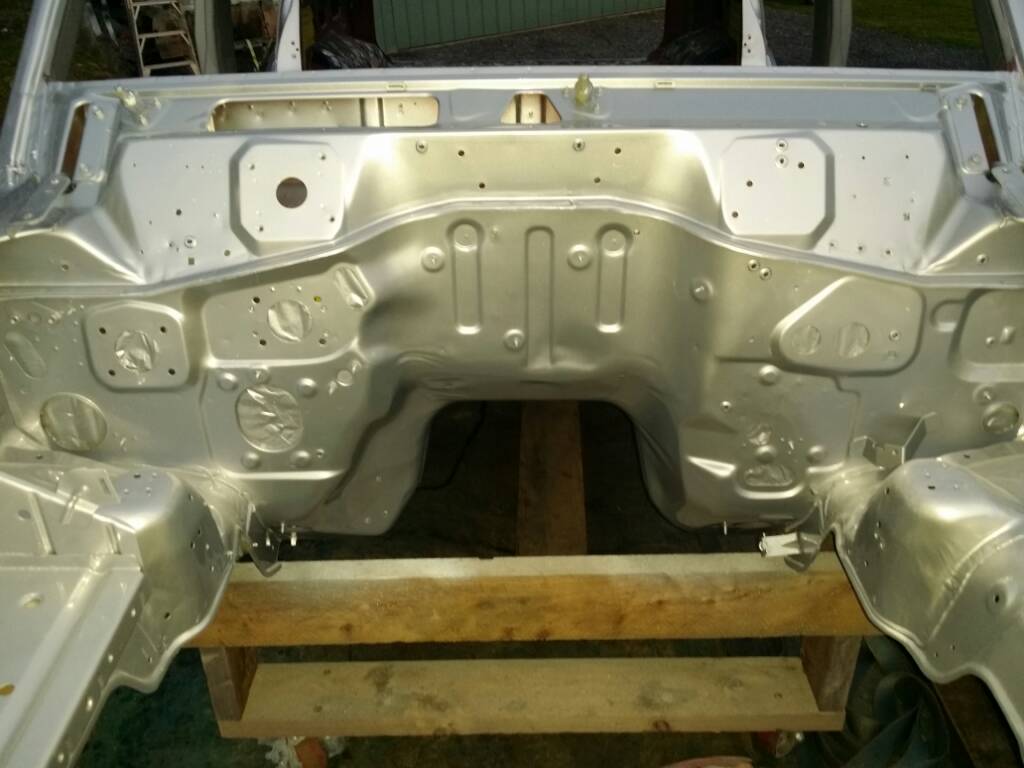

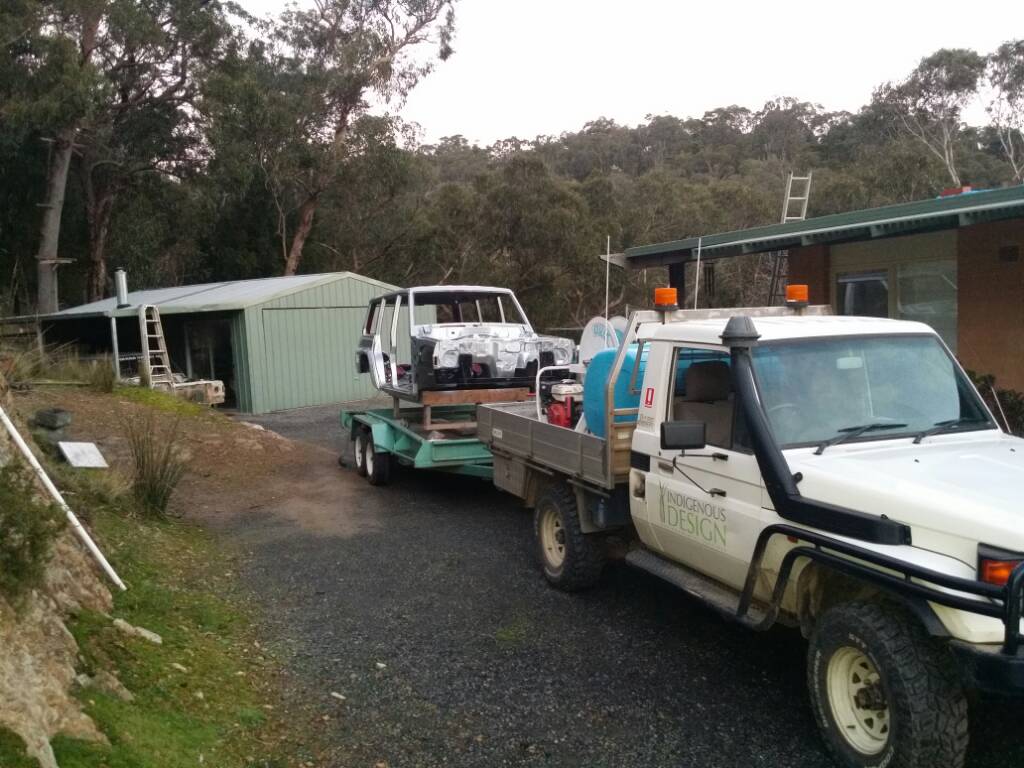

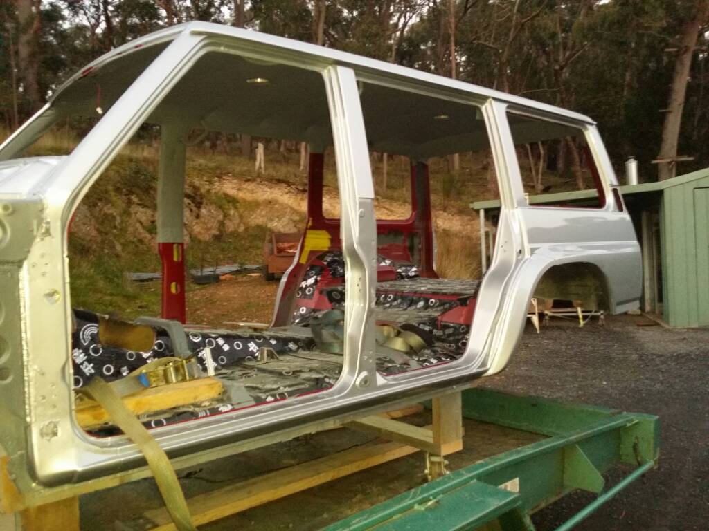

Picked up the new cab this arvo. . .

Sincerely hope this is the only time the GQ is towed behind a Cruiser. . . Had to drive it home with a bag on me head so no one saw me . . .

Engine bay is sweeeeeeeet.😊
http://www.nissanpatrol.com.au/forum...017/06/293.jpg
SHINEY . . Gonna be a shame to drive it let alone bash it through the scrub. 😕

Yep had a little sticky beak and it looks awesome! Shiny engine and chassis time, showroom condition when assembled for photo shoots and then time to destroy all that hard work on a tight pinstripe track :(
That's so sexy Rossco!
I hate the Mag but the one thing i regret not chasing when i rebuilt the GQ was a Photo Shoot for the 4WD Action mag just for the memory and Souvenir. I wrecked it quickly and was not longer suitable but you should line up a photo shoot with them mate, they will be keen as bud. They very much like them when everything is spotless clean like yours will be.
I took mine down an overgrown track on the first day trip out and it hurt a lot!!! i felt every scratch in the paint.
Next trip out i crashed off a slippery track in the Snow and hit a tree and put a dent in the front quarter panel and the rest is history. It looked great.......once.
you didn't paint the panels yeah? how is the colour match mate? You will have to give them a heavy Cut and Polish to match the shine. Engine bay is Glorious mate.
