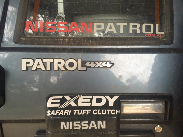

Honestly just noticed this today on the back of AB's now ridiculous beast :-)!
Worth reading the 'fine' print below the sticker! 'Upgraded ballistic plates are available on request if QLDer's have crossed the border' :-)
Well done Matty, OldMav & BenEboy, unbelievable:-) !!
