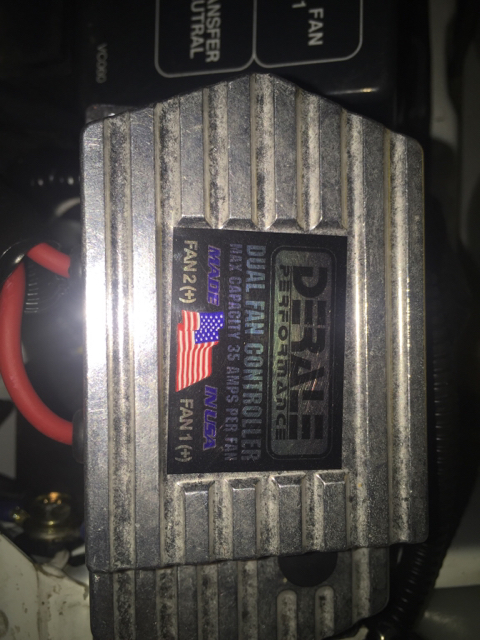

Thanks AGman, yep each fan runs back to its own 180amp relay and is now just recentally installed thermo controller by this ripper company from the USAhttp://www.nissanpatrol.com.au/forum...016/04/178.jpg
Better pic below:
http://www.nissanpatrol.com.au/forum...016/04/179.jpg
