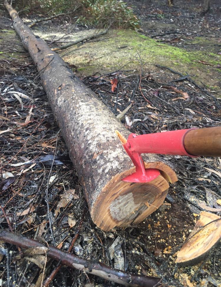

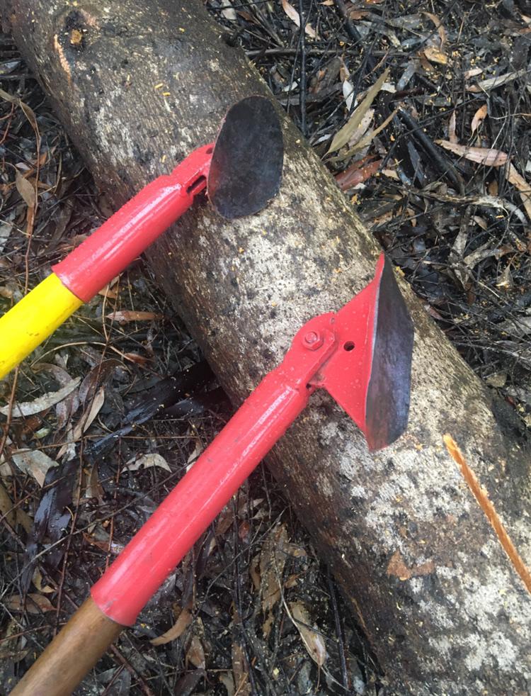

Was so excited today, our local Blacksmith brought our wacky concept to life and delivered so I quickly raced up to our little coupe for some barking mad tests:
http://www.nissanpatrol.com.au/forum...021/06/113.jpg
I fair dinkum got a twitch in my jocks upon first insertion:
http://www.nissanpatrol.com.au/forum...021/06/114.jpg
Disaster, damn thing follows the point of least resistance straight back up off the Sapwood and is exhausting attempting to keep it on a straight track to the end:
http://www.nissanpatrol.com.au/forum...021/06/115.jpg
Our original lightweight 5 minute popping crowbar/spuds are still number #1, was worth having a crack though, no harm no foul [emoji23][emoji106][emoji106]

Simple question from a simple mind. Did you try dragging instead of pushing the debarking bars, Mark.
Thanks Craig Mate [emoji106][emoji106]
We’ll give that a try too this week, weather permitting. [emoji1696][emoji120]
What about push-pull, with two bars attached. One to guide, both applying force to strip the bark?
Thanks Again Craig Mate [emoji106][emoji106]
One of the most noticeable unfortunate things I did initially find was the energy excerpted shoving versus simply dropping and leveraging the old fashioned fast bar spuds. I’ll try anything once but to keep it up for a full 8hrs is hard/impossible for me [emoji23]
Oi MB ,are you smacking the bark with the back of the axe first....we use to ha e to over here,sort of releases the tension between bark wood....back in the day I use to do post n rails,with jarrah of course so this is just a question suggestion
That’s the beauty too of the spud/crow bars Thanks Avo Mate [emoji106][emoji106]

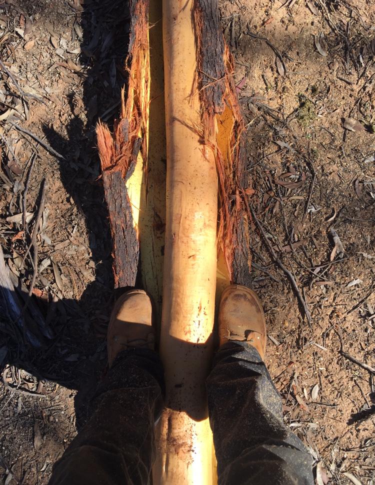

When we use them to, raise/drop/raise/drop along to cut the line instead of chainsawing a line it shock/pops the bark up for approximately 25% of its top circumference, once top opened we just lever and peel off like a bark canoe. The photos above weren’t very elegant as was butchered testing all sorts of angles, walloping, scraping exhaustion [emoji51][emoji23]
A little Red Ironbark lucky example of using my boots a few months ago with an 8kg too heavy all day crowbar to firstly cut the top popping line:
http://www.nissanpatrol.com.au/forum...021/06/142.jpg
Shocking definitely works AVO Mate[emoji106][emoji106]
Disclaimer: Only when the sapwood is seasonally running, Summertime no chance of this [emoji51]

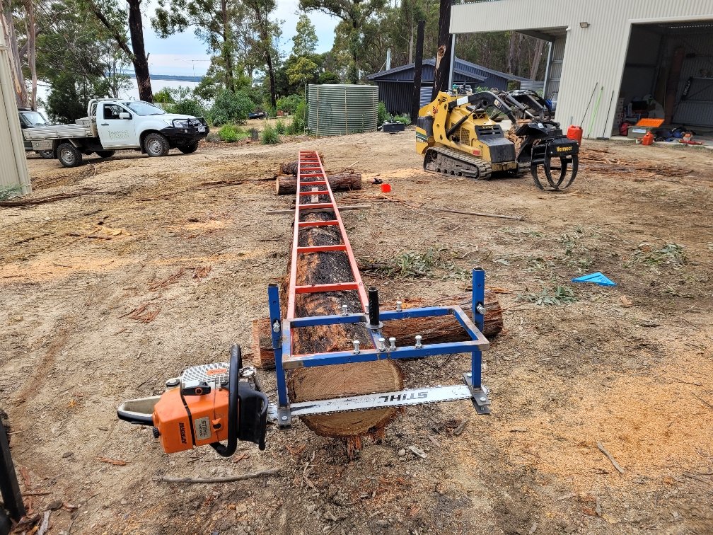

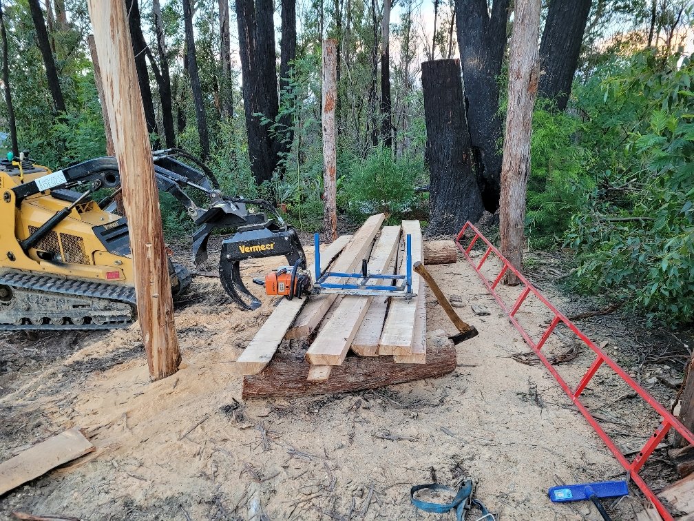

Got to try out home made Alaskan style mill over last couple of weeks. . Very happy with how she went, dropped one Yellow Stringy and grabbed anther nice log from next door to mill up some chunky rustic boards with live edge to build a fernery for the folks up at Coota. . http://www.nissanpatrol.com.au/forum.../2021/07/4.jpghttp://www.nissanpatrol.com.au/forum.../2021/07/5.jpghttp://www.nissanpatrol.com.au/forum.../2021/07/6.jpghttp://www.nissanpatrol.com.au/forum.../2021/07/7.jpg

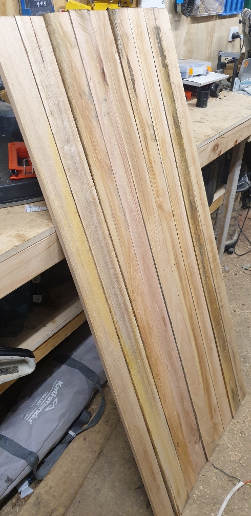

Do this week I've been trying to buy some proper dust extraction for my larger tools(thicknesser and table saw) however I was advised reducing the intake with reduce the suction dramatically and would make the extractor useless(yes some here have suggested the same before too). So tonight I came up with this.
It's a 44 gallon drum I had laying around, I set an intake and out feed on the lid and jeezus! Works like a charm. Not a spec of dust in the vaccum, and heaps of chips in the drum. Thrilled with the end result.
Yes my shed is a pigsty at the moment.http://www.nissanpatrol.com.au/forum...2021/07/74.jpghttp://www.nissanpatrol.com.au/forum...2021/07/75.jpghttp://www.nissanpatrol.com.au/forum...2021/07/76.jpg
Does the top come of that drum? Looks like it would be easy to line it with a large bag that you could empty easily [emoji106]
Top mod!
Also that timber has come up nice [emoji106]
