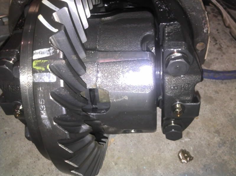

Their are three different gq rear diff centers look at an early gq lsd totally different to the later ones the one i pulled out of my 97 gq is a 4 pinion with sungears. and the h260 center easy to spot it has 12 bolts holding it to the housing instead of 11 and is huge.
The one i removed from mine looks like this.
http://i207.photobucket.com/albums/b...nceGU05/gu.jpg
and this is what the earlier ones looked like
http://i87.photobucket.com/albums/k1...-57-17_749.jpg
