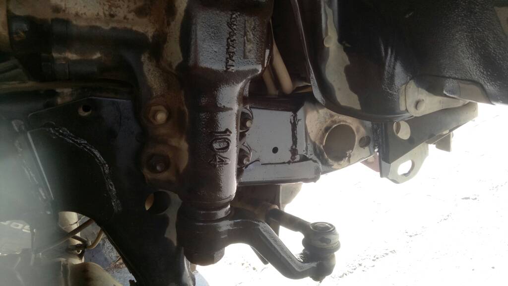

Thought I'd fit the radius arm spacers today ...
Lucky I started on the passenger side.
Spacer in. And axle fouls on the Panhard rod.
F*** a duck.

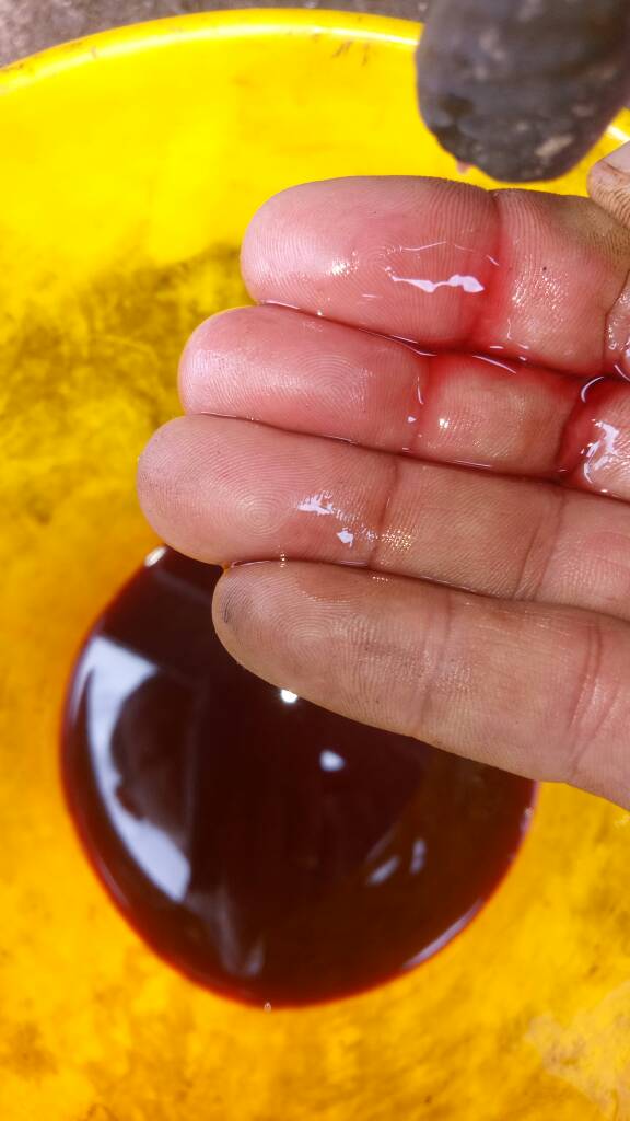

So if I get that line and block it off before it goes to the reservoir, then start engine and continuously top up the reservoir unti it comes clean out of the same line.
Sorry if it doesn't make sense, it's a bit hard to explain, but I think I've got it right in my head.
Well kind of. Grab the line that goes into the little tube that comes out the side of the reservoir. Take this off and place into a bucket. Disconnect fuel solenoid as the pump will pump quicker than you can fill if the engine is running. Crank it a little and top up fluid with fresh stuff until its clean out the return line.

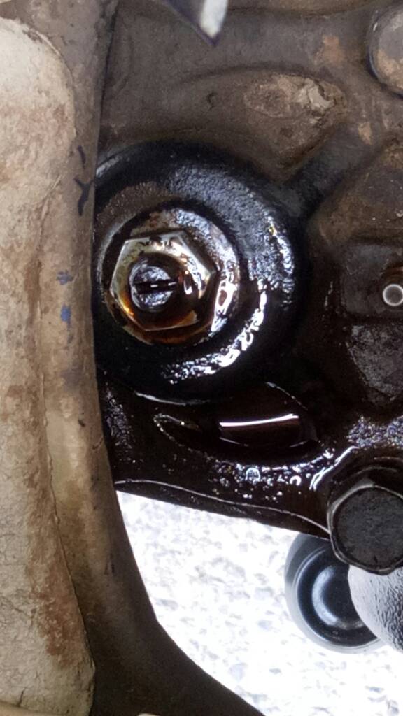

Well I done that, oil looks like it has gone through coming out the return line red as the new stuff. So why am I getting this leak of dirty oil coming from the threaded shaft on top of the box.http://www.nissanpatrol.com.au/forum...2018/11/19.jpghttp://www.nissanpatrol.com.au/forum...2018/11/20.jpg

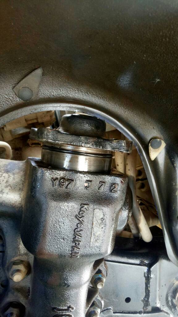

Does anybody know what's under this plate. Can't seem to find it, not even in the manual.
Thinking that there has to be a o ring or something. http://www.nissanpatrol.com.au/forum...2018/11/21.jpg
Your thinking is correct. Looking at this drawing you should not have power steering fluid at that adjuster. Looks like the box needs a reseal. The oil will be dirty from the grease in there hence the grease nipple. Attachment 76803
Well that thread screws down. Problem is the whole box needs to come out.
Might put it back together and just regease it for now.... http://www.nissanpatrol.com.au/forum...2018/11/22.jpg
I've got wheel bearing grease, will that be alright?
Basically that gap in photo is WITHOUT spacers and is 5mm max. Spacer is 10-12mm.
Unbolting the arm and pushing diff forward that 5mm fouls on the panhard rod. Does not want to go any further.
I might have another go tomorrow.
But, I'm not sure it'll work. Mudski reckons take off the panhard rod on that side, fit arm and spacer and tighten up the rod and see.
So, weather depending, we'll see what happens.
Quick google reveals I am not the only one. And the superior product page mentions this as well.
http://www.nissanpatrol.com.au/forum...id=76806&stc=1
Mine GUIV 2" lift / 2 Deg caster correction and provides 9-10mm gap/clearance (rod to brkt side face). Do not know your lift / or correction (if any). IMO, if lifted w/o caster correction, clearance would be less. Caster correction lifts caster bush center up therefore rotates axle housing top/brkt to rear increasing clearance between Panhard rod and brkt located on axle housing.
Forgot : No Radius Arm spacers fitted / or mud flaps... lol.
OK, same as mine and similar clearance.
Do you have adjustable panhard rod? Mine is OEM stock and have noted that the passenger side wheel axle center is positioned approx 40mm closer to the guard face where flap mounts as compared to the drivers side. This could be caused by the lift and the fact that I still have the stock panhard rod. This has not caused any drive or tyre wear issue it just annoys me. I am not sure how the axle alignment changes with corrected panhard rod length to suit lift.

After putting the streeing box back together I left it alone. Today I went for a 15min drive focusing on turning. Got back and had a look.
Dry.....
http://www.nissanpatrol.com.au/forum...2018/11/26.jpg
