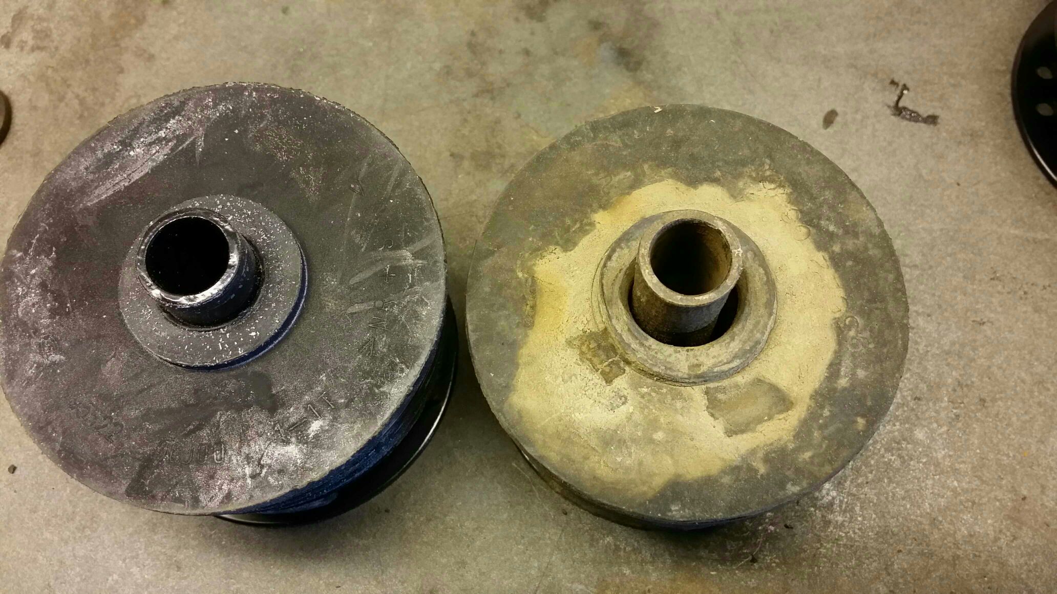

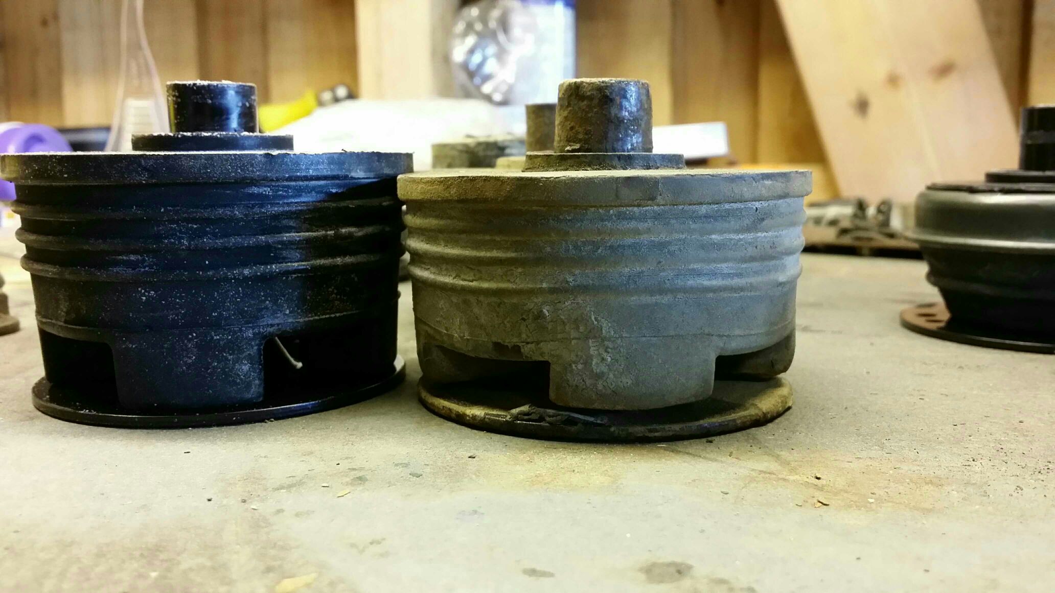

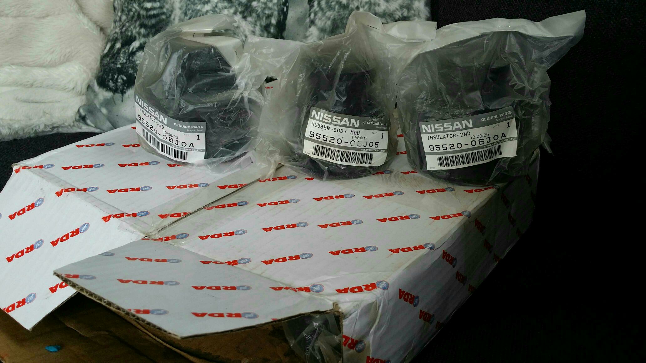

Hey guys! Look what i've got in the mail box from Patrolapart ☺ http://www.nissanpatrol.com.au/forum...015/06/264.jpghttp://www.nissanpatrol.com.au/forum...015/06/265.jpghttp://www.nissanpatrol.com.au/forum...015/06/266.jpglooking forward to get them on the car :)
Coming along nicely Roesen...good job

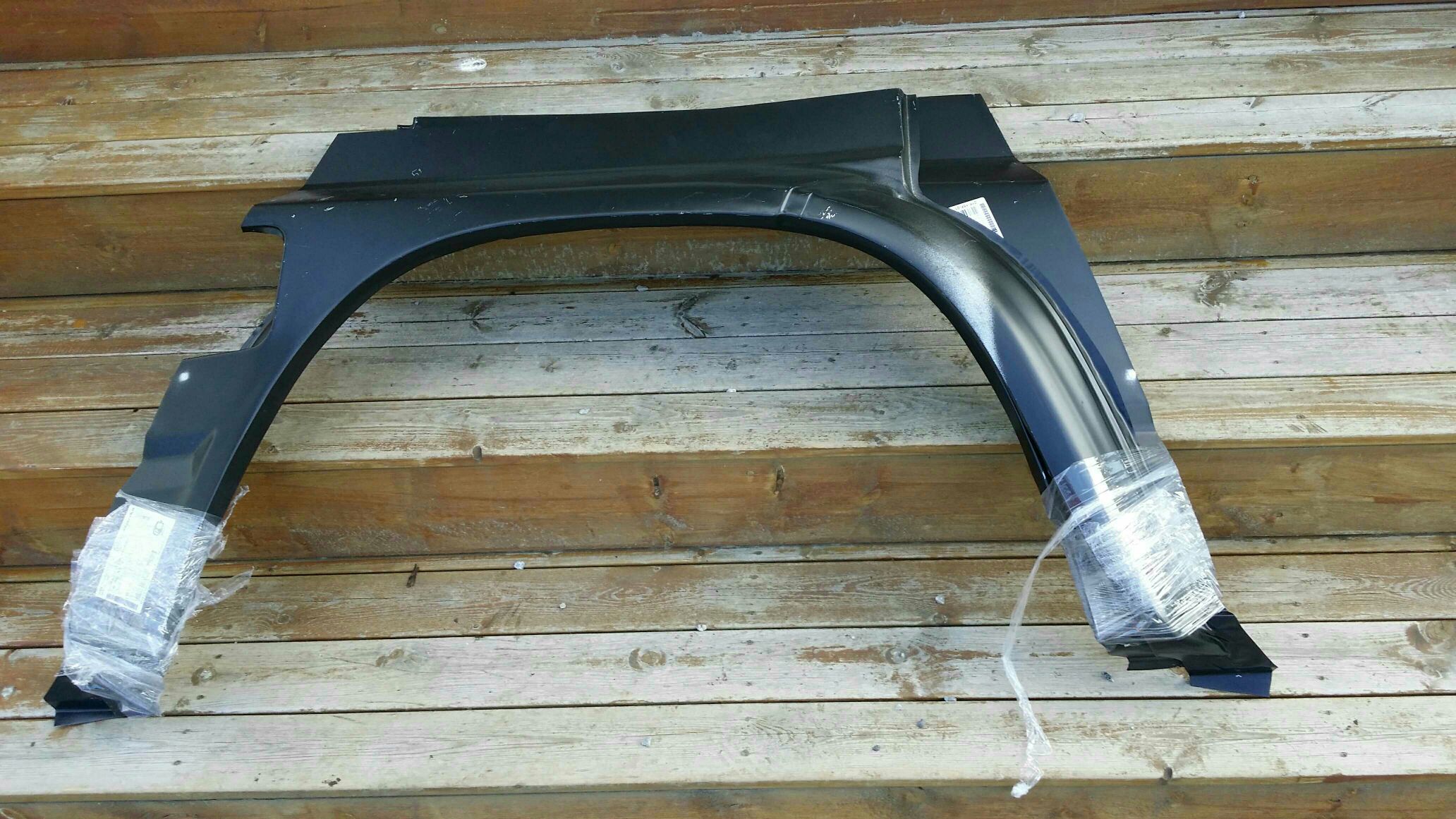

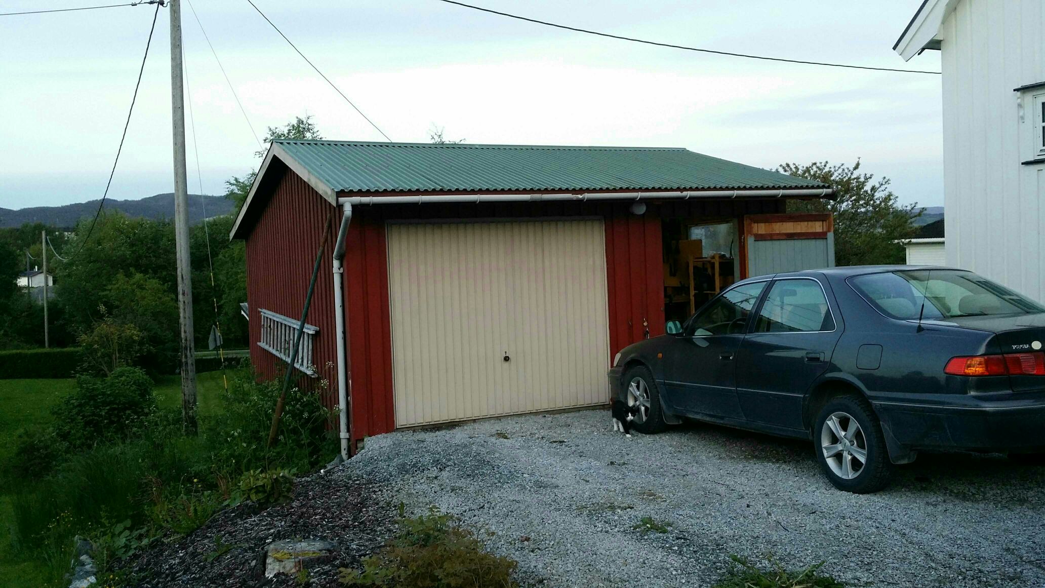

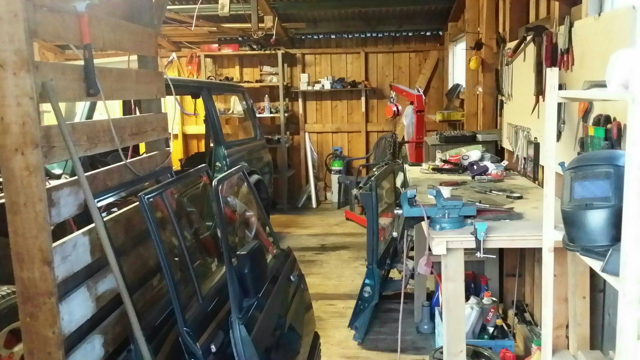

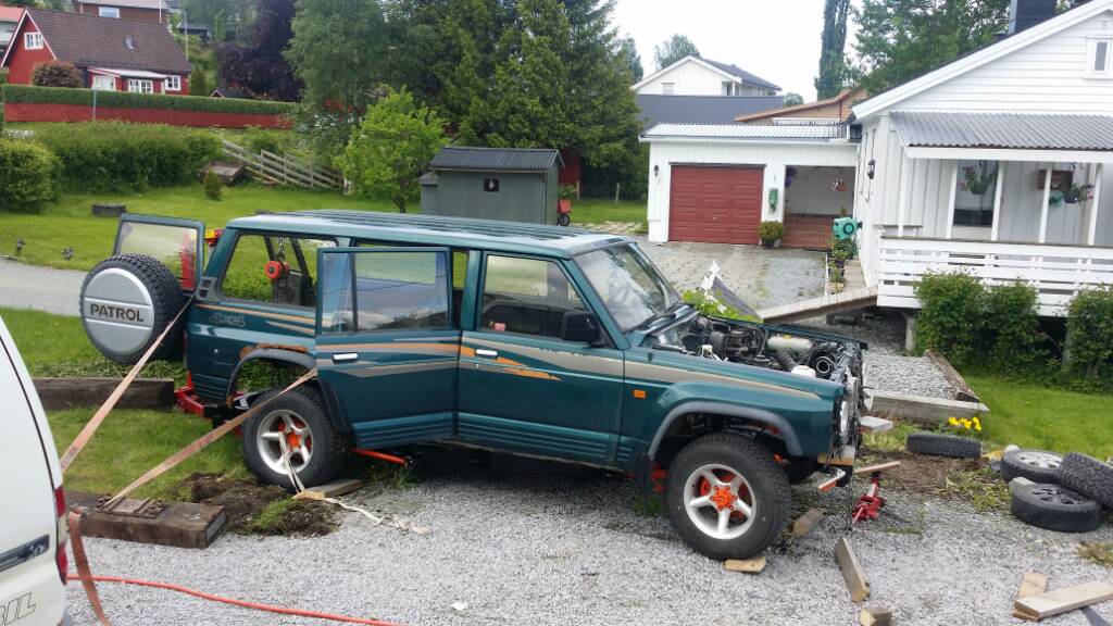

http://www.nissanpatrol.com.au/forum...015/06/297.jpgthank you guys! It really took me some big thinking about how to get the body inside my small garage. Finally i got it in and the rear fenders also arrived this morning:) welding starts as soon as i have cleaned out the garage :)http://www.nissanpatrol.com.au/forum...015/06/298.jpghttp://www.nissanpatrol.com.au/forum...015/06/299.jpg i have the plans ready for a new garage 70 dquare meters big. But all the money goes to my patrol 😎.

Love watching this build take shape.

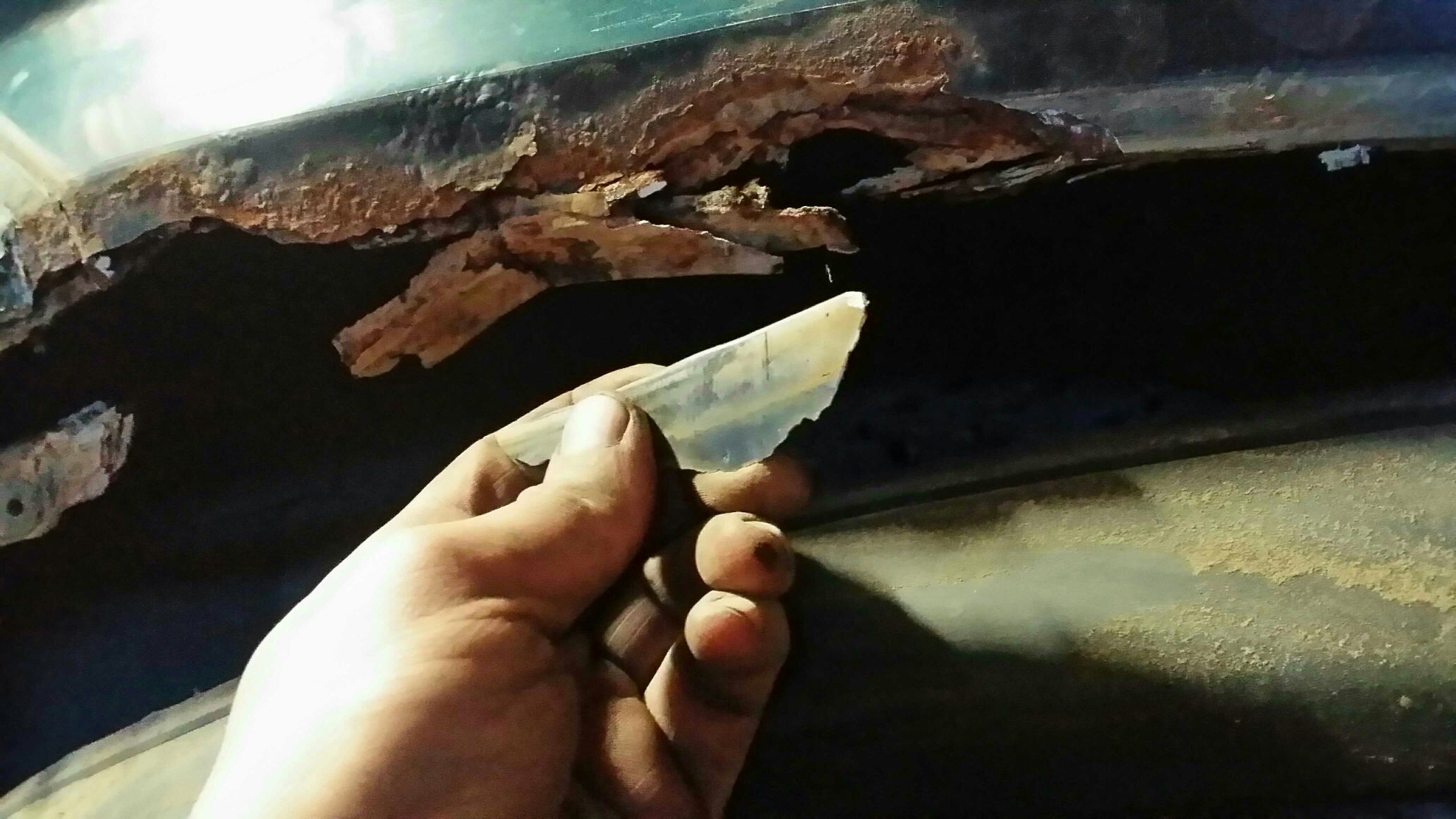

Hey look! Some earlier owner has apparently tried to ment the fenders with some stuff that didnt work😅http://www.nissanpatrol.com.au/forum...015/06/300.jpg anyway, her is a picture of the disambling: http://www.nissanpatrol.com.au/forum...015/06/301.jpghttp://www.nissanpatrol.com.au/forum...015/06/302.jpg i think the will to get a cool Patrol is stronger than see the limitations around, like the size of the garage ☺ if you want it, you get it :)http://www.nissanpatrol.com.au/forum...015/06/303.jpg

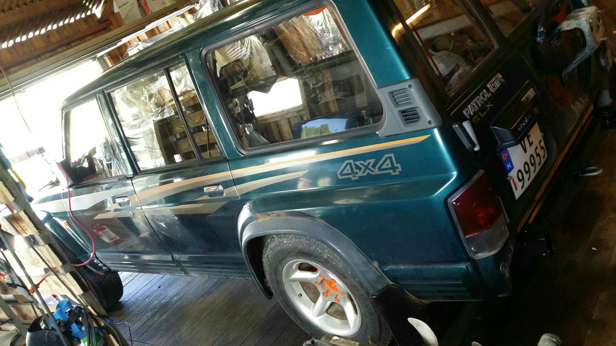

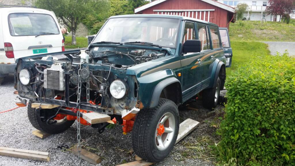

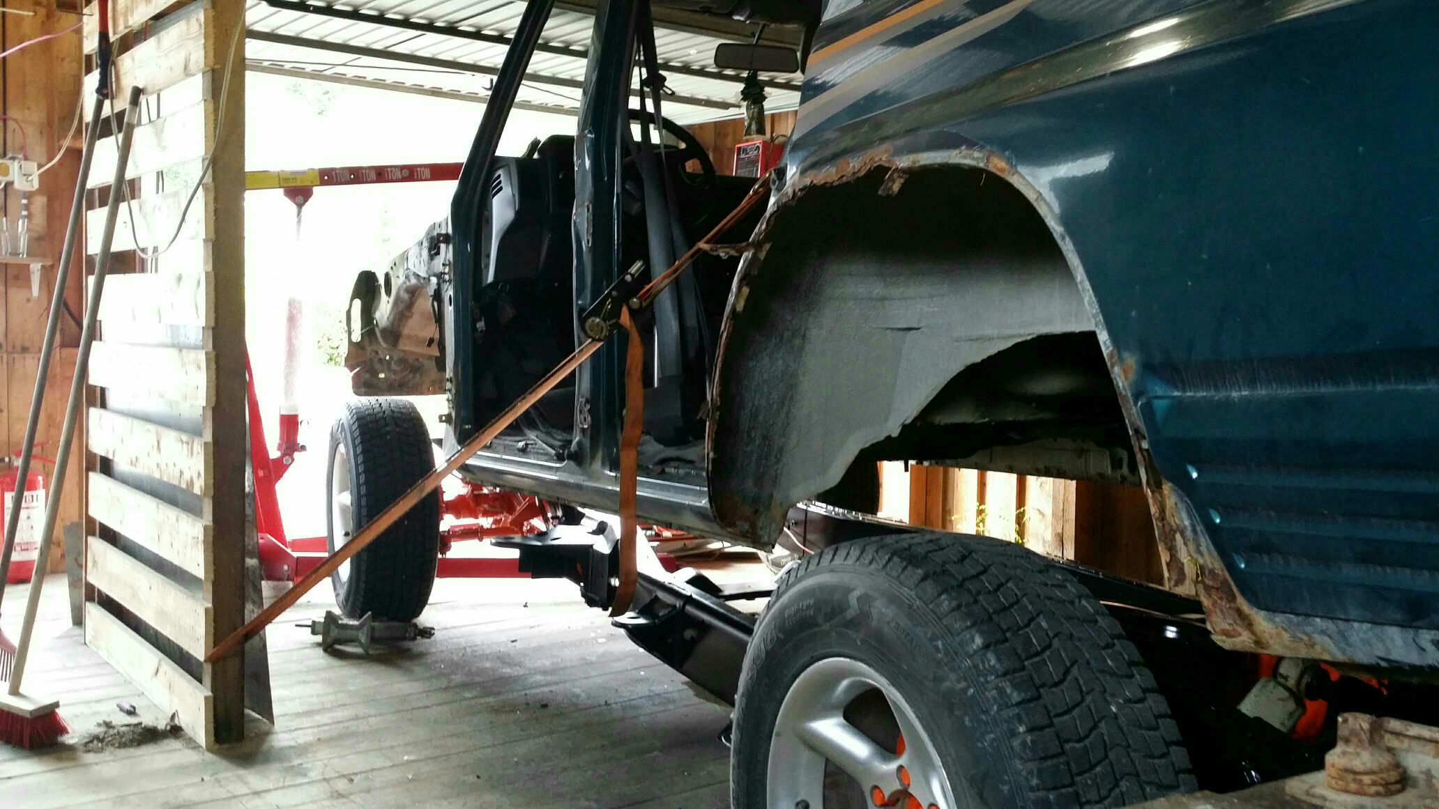

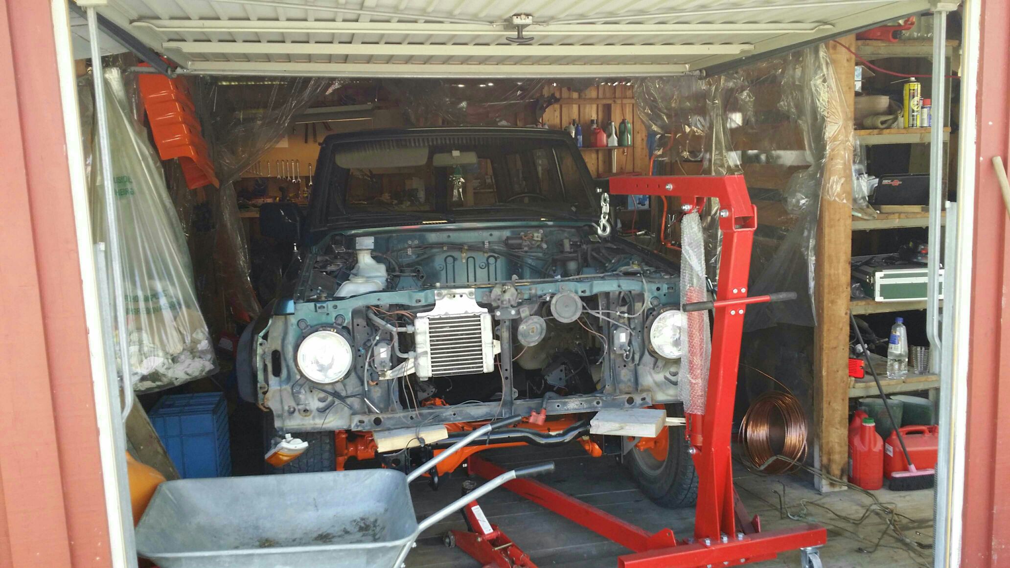

Now its time to remove the frame from the body again so i can work with the body in my garage. Have to do some welding in the floor and i dont want to damage the frame:)http://www.nissanpatrol.com.au/forum...015/06/347.jpghttp://www.nissanpatrol.com.au/forum...015/06/348.jpg

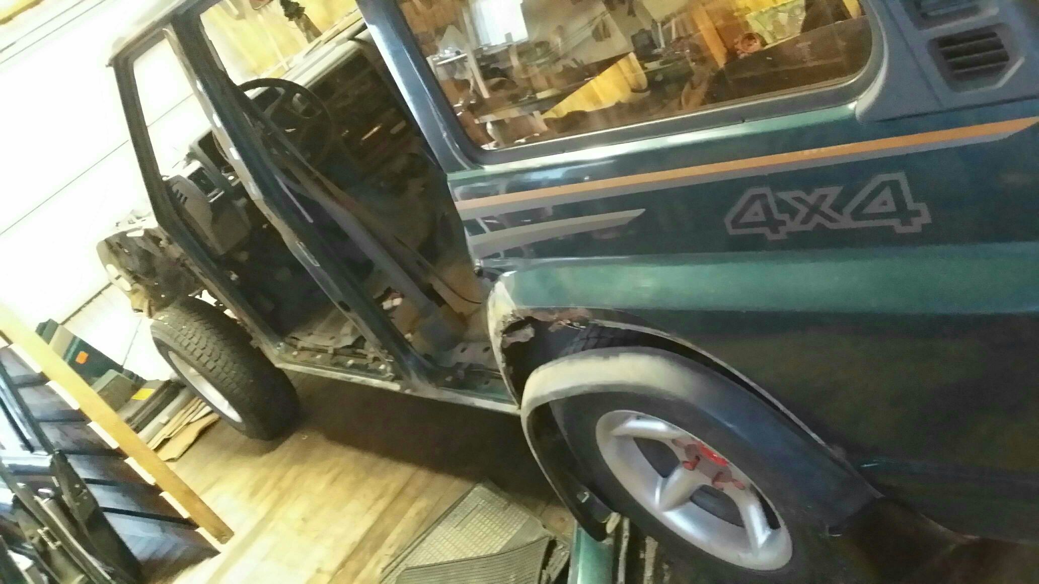

Progress! First cut on the body:) http://www.nissanpatrol.com.au/forum...015/06/400.jpg

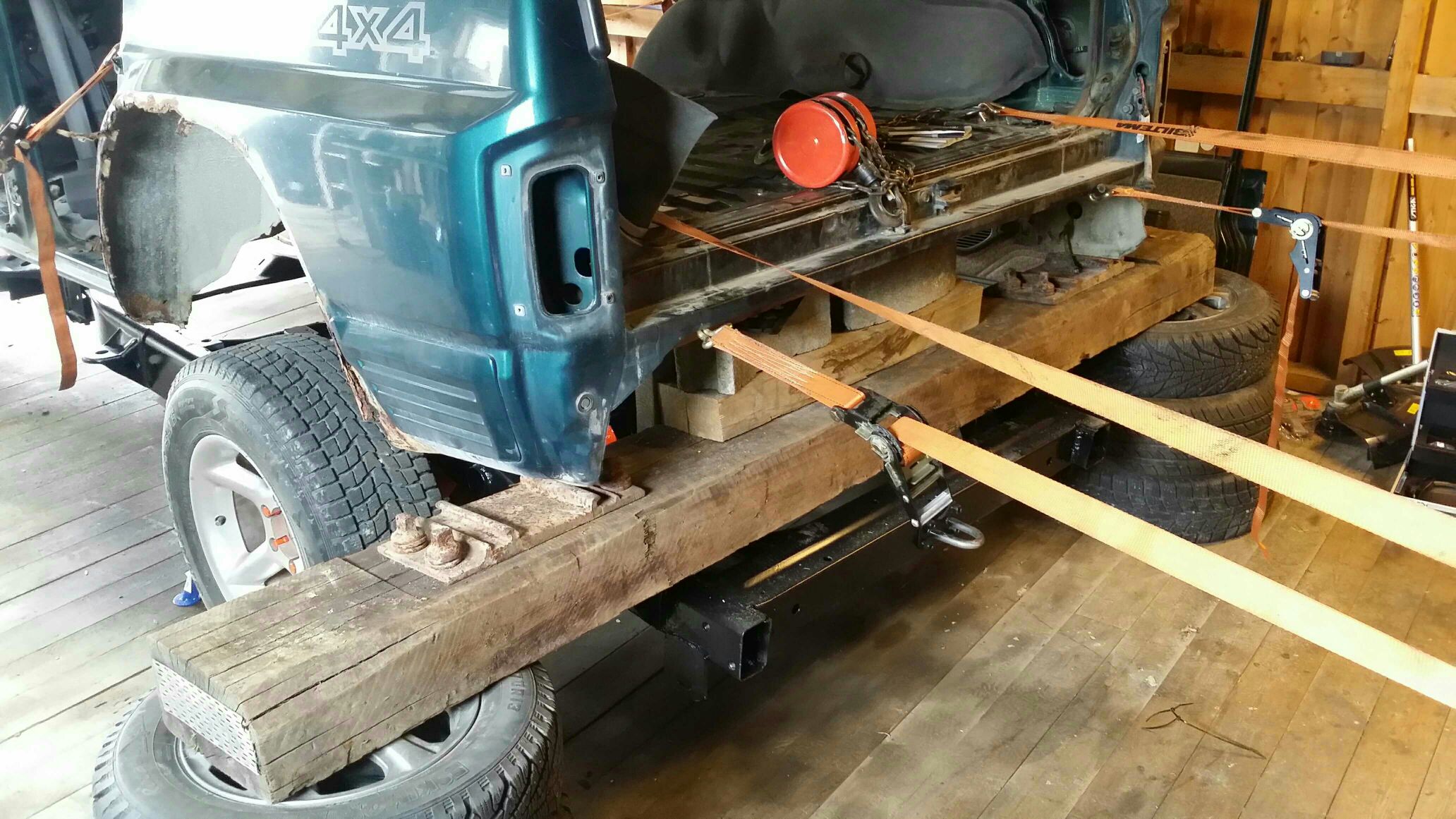

anyone else notice that you are using what looks to be a railway sleeper to hold the body up? haha they are bloody heavy!!!
