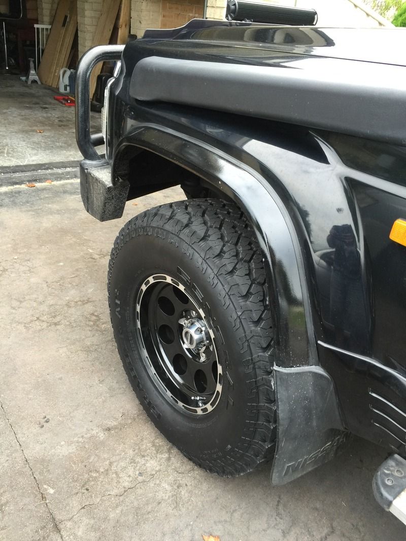

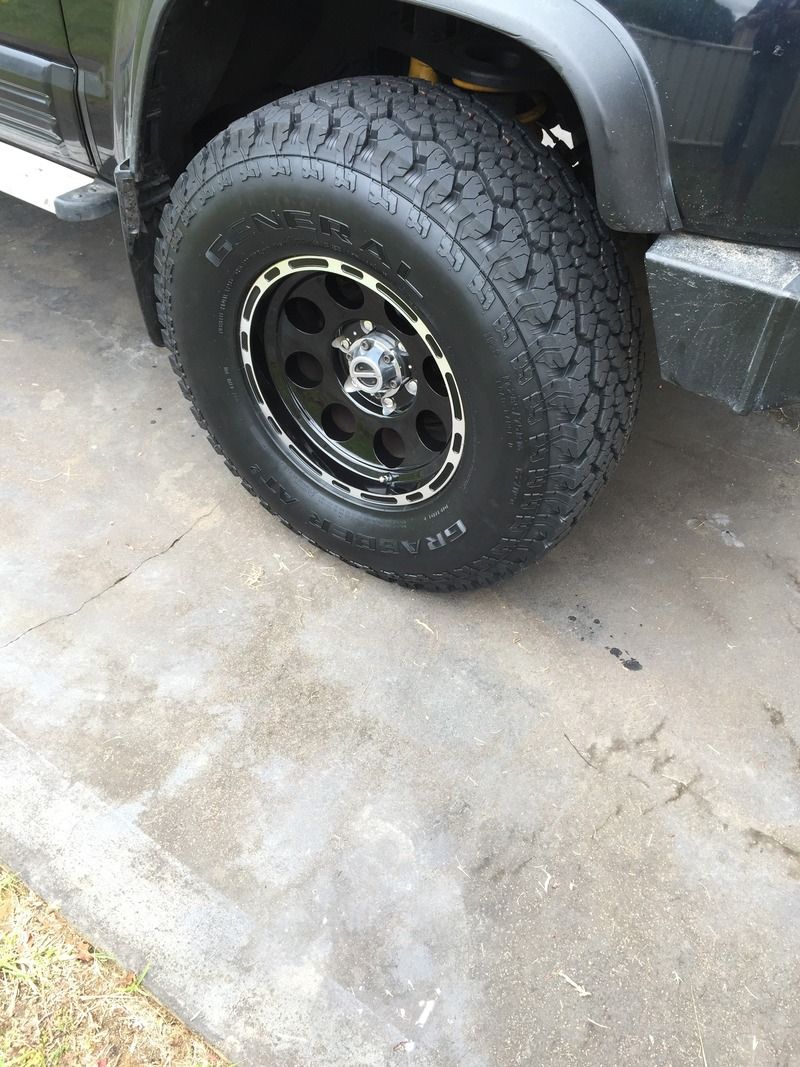

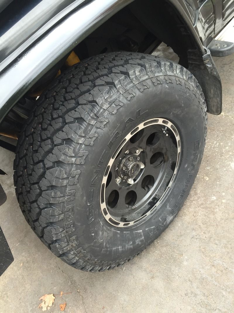

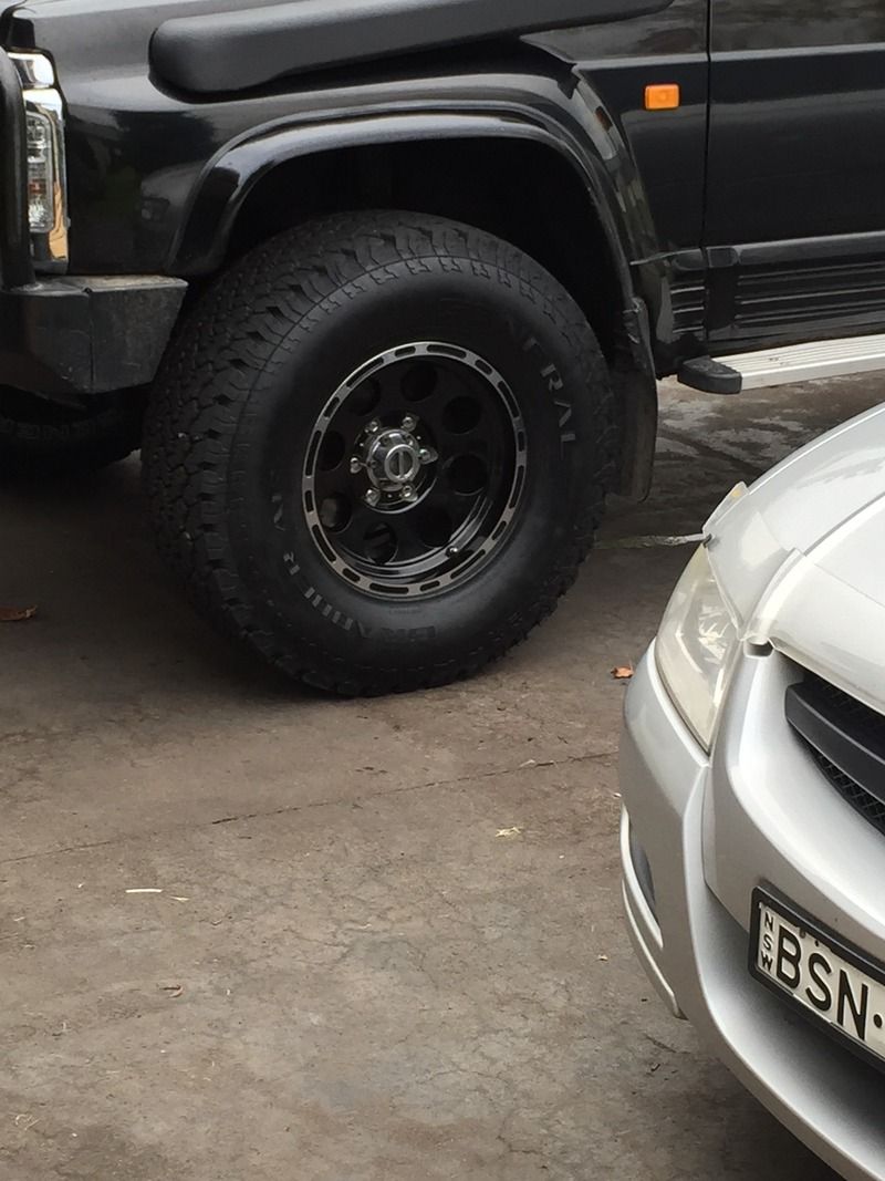

What did you decide on for new boots?
Disregard, just read your other thread
Went with General grabber AT2. Slightly aggressive looking AT tyre.
http://img.photobucket.com/albums/v9...A17E1C8466.jpg
Haha you guys are soo funny...
Is it sad that I've already considered painting them??
Very similar to the BFG A/T but with extra snipes,
nice and quiet and plenty of miles Im guessing.
I like them a lot, and do the hubs eh very sloppy
Or polish them just to be differeny
