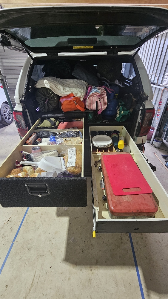

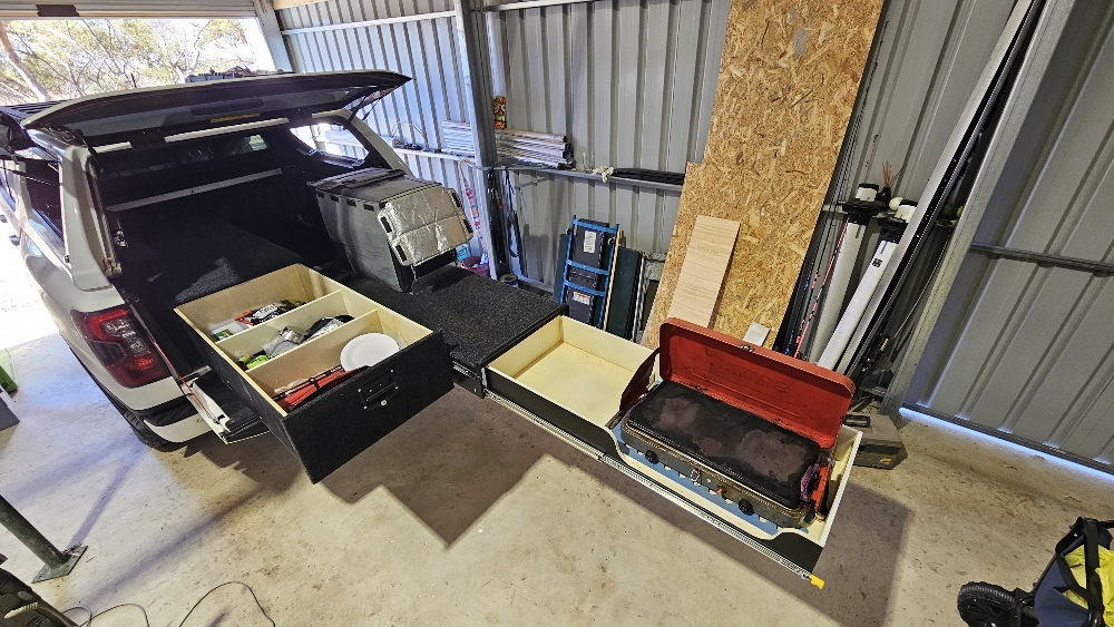

    So after running the removable table idea for a bit I got frustrated quickly with it. The legs kept dropping down and jamming in the tailgate gap.
    So ripped that idea out and flipped it.
    I raised the fridge slide about 80mm, and built a draw for under it to house the stove and cutlery.
    I'm glad I've done this as it's so much more usable now as a all in one system..

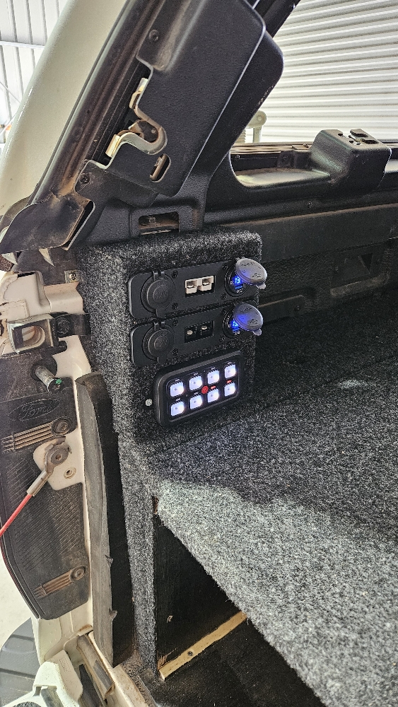

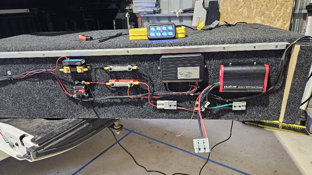

    I have also put in the majority of the electronics.
    I've used a 8 way switch gang setup.
    The main fuse panel is on the side of the draws, with the buttons up top.
    Best bit is its blue tooth so I can switch lights off from the tent lol.
    Also a bit of weight reduction in the last pick..

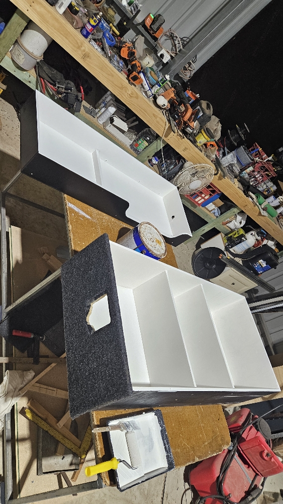

    Looks good mate, Did you cut those bottom holes to shed weight or drop a sink in? Mine is a fair bit heavier than your i reckon! LOL I am going to go hard with a 150d hole saw anywhere i can to save weight and just cover with carpet. I wont be able to shed heaps but any will be a winner. Thank god for airbags! lol

    Reduce weight.
    That panel is the floor which is bolted in.
    And yea I used 12mm structural ply. It going be a lighter than formply lol.
