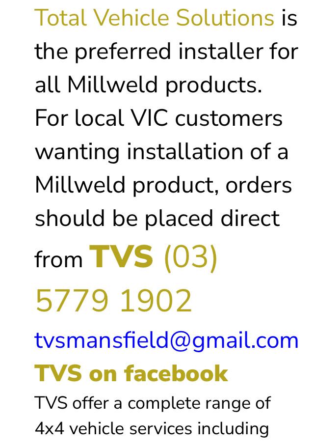

    Has anyone got a contract number for them. I've sent them a Facebook message and an email through their website, but would like to have a chat with them first..

    Cheers Mark.
    I did see that, but wanted to speak to millweld directly. I'll call tvs and see if they can get me through.
    5741 9112.

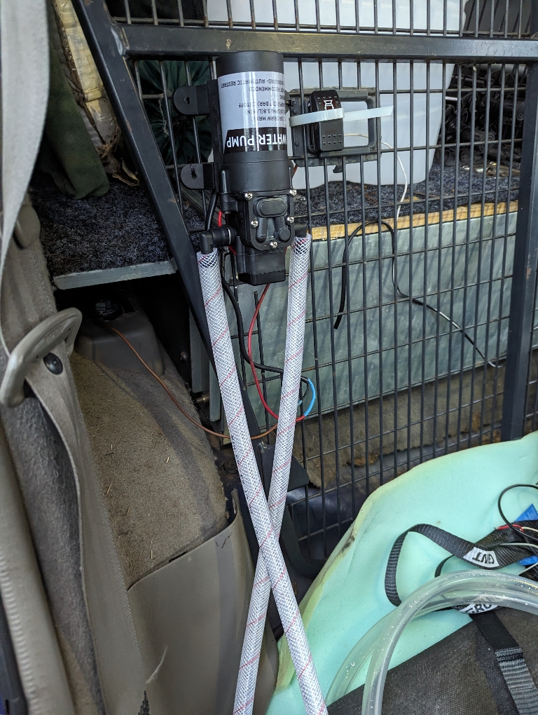

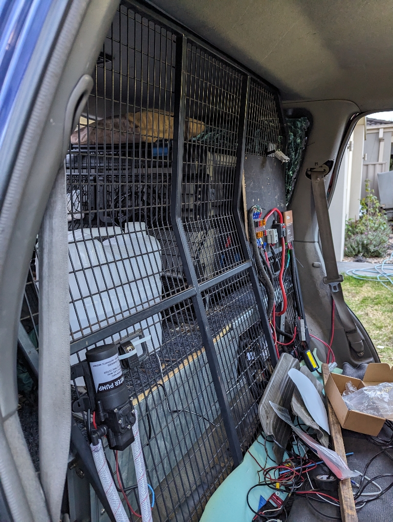

    So I picked up a cargo barrier off marketplace for $50. Man what a mission. In the end I had to remove the backing of the fridge cage and work out how to mount the bottom of the barrier. Then make up brackets to mount the top and reposition the electrical components as they now sits higher. A fair bit of mucking around because of the draws, but it's now securely in place. I've had to spin the freezer 90 degrees as it didn't fit.
    Managed to also fit a water pump and plumb it to the tank, because of the design it has 2 outlets one on each side. I plumb both sides to one and then to the pump. Didn't quite work, am I asking too much from the pump?

    The diaphragm pump has a poor suction capability, which is why they only rate the discharge head. You will do better lowering the inlet of the pump to the same level as the tank outlet, then it should work fine.
    Thanks.
    I did try it at a lower level, but probably not long enough to get the air out. It was late and I was getting impatient I will give it another go on the weekend. The bloody shopping trolley is playing funny buggers, just out of the blue it gets irregular revs then stops, starts up fine and keeps going. Did it twice this morning within 15k out of a 45k trip. Ahhh,
