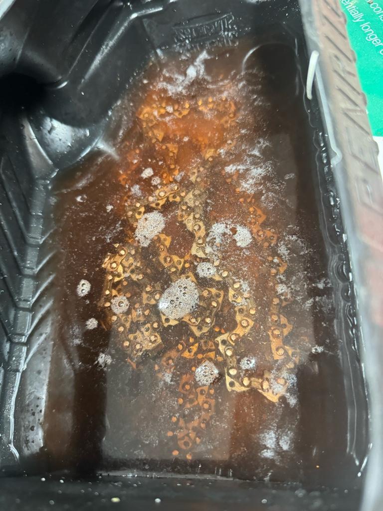

    So after a big session with my saw gutting wood, in particular green Stringy Bark I have found. The chains gum up with hard black crap and it was a pain to clean off. Until I found out that if I soaked the chain in water and a sprinkle of drain cleaner, after a light scrubbing with a brush, they came up like they’d never been used before. Unbelievable! I’m probably the only person in the world who didn’t know this but it works really well.
    Just thought I’d share in case I’m not the only person living under a rock.

    I have found different timbers do different to the chains. Last weekend I spent 5 hours slicing up a fallen mountain ash. Its wasn't dry timber, the chain was still pretty good. Cutting wet Stringy bark, which has that real dark, almost molasses look to the sap, bakes on the the hot chain and refuses to come off. Using the drain cleaner cleans them up no worries.

    It doesn't need a lot of drain cleaner, just a light sprinkle and then let the bubbles do their thing.

    If it works go for it I say.
    But once out the water throw it in a zip lock bag with some bar oil and bath it with lube for a week.
    The draino will be stripping all oil out of the pins and I feel like it'll wear out quickly..
    I usually store the sharp chains this way to so they are lubed ready to go in the field.
