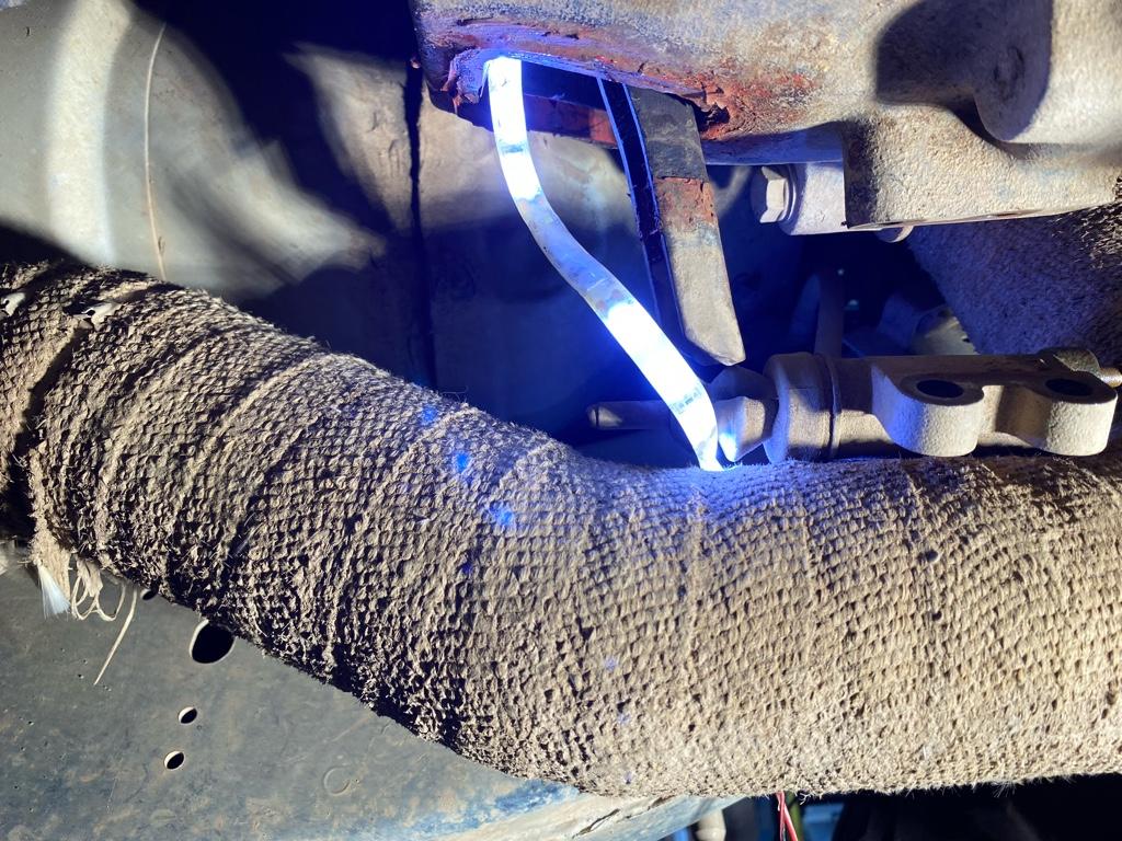

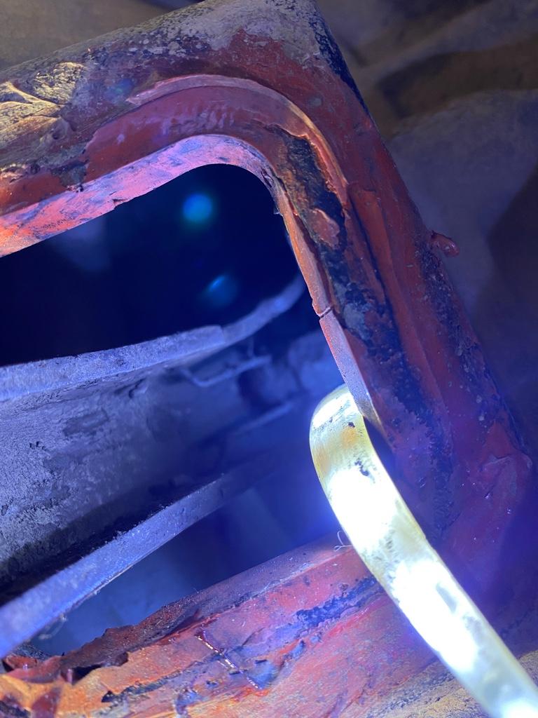

    Righto! So all happy. After lots of googling on patrol sqeaky clutches, the general consensus says it’s the pivot ball. Hmm.
    Not being able too see much in there, I found some led strip light, wired it up and stuffed it into the bell housing .
    Worked a treat. I could see clearly in there. And then I used my wheel bearing greasing connection ( it’s like a flexible needle point) for my grease gun which reached the pivot ball no worries.
    This silenced the clutch no problem!
    Happy days.

    Good one mate! I must try that next time I have the GU at home.
    The first look I had at the picture I thought you had stuffed those party necklace things into the bellhousing LOL. That would also be genius!

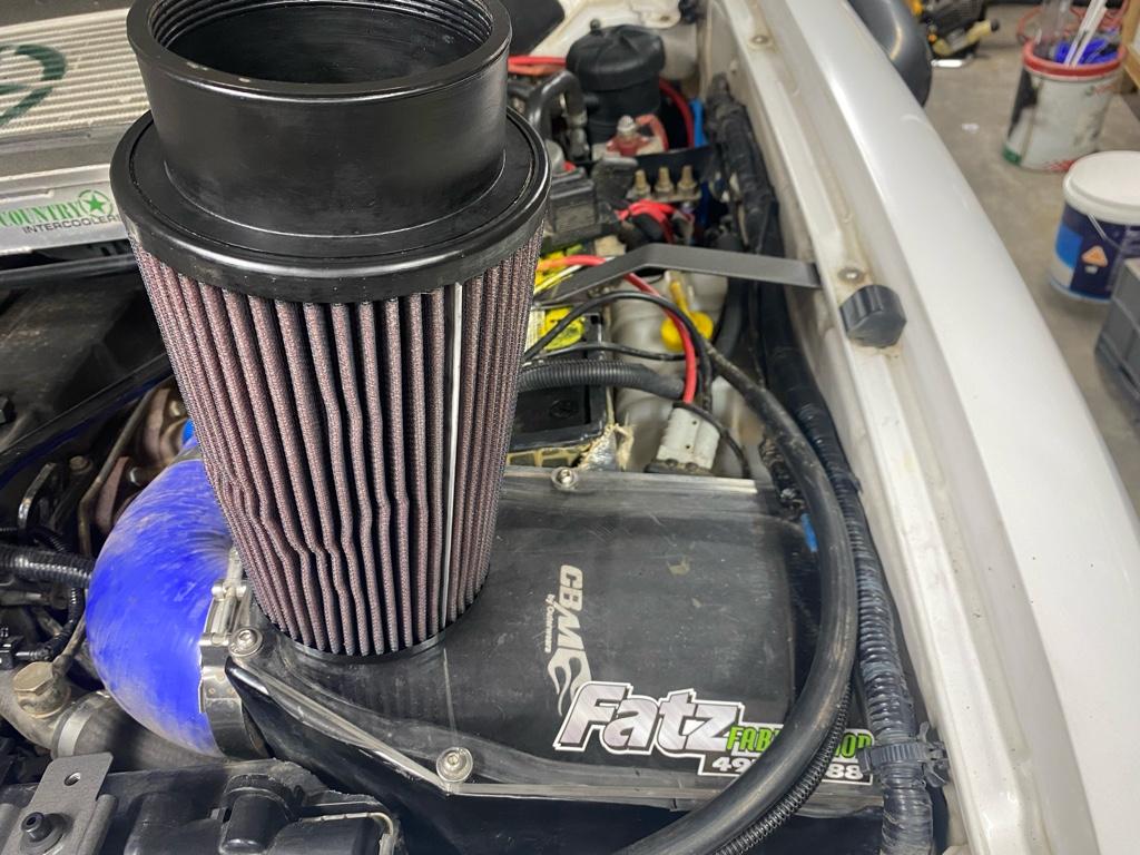

    Seriously thinking of ditching this Fatz Fab air box too. I should never have bought it. I should have gone the flat panel design over this. As this thing would barely do 5k in travel a year, and oiled air filters don’t like sitting around, they will lose their filtration efficiency.
    So I might look around for a better setup soon.
