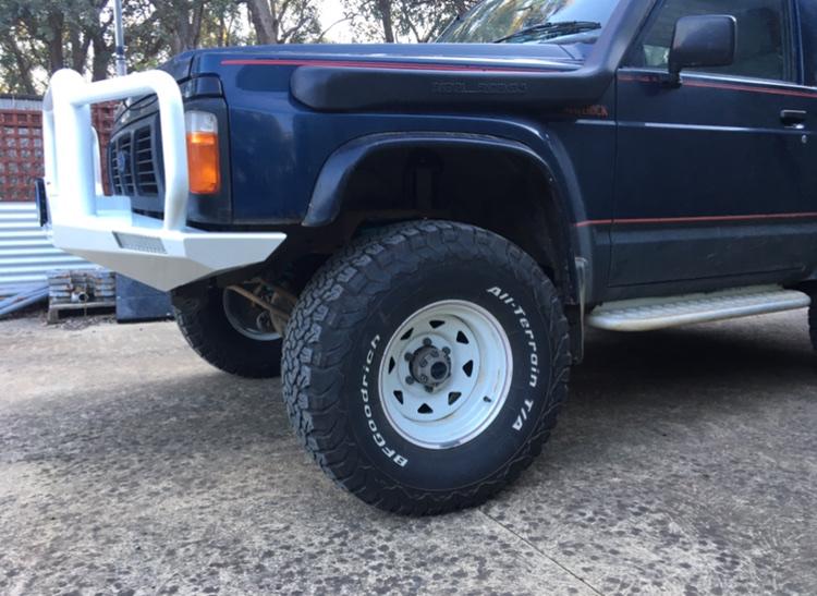

    Steel bar on, minus the winch and managed to score 615mm exactly
    To achieve matching rear uni joint angles on the shorty tailshaft for exactly 580mm unladen height took 12mm of purchased gearbox crossmember spacers each side and installation of adjustable upper control arms to shorten their length from OEM 400mm down to 375mm in the end.
    I’m not 100% sure the 565mm front and 530mm rear factory ride heights for GQ’s is correct? This little thing looks like a jacked up Ford Bronco now

    You’ll be ok on your travels mate but it looks like a beast now!
    Phil, that arm ain’t coming back now lol
    Loving how that shorty looks now MB!
