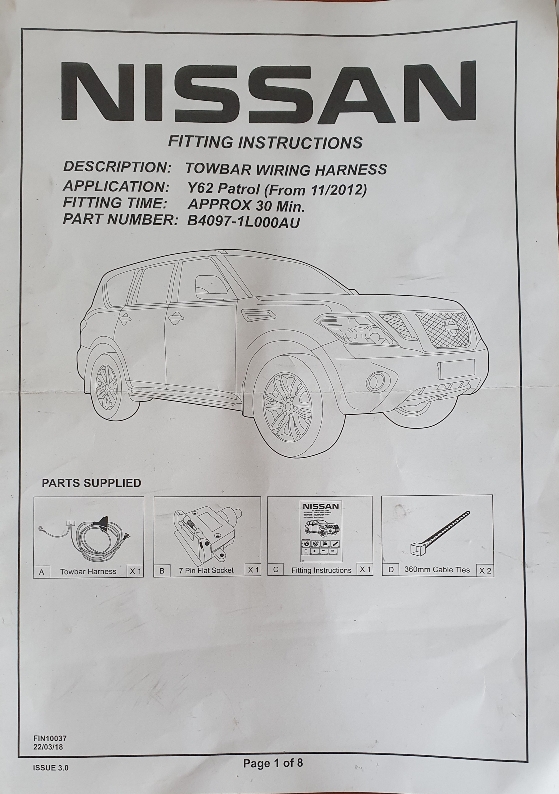

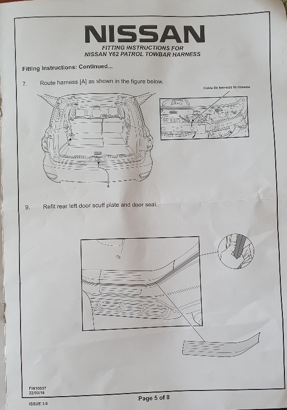

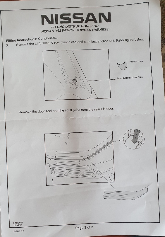

    So here is the factory Loom part number and bar code

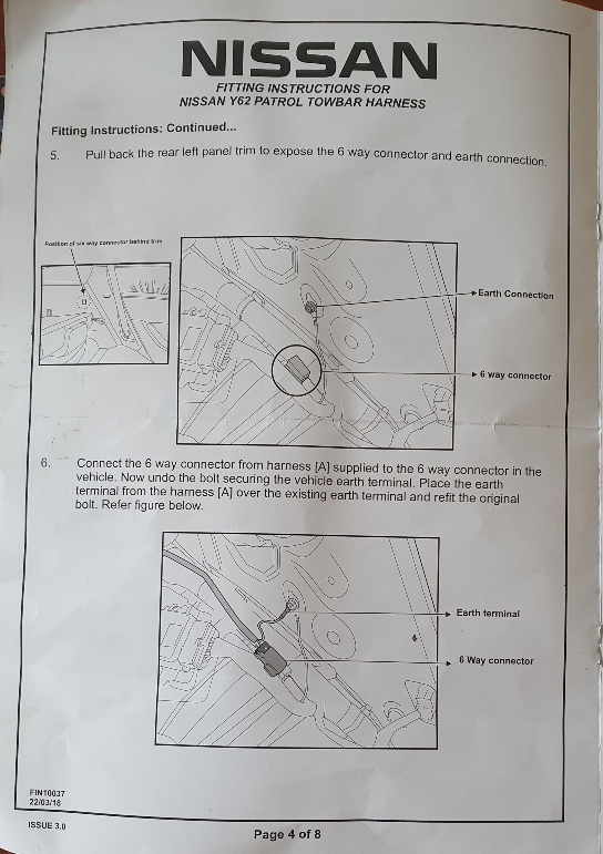

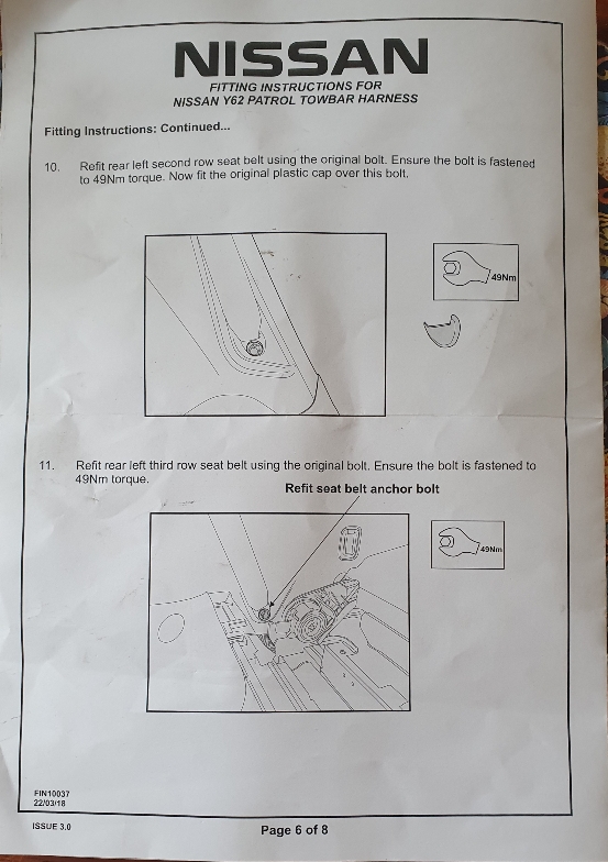

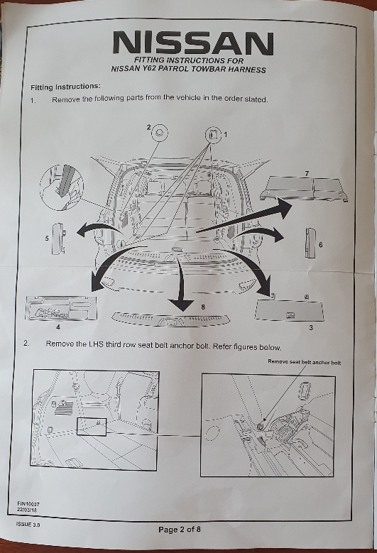

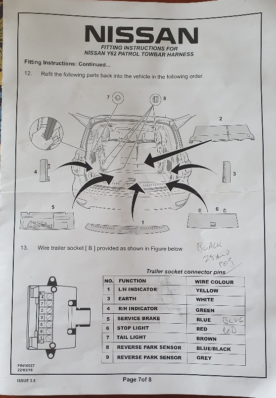

    These instructions are very important. Especially the strip out and refit order.

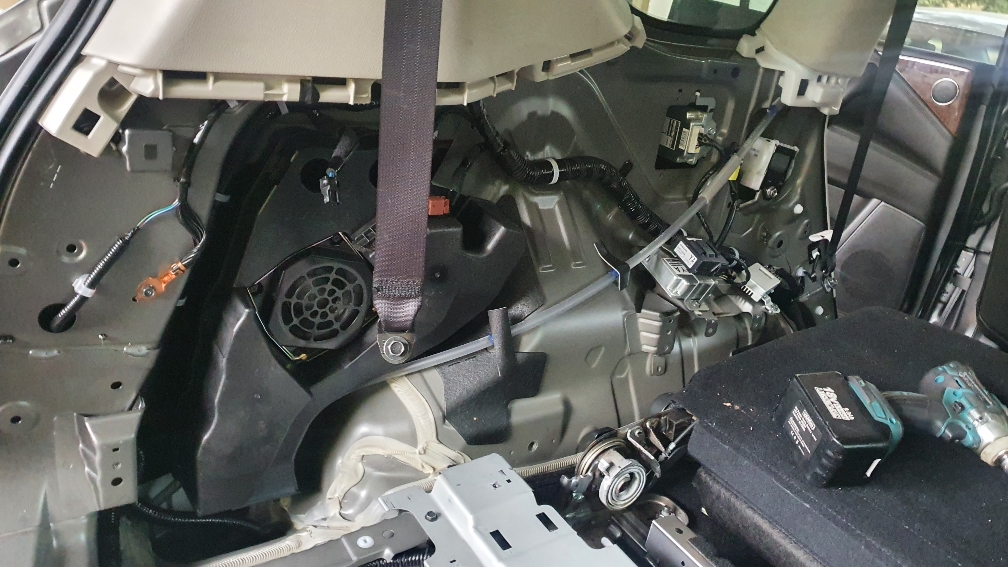

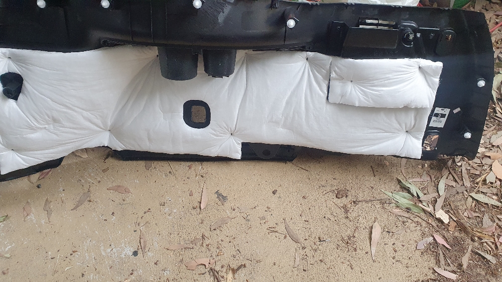

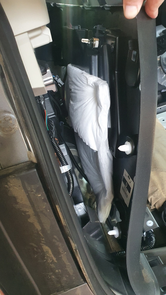

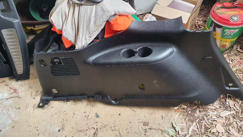

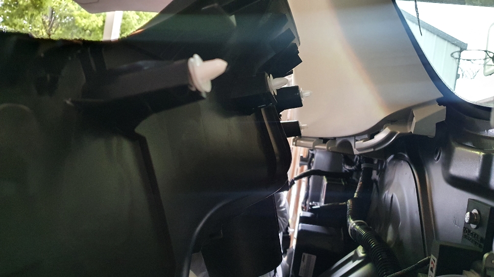

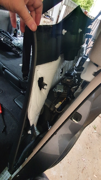

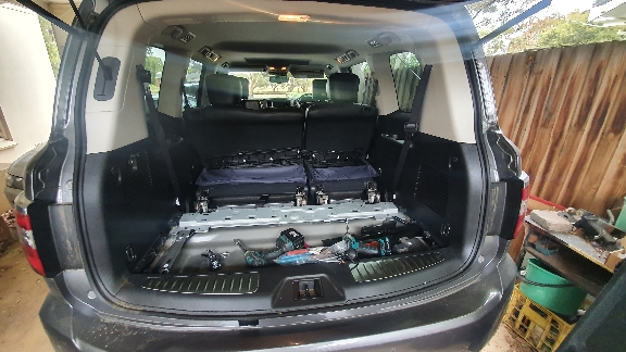

    The instructions missed this part but this whole side trim really does need to come out.
    You can see the clips in the photos that you need to pop. Release rhe front from the rear passenger Door and the rear edge from the back. Then get into the back and grip the cup holder area and give it a big pull like your trying to crack a whip. Don't just hang off it. Shock Pull and it will come off.

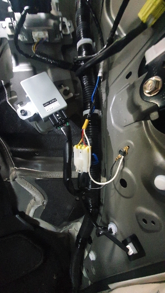

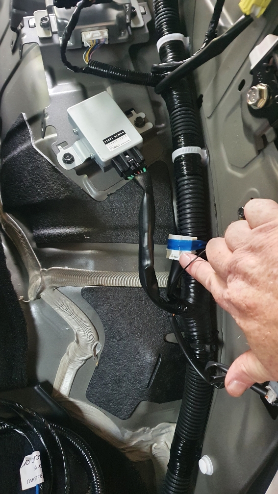

    Here is the convenient Factory loom plug waiting for you.
    Plug and Play
    The loom is EXACTLY the right length. No room for nicely laying it around. You have not got an extra 10mm!

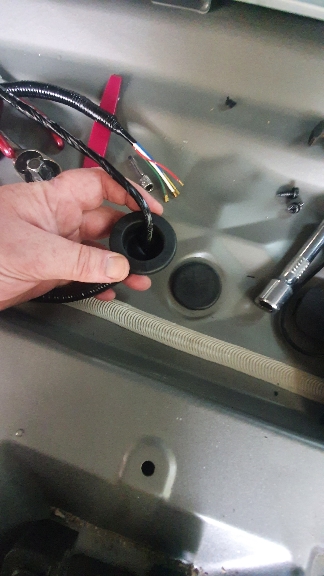

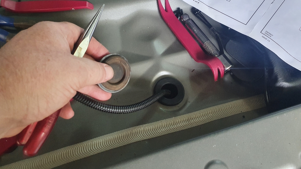

    Here is the grommet you remove ans replace with the loom grommet.
    Pretty nice to see the sound deadening

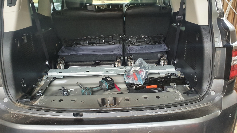

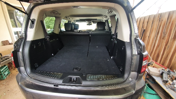

    And here is the factory Sub Woofer in the TIL
    Ok. Back to the top now and take note of the reverse order install of the rear panels you have removed for this job.
