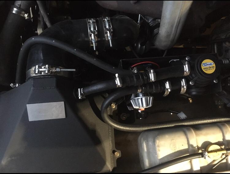

    Snuck a couple of insomniac hours in on the GQ this morning before school runs
    Plumbed the new Catch Can & mini ARB locker compressor finally into the fresh air Black Mamba airbox

    @MB, I dont think the insulation I have is going to work that close to the heat source - its going to melt - best look at something else I think

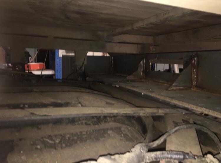

    Rear winch cradle beast is finally test bolted into position tonight, need to plumb up the new coil inner airbags ASAP as old Grandpa Spec GQ drop some 5mm on the rear new spring measurements taken prior
    Explain to me again MB why you have not got an "MB's GQ play car" Build thread going mate. Get onto it mate, all your history will be lost in this thread mate. I regret never starting a build thread for the GU. Would have been great to log the journey. So glad I have it all documented for the GQ.
