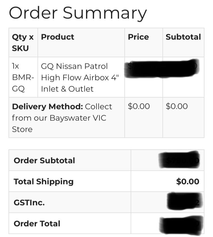

    Australian Made Found Too, Awesome Advice Thanks Legends ....SOLD
    It stung a fair bit price wise but should hopefully properly protect the old faithful TD42-t underwater soon and longer term engine bay future proof for whatever may come

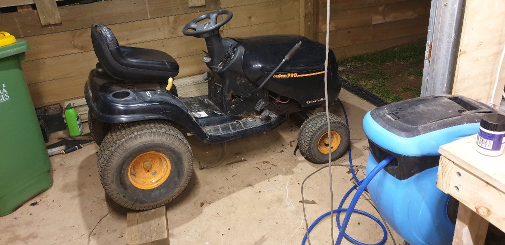

    For the time being any other vehicle for me is my patrol while mine sits woefully in the back yard.

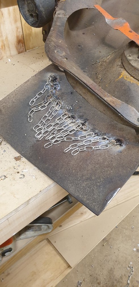

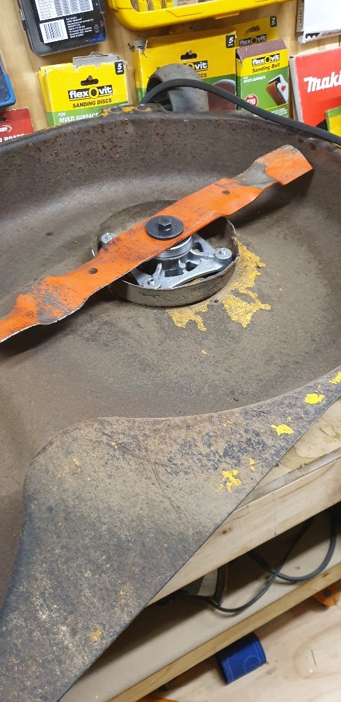

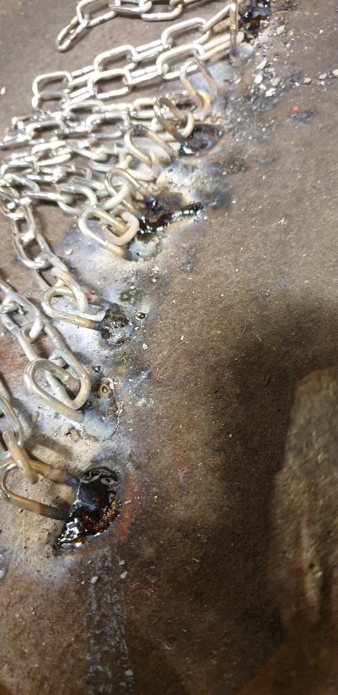

    I spend the evening in the shed, sitting out a broken spindle on my ride on. I sourced replacement spindles from Amazon, with the help of a parts manual, picked up genuine ones for a mere $65. New spindle is now installed and I've even tacked some chain onto the deck chute to slow down rocks as the OEM deflector was broken well before I bought it, and replaced with some 3mm plate.
    For a novice welder with just a basic aldi stick inverter welder I'm happy with the end result. The last chains attached went on much easier than the first ones.

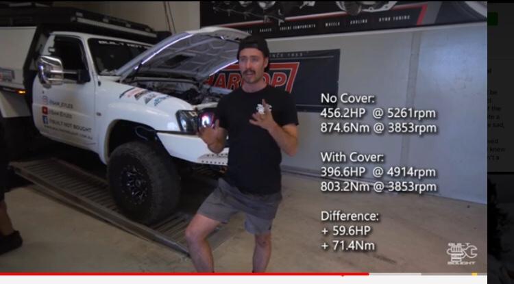

    Accidentally found this Youtubey one (magically popped up :-) of some dyno run tests of Sam Eyles with his 6.0L SC Petrol Chev Weapon:
    https://youtu.be/sPDp47xUmt8
    Minutes 5:00 < > 7:00 show the difference he found on his airbox design humbly admitting too he needs further design upgrading for the beasts CFM needs.
    Must honestly say, I am so disappointed that I nuffy entrusted (assumed) the removed 6.5L NA Chev supplied Donaldson (220-ish CFM) now kindly learnt wasn’t even ever spec’d correctly for its non turbo 350 ish CFM needs

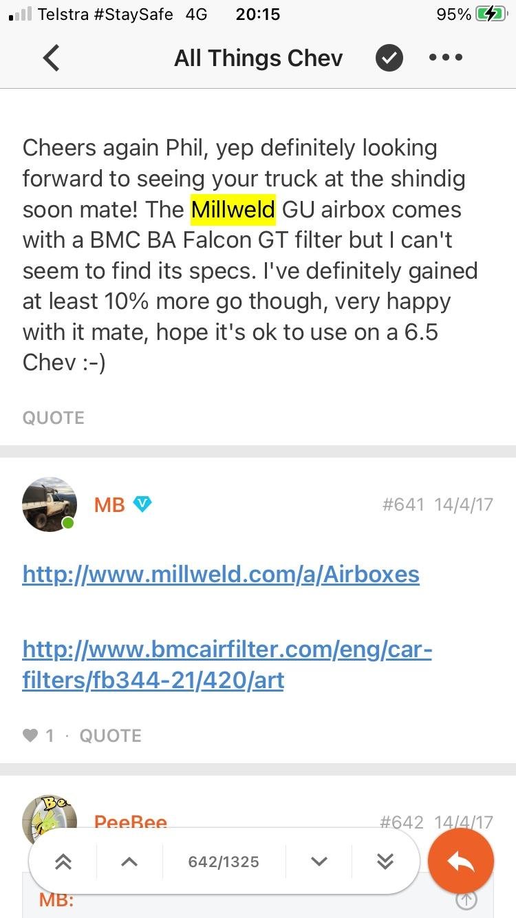

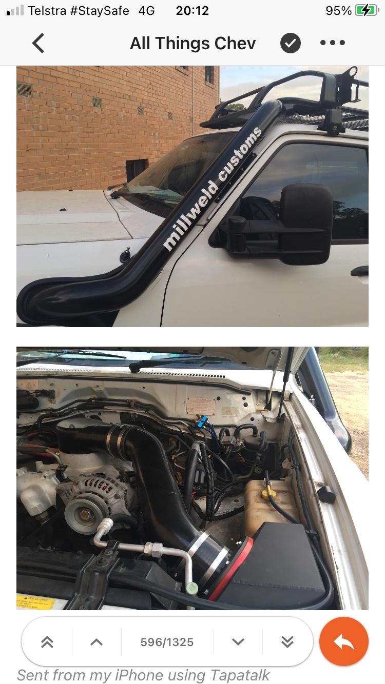

    Just done myself a massive thread dig as I remembered posting/documenting something about the removal of the Donaldson from the original 6.5 GU setup purchase 5 or 6 years ago now:
    A V8 petrol system airbox design for Patrols appeared to increase new ‘felt’ power by 10% and I’m positive I posted somewhere out there 10% better fuel economy too, just can’t find my old dribble for that post
