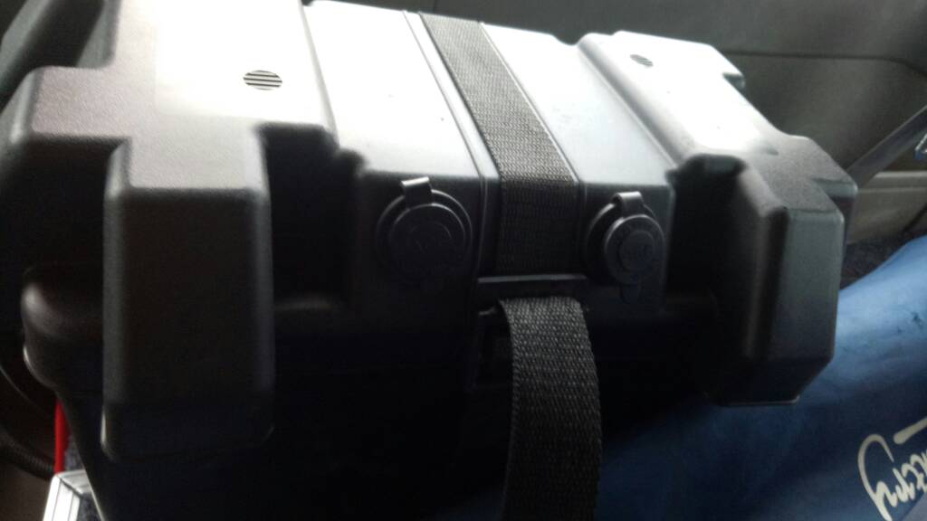

    When I say off the aux battery with a cig plug. This is what I mean.
    Once it's all working properly I'll be using the 6mm2 wire with a twist and lock merit or an Anderson.
