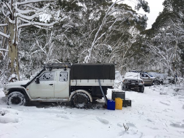

    Zero snow on the whole tray canopy warmish area maybe?
    For sure, incredible. I am not so concerned about the lift pump right now, and have looked at the options for heat tracing the lines but not that easy as they duck and weave along the chassis, plus change materials from steel to rubber. I think if the tank is warm, the rear filter is warm, front filter warm, then the fuel should flow. What's interesting is the other guys didn't have any problems and didn't do much more than the Powerplus product from what I understand, so that's a bit baffling. Anyway I reckon my setup will suffice, and unless I get the chance soon, will have wait until next year to find out.
