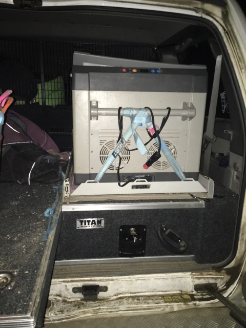

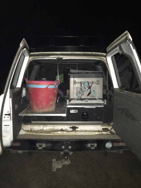

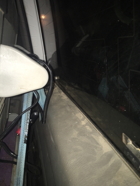

    FWIW, paid a bit more than blokes above back then for earlier Titan drawer deals to our budget needed. They've unexpectedly held up extremely well. 80L Waeco F/F just fits on the drivers side with its Waeco slimline slide and we use the Titan slide as a bench/table. . Careful of positioning bigger fridges in our trucks, their handles can miss windows by only cm's so may I please suggest temporary wood/tek type screw tests first before final bolt down:-) Overall weight of these drawers is an issue at 80kg+ I believe so touring with them and a family of four will be a no go for us unfortunately!

    Can't remember if I put the ARB 60 litre fridge in for a test after putting the drawers in or not , getting rid of all the rear seats helped me to counter the weight .
    That fridge in your pic has the same cheap arse connection that came with the ARB fridge and the evakool , the ARB one was getting that hot at the plug it shite itself in Broome , bought the heavier engel knock off that ARB fridges have now .
    The Evakool I have converted to Anderson plug and wish I had of done the same to the ARB .
